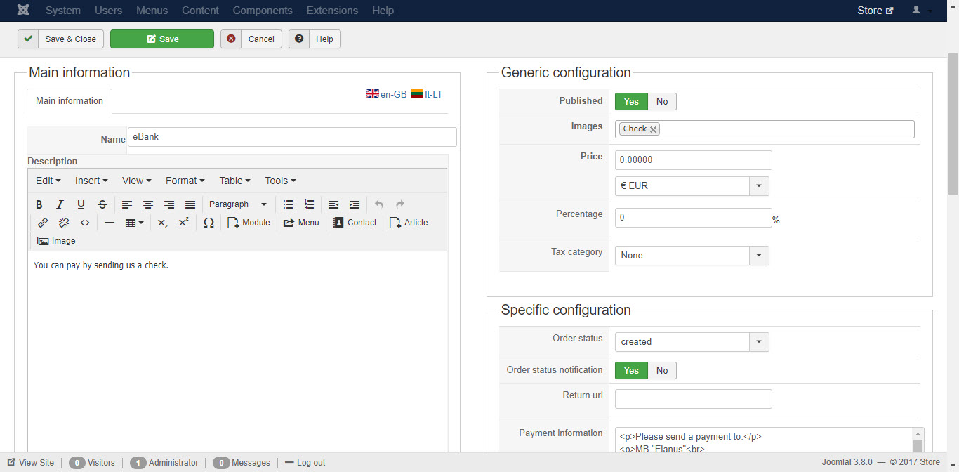

I have "HikaShop check payment plugin" setup from my orders, right after somebody buys the product status gets to created and the stock does not get deducted. The when the check is received I go and set it to "Confirmed" via admin -> orders. The stock does not get deducted, please advise?
I tried updating Hikashop but it did not solve the issue I have restored the old version so some styles won't break on the live site.

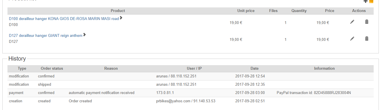

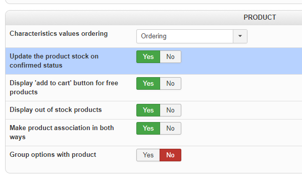

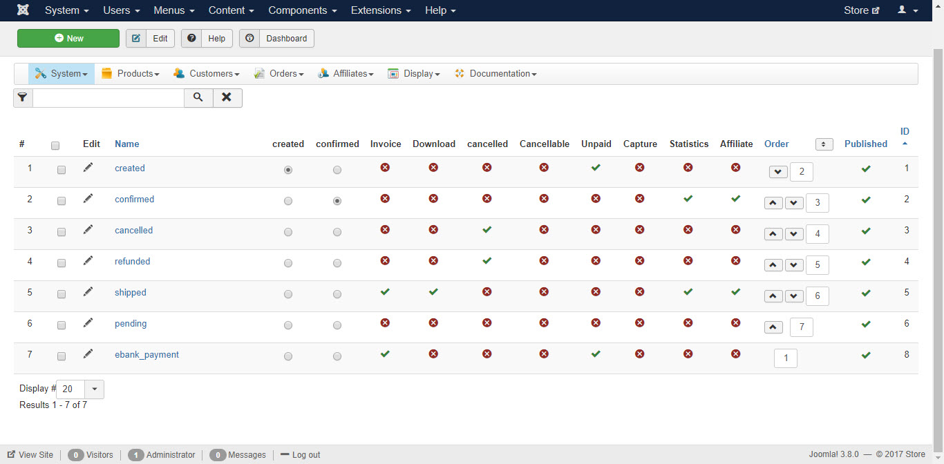

Please provide the version number you're using and a screenshot of the settings in the menu System>Order Statuses and a screenshot of the order settings in the HikaShop configuration.

We are using version 3.1.1 on J 3.8

8 years 10 months ago #279656
I'm not following you.
The way you setup the order statuses, the stock should update when the order payment notification is received from PayPal and the status of the order goes from created to confirmed.
If you later change the status to shipped and then to confirmed again, the stock won't be updated again. It's only doing it when you change the status from created to confirmed.

The stock does not get effected on Check orders. Customer places the order (it gets to created status), then I receive a check and change the order status to Confirmed. The stock does not change automatically.

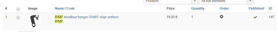

So could you provide a screenshot of the details of an order paid by check on your website for which you had the issue ?
Could you also provide a screenshot of the settings of the product in the order ?

8 years 10 months ago #279979
My bad, I told you to look at the wrong column. It's the "invoice" column on which the system bases itself for stock updates.
So I've enabled "confirmed" in that setting on your website backend and it's working fine now.
