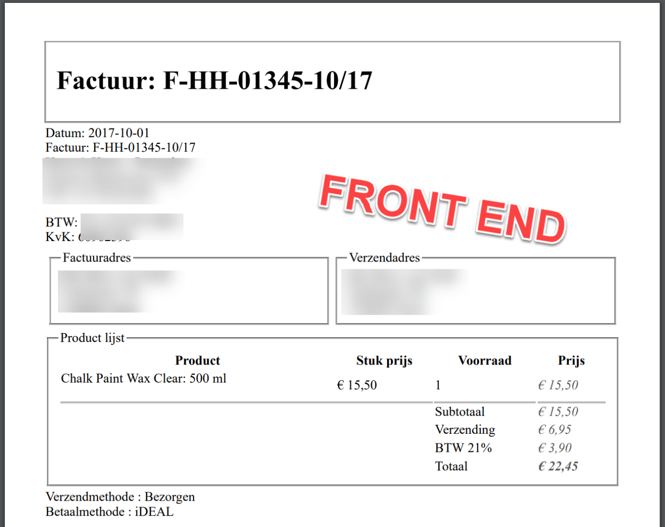

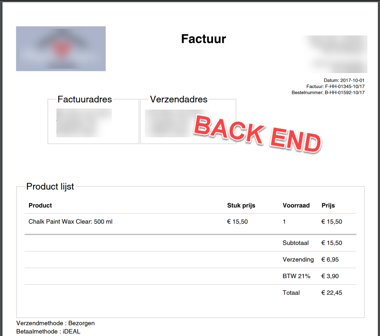

Is there a view to customize the invoice at the front-end?
Because I made some changes on the invoice view but they are only visible at the back-end.

See difference in frontend and backend invoice.

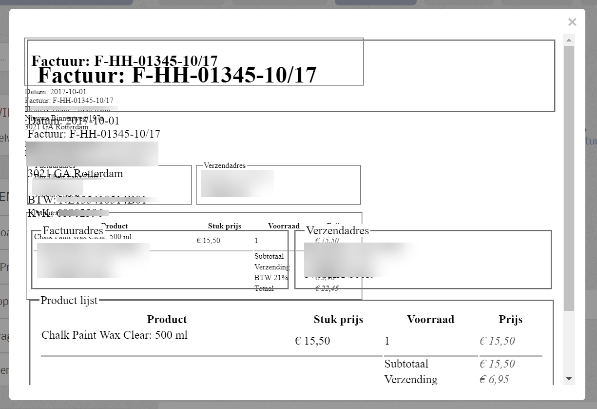

There is a second question. When I close the print window I see this view.
It's totally mixed up with some other content. Is this a issue or has it something to do with my configuration?

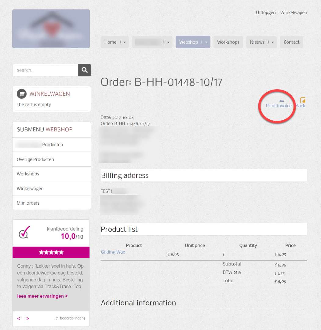

Sorry that I wasn't clear enough. But I'm talking about the invoice at the front end not the Show "file" of the "order".
See screenshot. After you clicked on that button you see an invoice.
But that invoice is different from the invoice at the back-end. And I don't know where to customize this frontend invoice.

You'll still need to edit the "Show" file of the "Order" view of your front-end template via "Hikashop->Display->Views", the only difference is that the "$this->invoice_type" PHP variable is set to "invoice" instead of "order" when using the "Print invoice" button.
