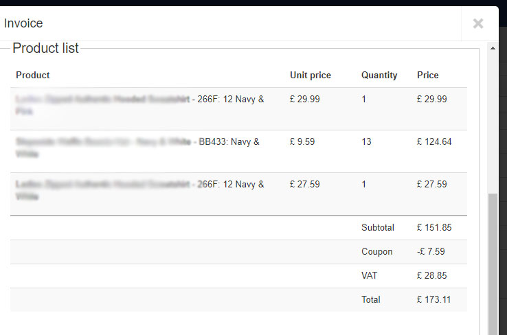

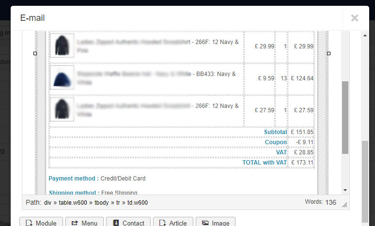

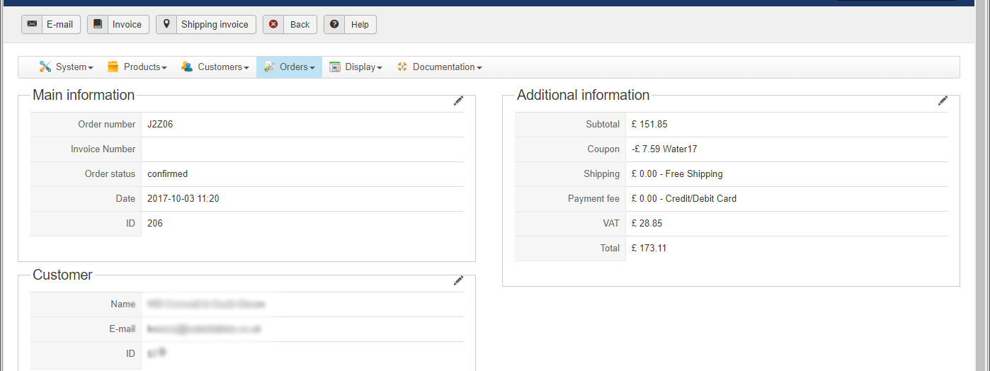

I have tried adjusting the first line in the if statement but can't get the data to display the coupon value before tax. Below are some screen shots from the back end to show the issue.
The first 2 images are displaying the correct amounts for all the areas.
As can be seen in the email area the coupon value is incorrect.

OK... I have found where the bug is in the coding!
Line 256 should read:
$t = $currencyHelper->format(($data->cart->order_discount_price - @$data->order_discount_tax) * -1, $data->order->order_currency_id);
This means when I change line 254 to below I get the correct result that I am looking for in the email which is the "order discount" - "discount tax"
$t = $currencyHelper->format(($data->cart->order_discount_price - @$data->cart->order_discount_tax) * -1, $data->order->order_currency_id);
