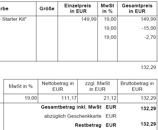

for the German tax office it is important that the net and the gross amount is indicated in the invoice.
How to change the php code in the invoice.php for I get both amounts, that it looks like in the example: beispiel rg?
I also attached the code from my invoice.php

  • Posts: 35
8 years 9 months ago #284233
I don't know if you understood my quest but what you write is not the answer to my question.
If I set to "no" in the configuration, the articles shows prices without VAT. but this is not correct. The prices must be prices inclusive VAT.
But the invoice must show both invoice amounts, with VAT and without . this is obligatory for german tax office. Please see the attached files, I send. It should be like this example.
I know where to get the invoice.php but my question was how to customize the php code that the invoice shows both amounts, inclusive 19% VAT and without VAT.

  • Posts: 35
8 years 9 months ago #284325
at the moment the invoice looks like in the example file: beispiel rg skandibutik.pdf
but it should be like in file: beispiel rg skandibutik soll.pdf
This message has attachments files.

8 years 9 months ago #284330
What this modification does, is that it displays the sub total without VAT instead of with VAT. So you get three rows:
the subtotal without VAT
the taxes
the total amount with VAT
If you want something like that:
the subtotal with VAT
the coupon
the total without VAT
the taxes
the total with VAT
then it will require adding some custom code for "the total without VAT" row as this row doesn't exist.
