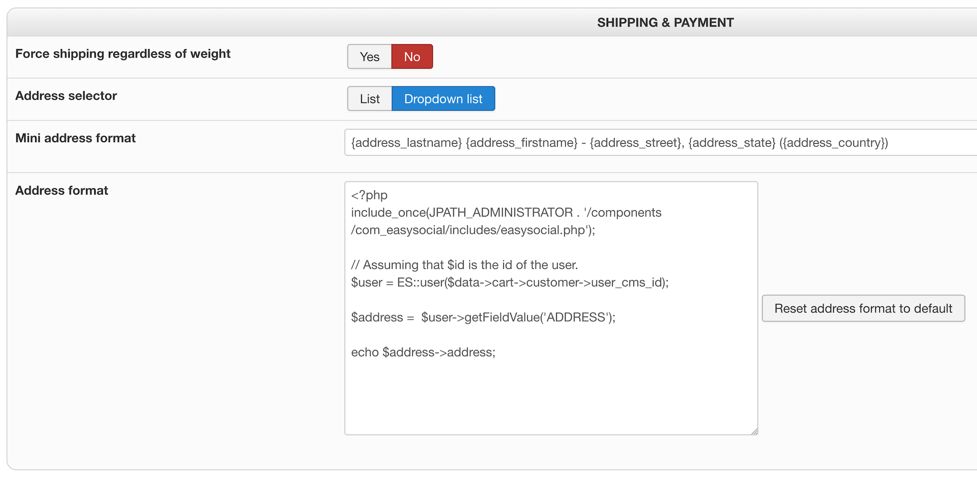

It is also possible to add custom PHP code and get the address data with such PHP:
When I go to this place in my Joomla back end I see the following:
Mini address format:
{address_lastname} {address_firstname} - {address_street}, {address_state} ({address_country})
Address format:
{address_company}
{address_title} {address_firstname} {address_lastname}
{address_street}
{address_post_code} {address_city} {address_state}
{address_country}
<?php echo JText::sprintf('TELEPHONE_IN_ADDRESS','{address_telephone}');?>

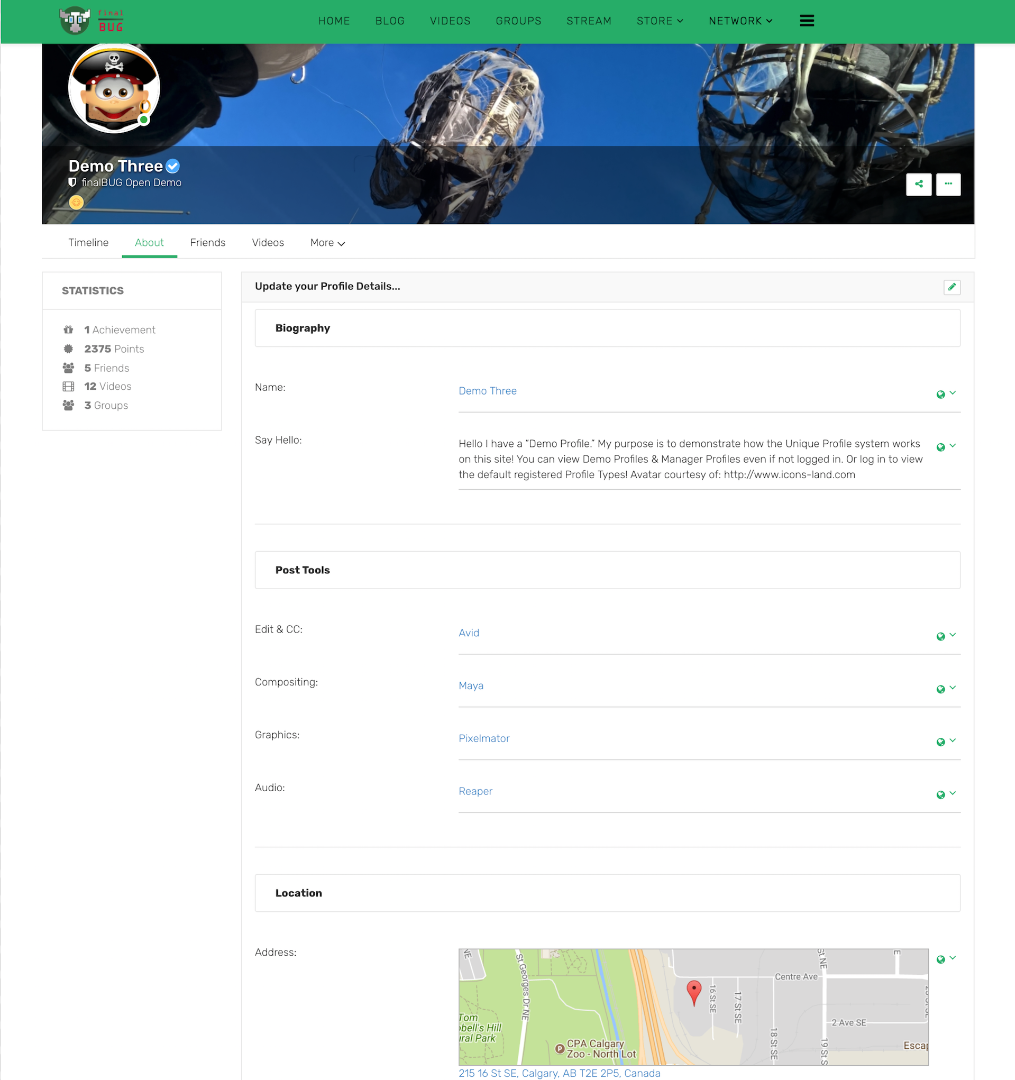

Mark Lee from Stackideas kindly told me that I can pull an address from their component with the following:
<?php
include_once(JPATH_ADMINISTRATOR . '/components/com_easysocial/includes/easysocial.php');
// Assuming that $id is the id of the user.
$user = ES::user($id);
$address =  $user->getFieldValue('ADDRESS');
echo $address->address;
Is it possible to get this to work = Hika Shop pulls the dress from Stackideas?

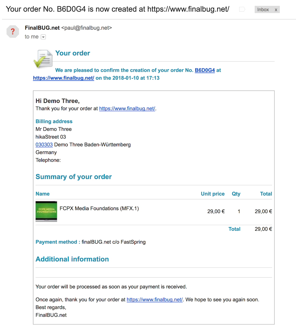

8 years 7 months ago #285609
Supposing that you remove the capability for the customers to edit/create/delete/select addresses on the checkout, you could add such code in the emails/invoice/order details views and replace $id by the id of the customer in the order.
It will be in either $data->cart->customer->user_cms_id, or $this->order->customer->user_cms_id etc based on where you do the change.
But for HikaShop to be able to pull the data of the address of EasySocial in HikaShop so that the addresses of EasySocial can be selected/modified/deleted, etc in HikaShop will require some heavy development for a synchronization system.
However, if you don't know coding at all, even the easy solution won't be possible. I would recommend to ask for help from a PHP developer to help you with that.

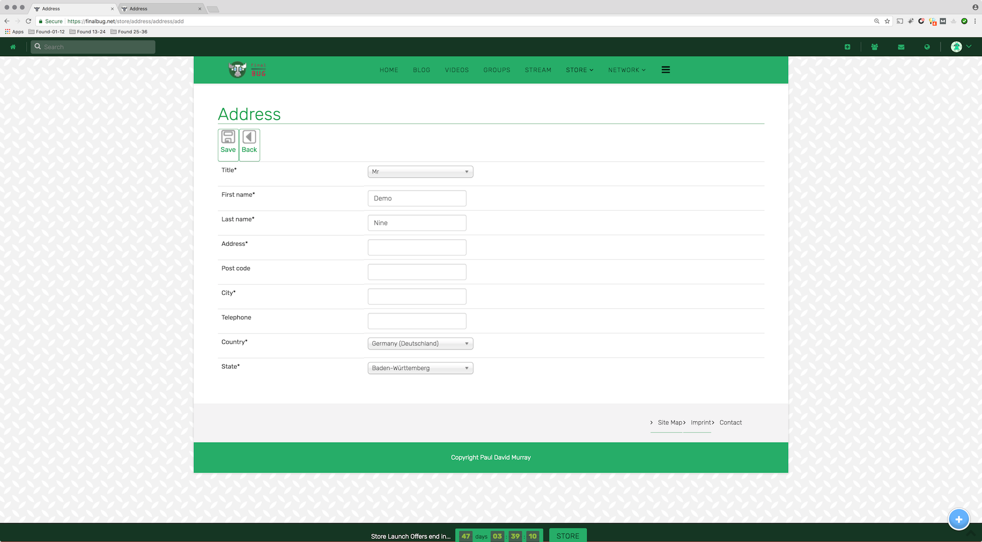

You can empty the "address format" yet.
Then, you want to edit the "show_block_address" or "address" files of the "checkout" view and add such code at the top:
<?php
$user = JFactory::getUser();
$user = ES::user($user->id);
return;
That way, on the checkout you'll have the address from easysocial displayed.
And you won't have any address on the other views that the customer can access. Then, as I said, you can add that code, changing the $id variable in the emails, etc.
If you're savvy, you might be able to do it without a developer, but a developer will be able to do that easily for you so it should be quite cheap.
Last edit: 8 years 7 months ago by Jerome. Reason: [code] tag

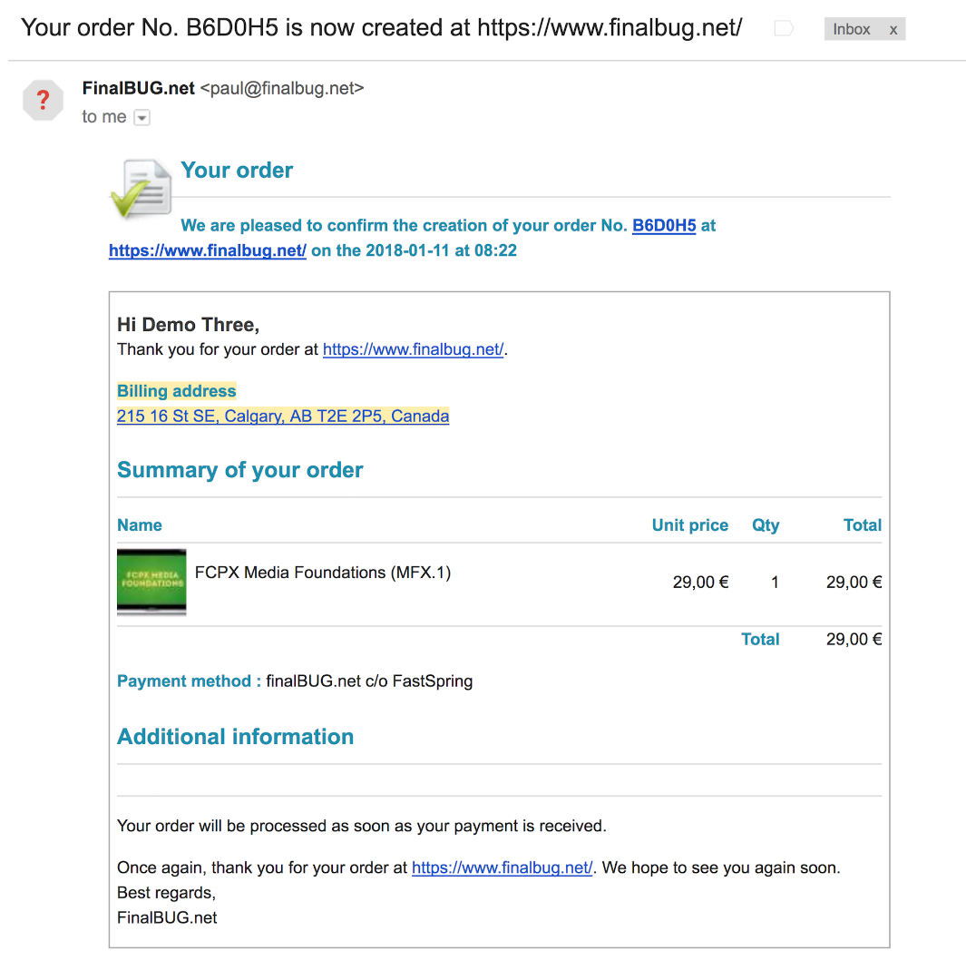

8 years 7 months ago #285723
Ok Stackideas take support to the next levlel again. :woohoo:
Inserting this here takes care of the address being pulled from Easy Social:
<?php
$user = ES::user($data->cart->customer->user_cms_id);
echo $address->value->address;
And inserting this in the same place:
$hikaredirect = JFactory::getApplication();
$hikaredirect->redirect(FRoute::profile(), false);
Takes care of the address thing.
So for example clicking:
www.finalbug.net/store/address
When logged in as exampleone
takes me here:
www.finalbug.net/exampleone
And
clicking:
When logged in as exampletwo
takes me here:
www.finalbug.net/exampletwo
etc
I just thought that i would share this.
Maybe it is useful for some one else.
best
Paul
Last edit: 8 years 7 months ago by paurray.

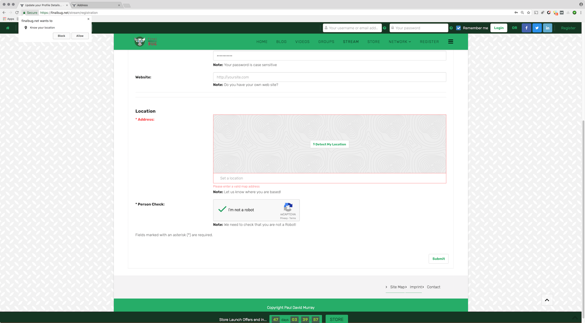

  • Posts: 139
  • Thank you received: 10
8 years 7 months ago #285800
Ok the last piece of code the redirect code causes more problems than it is worth.
a) Empty Hika Shop Addresses do not get redirected to Easy Social Profiles.
b) Pressing "Finish" in the cart process takes me to my Easy Social Profile.
If any one has any tips I am all ears.
If not I will talk with a developer at some point in the future.
best
Paul

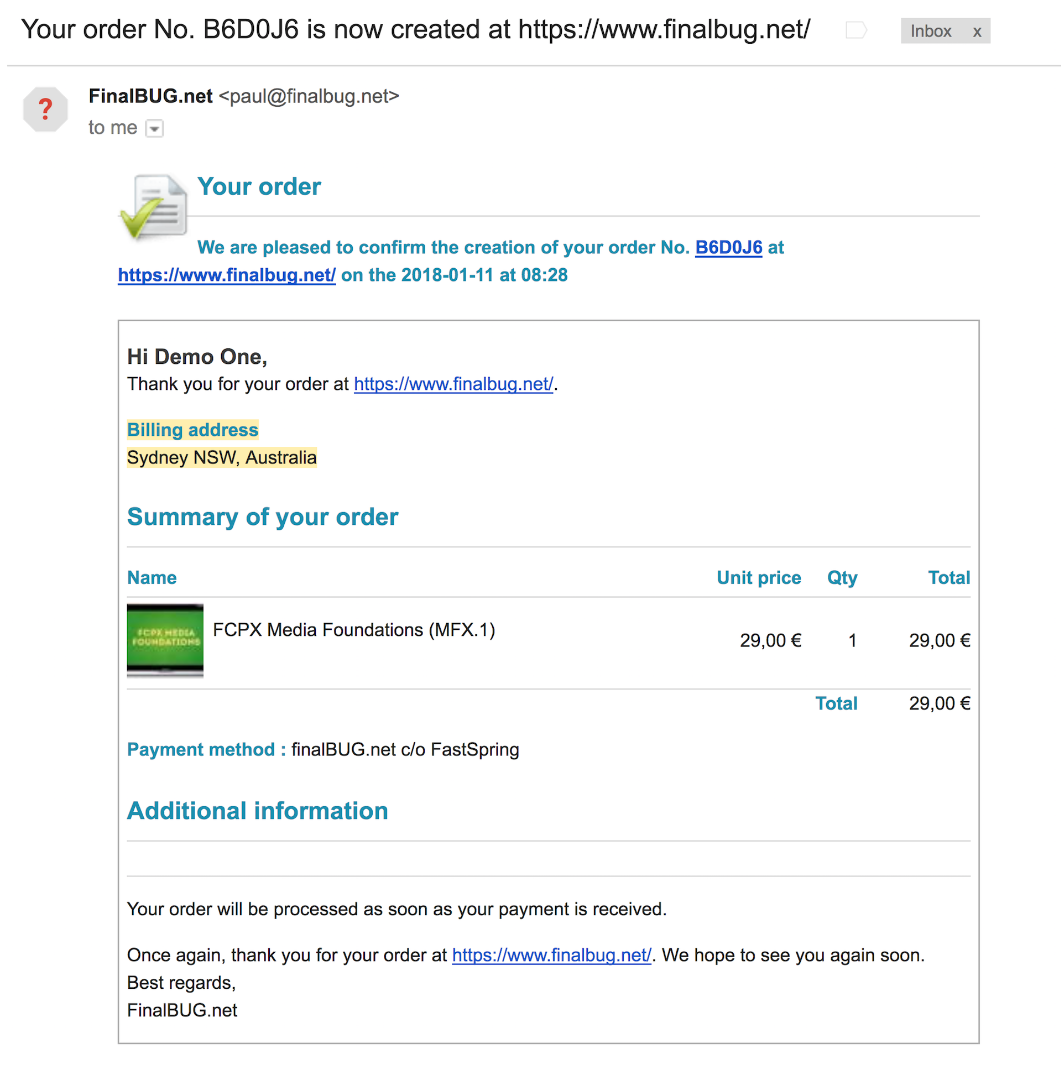

  • Posts: 86077
  • Thank you received: 14186
8 years 7 months ago #285806
You should try something like that:
if(empty($address->value->address)){
That way, it won't redirect if there is an address but will redirect if there is none.

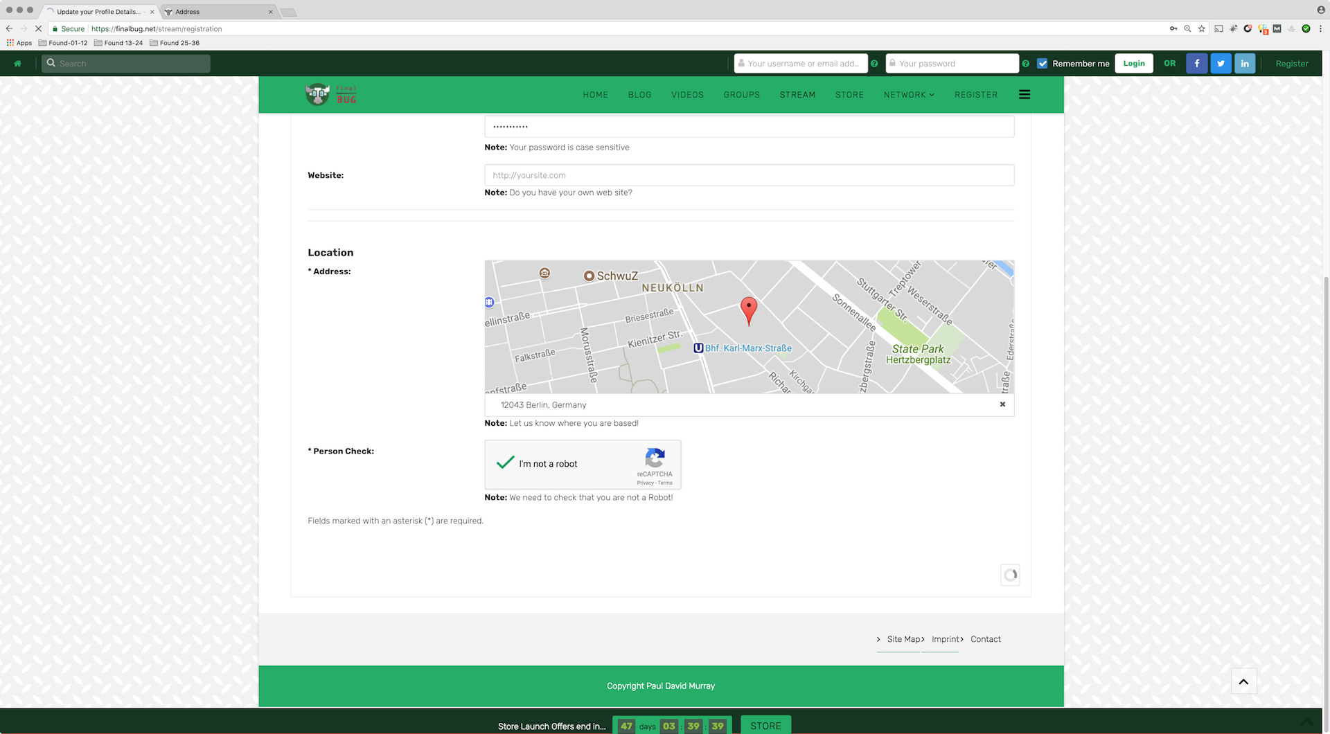

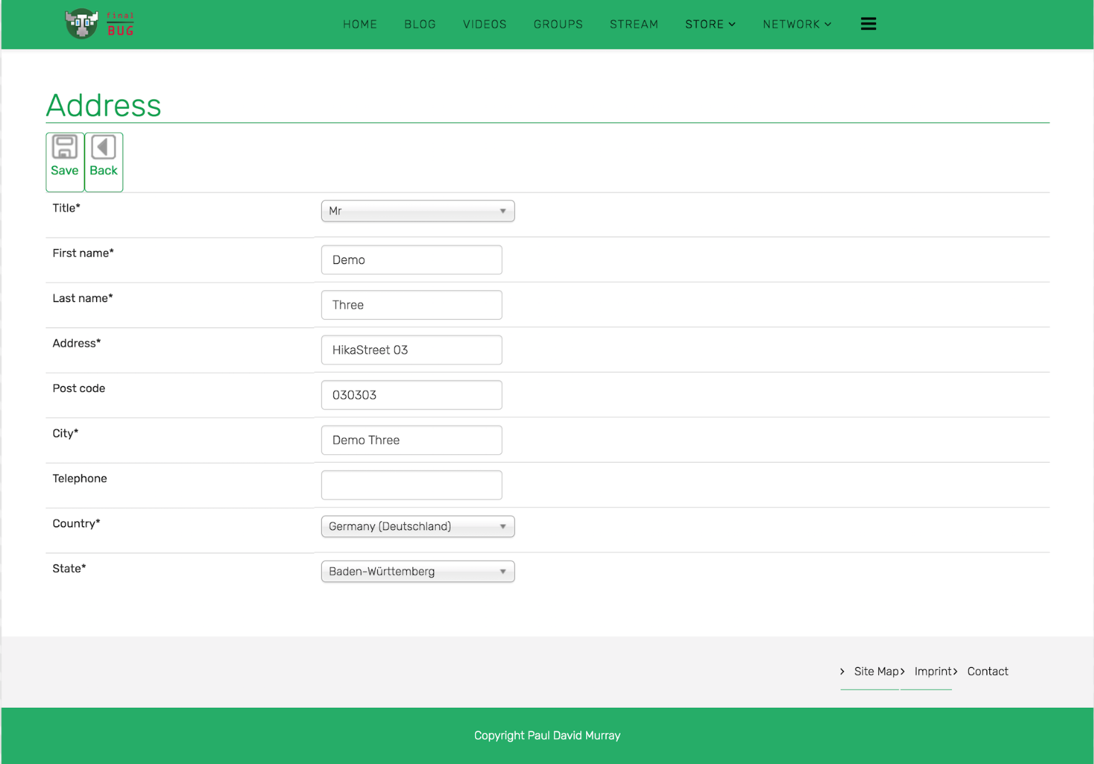

The thing is that every user created on the site has:
Country*Germany
State*Baden-Württemberg
I just double checked this with a brand new user account.
Is this normal?
My guess is that I set this somewhere at some point but have no idea!?!

  • Posts: 139
8 years 7 months ago #285851
Can not help wondering if maybe it is a happy coincidence that their is an address in there in HikaShop!?!
Maybe if the code could the redirect when there is an address:
Country*Germany
And does not mess up the “Finish” part in the shop`
  • Posts: 86077
8 years 7 months ago #285847
The default country/state on the registration form of HikaShop are the ones that you configured in the corresponding custom fields in the menu Display>Custom fields.
You can have them more dynamic if you configure the HikaShop geolocation plugin. That way, the country will be the country of the IP of the user.
