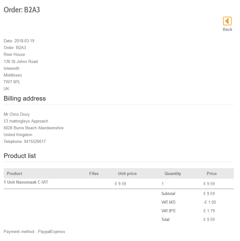

Hi Hikashop, we are using the invoicing the clients to process orders.. hopefully larger orders. If you use the Orders and New button the build the invoice and send it to the client they get an invoice that takes them back to the website to login but there is no where there is for the Client to just PAY...
Can this process be constructed to enable the client be able to pay directly when issue with an invoice.?

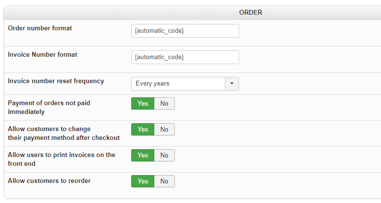

Please check the setting of your HikaShop configuration options
1."Payment of orders not paid immediately"
2. "Allow users to print invoices on the front end"
If both are set to "yes", clients will be able to
1. see a "Pay now" button in their order listing and, on click, get to the chosen payment page
2. once the order is paid (= status "confirmed"), print their invoice from the detailed order view

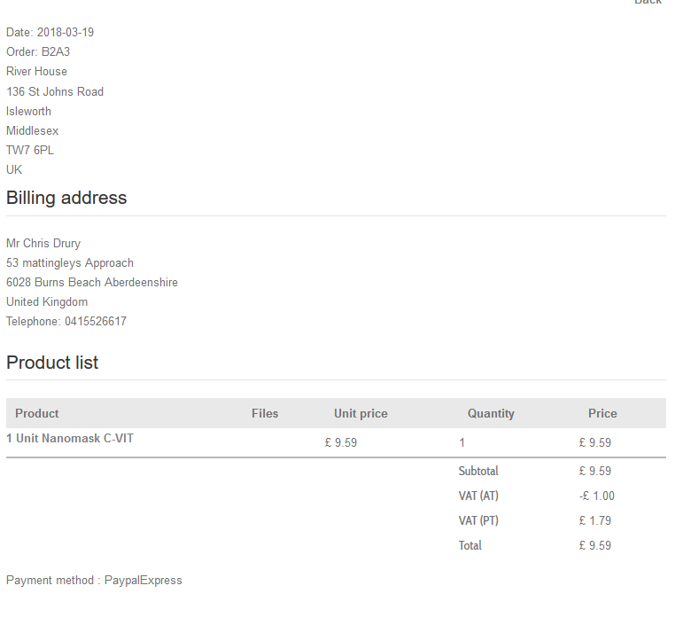

HI, Ive set the Order settings as suggested. However, when the client logs in .. they still cant pay the invoice sent out.? what are we doing wrong.? This is critical to the way we need to run the shop... IDEAS please....

Your latest screenshots are (twice) the order detail page.
But what does the order listing (= the page before the detail page) in the frontend (= what the client sees) look like? There should be the mentioned "Pay now" button...

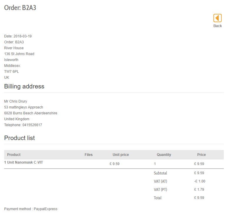

Hi, The client sees, this. There is a Payment method.. but they cant click on it and pay... this is what we need ideally.

That's not the order listing, but It's the order detail page you keep posting. There will never be a "Pay now" button.
1. Create a new order. If you do so as customer in the frontend, finish it (so the order is getting created) but do not pay it yet.
2. As customer, logged in to the frontend, go to HikaShop's account cPanel.
3. Click on the "Orders" field.
4. The page you're seeing now is the order listing, and that's where you (the customer) should see the "Pay now" button.

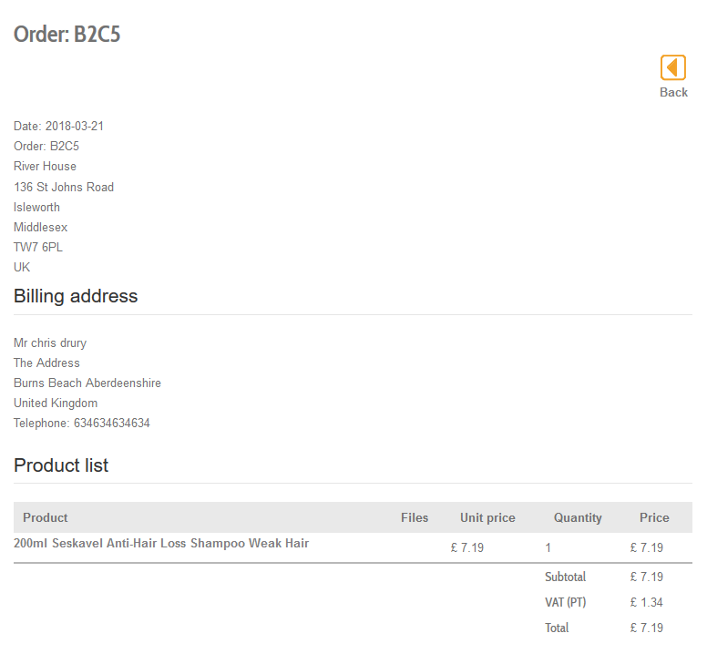

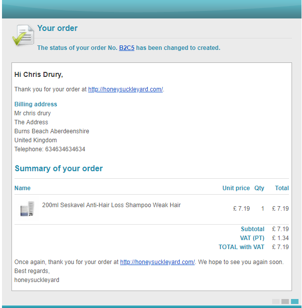

Hi have obviously misunderstood myself and continue to get it wrong. The orders generated from the back end of the shop come out to the client but there is no PAY HERE button visible. Is this something that can be arranged.

Now you're showing here an email and yet another order detail page for a "created" = unpaid order...
As said many times before, nowhere there can you expect the "Pay now" button.
It'll show only on the order listing page. How about a screenshot of that?
