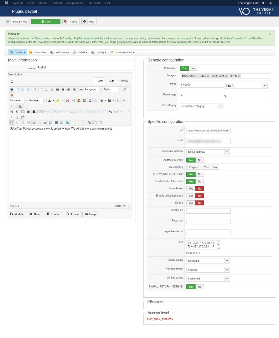

It could be because of the way the PayPal payment plugin is configured.
For example, if the "verified status" setting is set to "cancelled" there.
Could you provide a screenshot of its settings ?
Also, you can activate the debug setting of the PayPal payment plugin, do a test again, and look at the "payment notification log" in the HikaShop configuration. That will give debug data to understand what is the problem.

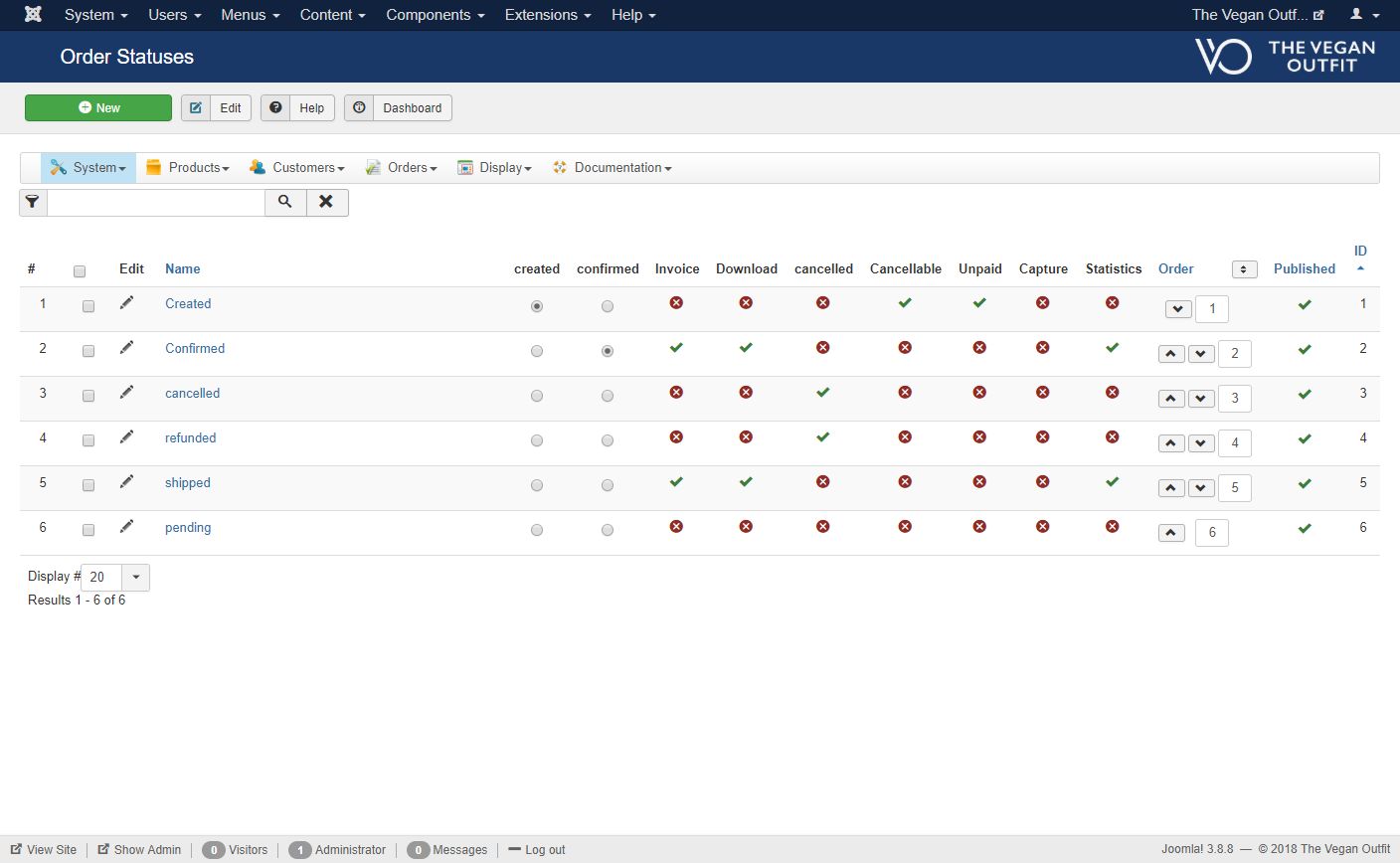

however In attachment I posted 2 screenshots, one for the paypal conf an another for the order status configuration.

Maybe the issue is with the IP addresses which aren't up to date. Try to empty the field and see if that helps.
Also, turning off the "send order details" as explained in the message of your screenshot might help too.
Both could lead to the order being cancelled.
Finally, you should also receive a payment notification email after the payment and it should contain information as to why the order was not confirmed. Could you check your emails ? If you don't get that email, please check the "payment notification email address" setting of the HikaShop configuration and make sure it contains your email address.
