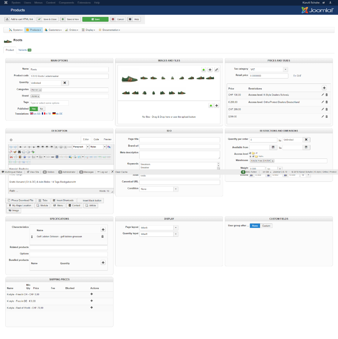

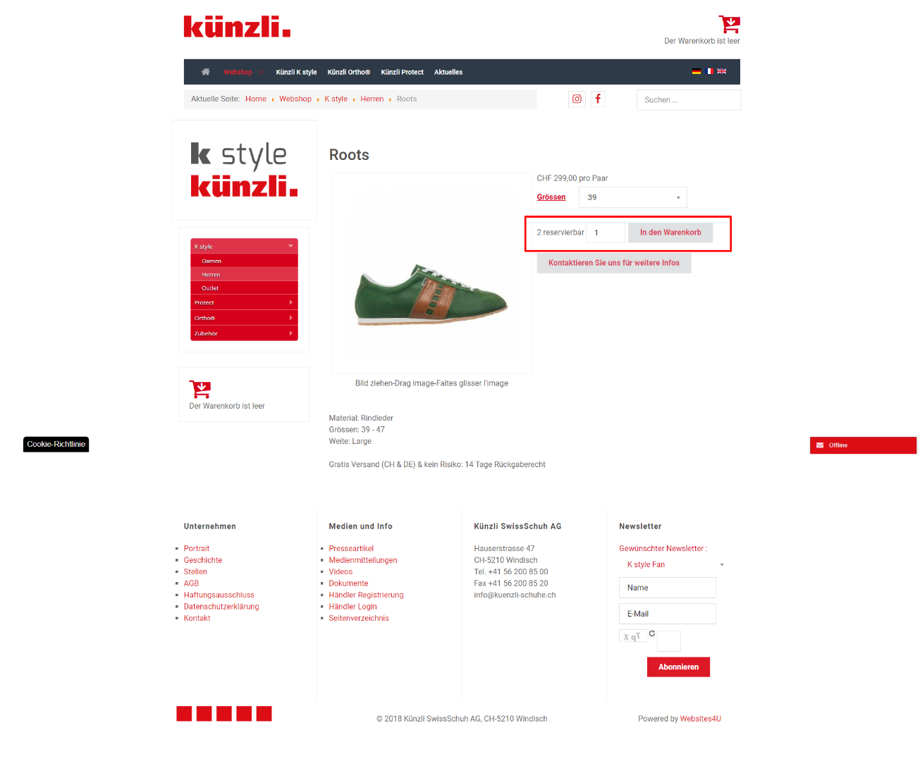

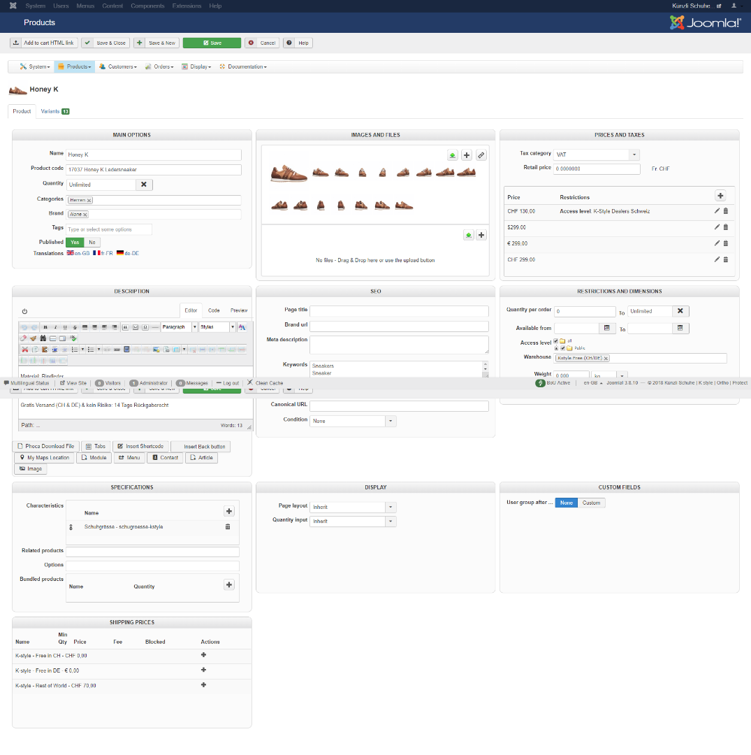

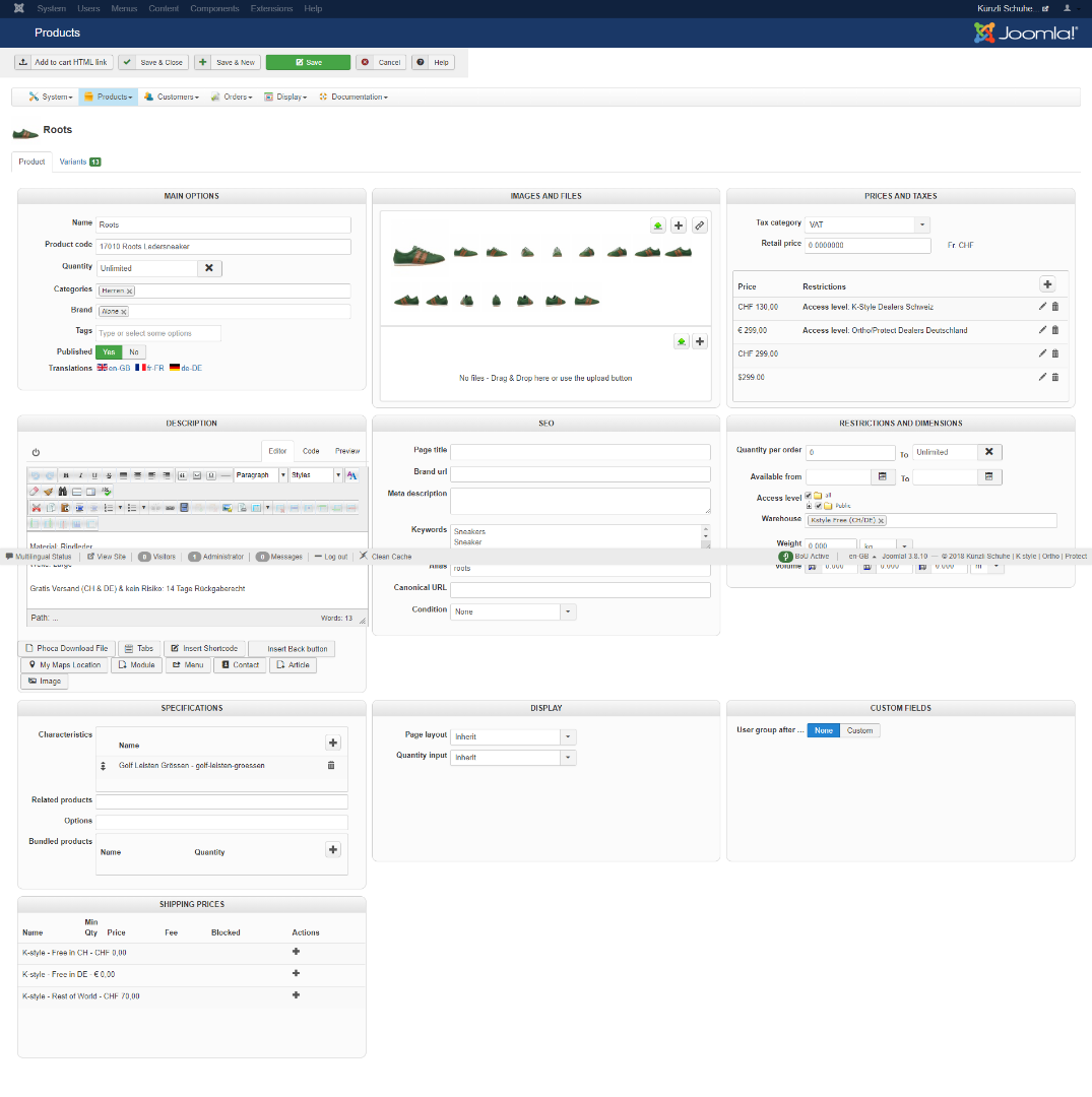

Some products display a "RESERVED" instead of "IN STOCK"
See the attached images.
I can't work out why this is so. Apparently when someone adds a reserved item it should generate an email to tell someone that a customer wants this item, but nothing happens.

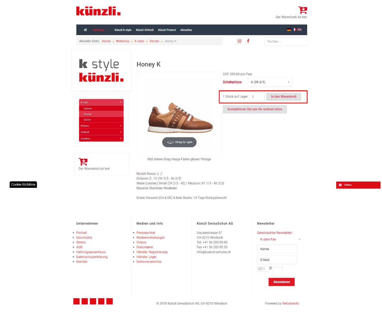

I've checked the language file and the string I found is : X_ITEMS_IN_STOCK="%s reservierbar"
I've changed that to X_ITEM_IN_STOCK="%s Stück auf Lager"
However, where does the original "Stück auf Lager" come from in the other items? I looked for this string which was already present (see the attachment in my previous message) and couldn't find it anywhere. Other than the main language file, where else can I look to find that string?
My issue is this: there were two different messages being generated by the two example products, apparently by the same string! That can't be the possible. So where is that message coming from?

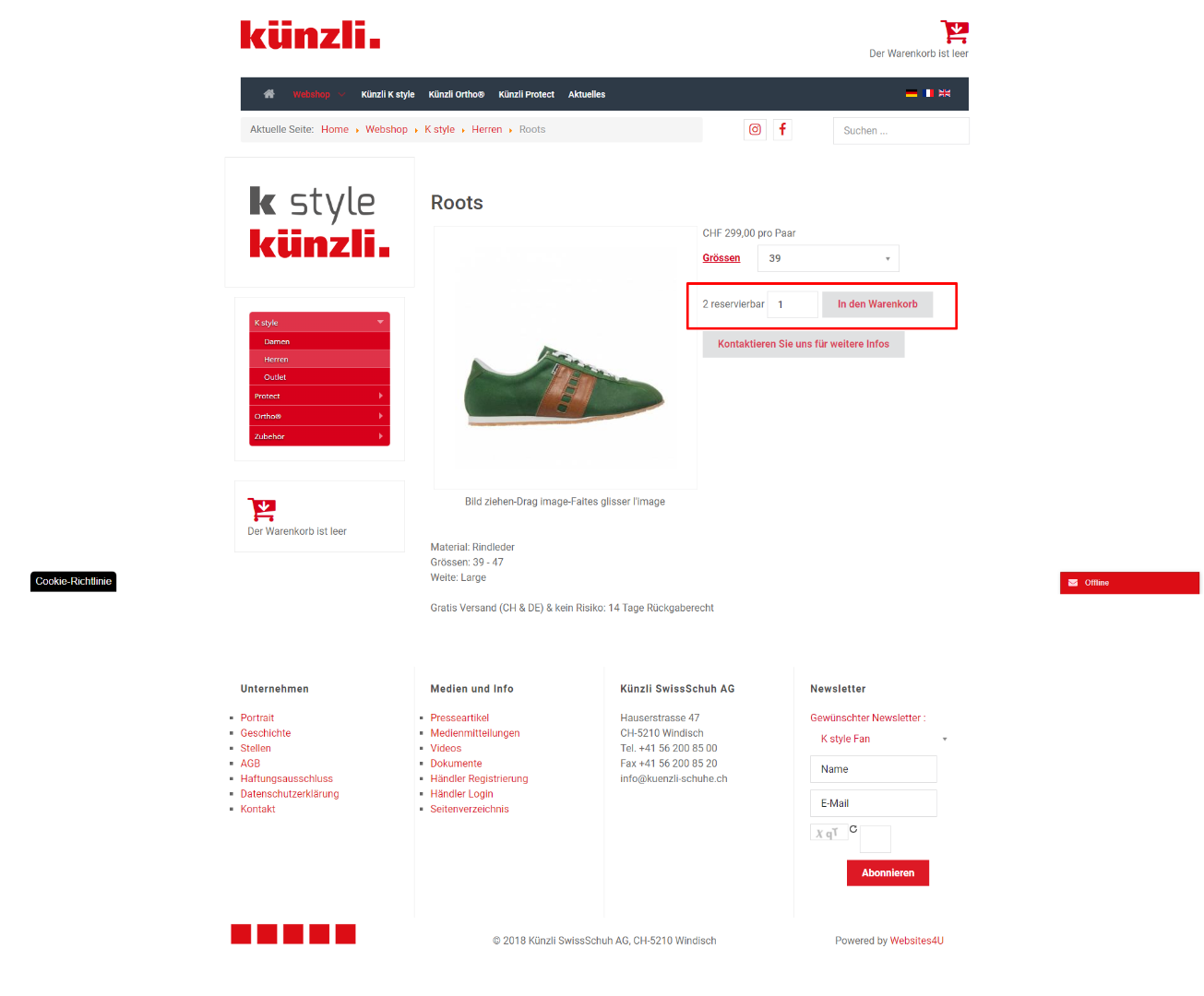

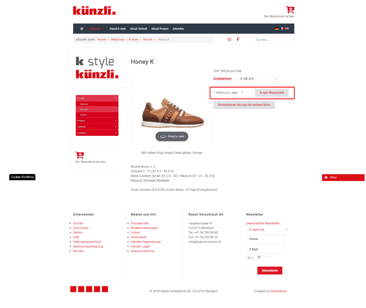

Sure:
Wrong term only in German, found in de-DE.com_hikashop.ini
kuenzli-schuhe.ch/de/shop-de/kstyleshop/.../category_pathway-17
No term at all
Correct term, not found in de-DE.com_hikashop.ini

Your issue is coming from the fact that their is 2 translation key that are used :
- "X_ITEM_IN_STOCK" when only one item is in stock
- "X_ITEMS_IN_STOCK" when more than one item are in sock
You should use both of them.
