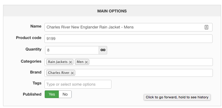

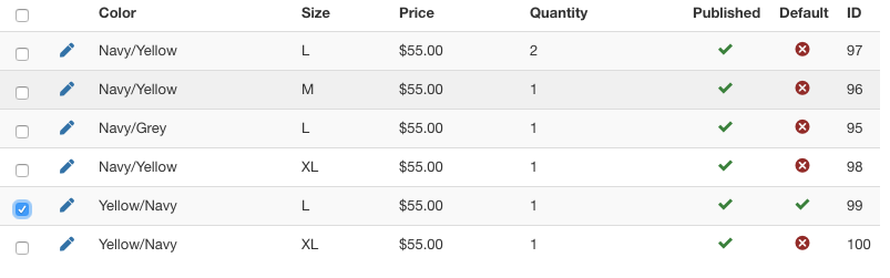

  • Posts: 109
7 years 6 months ago #303745
We are running Hikashop v 4.0.2 and Joomla v3.9.2
I just tested it this morning and the problem still exists. For the product I tested, we have a total of 8 products across all the variants. When I purchase one (1) the quantity across the variants changes (to 7) but the total quantity for the main product does not change and remains 8.
  • Posts: 86077
  • Thank you received: 14186
7 years 6 months ago #303747
I don't see how that's possible. Please provide a backend access, a FTP access, precise instructions to reproduce the problem and a link to this thread via our contact form so that we can have a look as this works just fine on my end:
