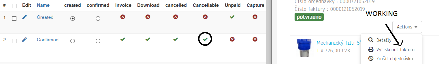

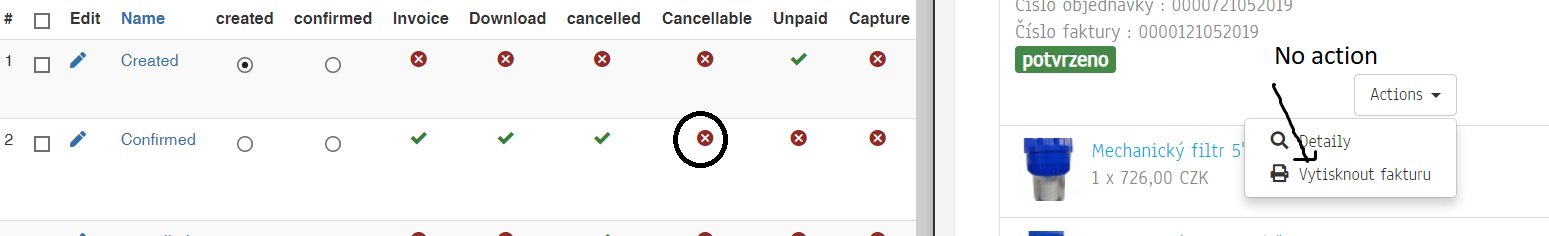

today I bought Hika Shop essential and I found a problem. In the customer area when placing an order and confirming it, the button Print Invoice does not react at all (image 1). However by chance I tried to change the configuration in Order statuses to Cancellable (image 2, showing the cancel order button at front end) and suddenly the pop-up window appears. However I don't want to have to Cancellable order status at all, therefore I am asking, whether somebody knew, where is the problem?

There are 2 orders now, one created and second confirmed. It is impossible to click on the print invoice button. However, if even in the created status I click on cancellable, then it works everything fine, so for now the solution is to have a cancellable created order.

The "print invoice" button in the "actions" dropdown of orders might not work in some cases because of a side effect of the move from the "allow users to print their invoice" option of the configuration to the "print invoice" column of the System>Order statuses menu.
And you wouldn't see the problem if you updated HikaShop with that old setting activated. That's why I couldn't reproduce the problem.
I've added a patch on our end for that problem. Download the install package on our website and install it on yours and it will then work.
