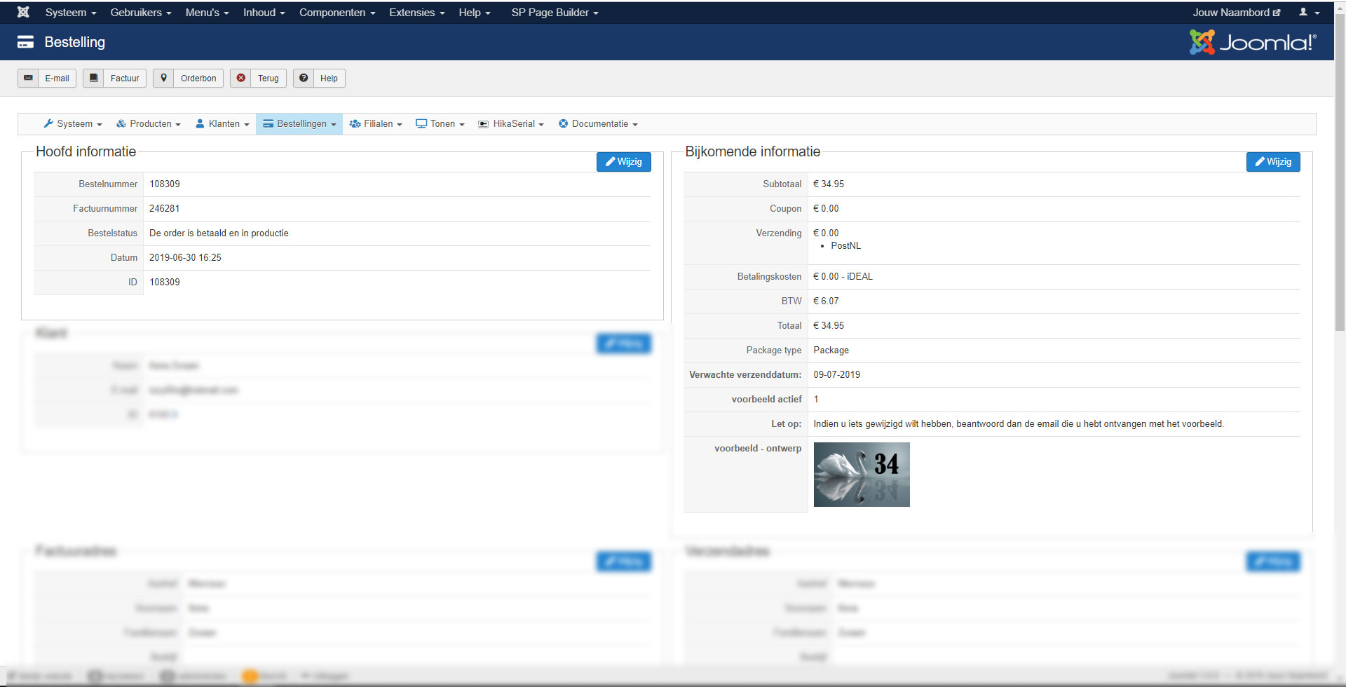

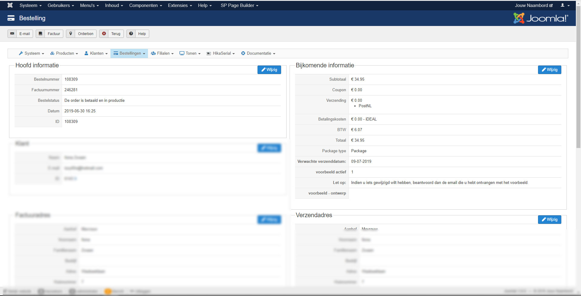

I have a custom image field for a customerdesign in the order list. After editing the order, the image disappears. Looks like a small bug.

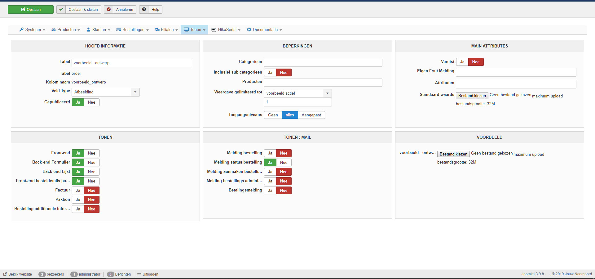

It only happens after editing the tab "Additional information". here's the screenshot of the custom field settings.
