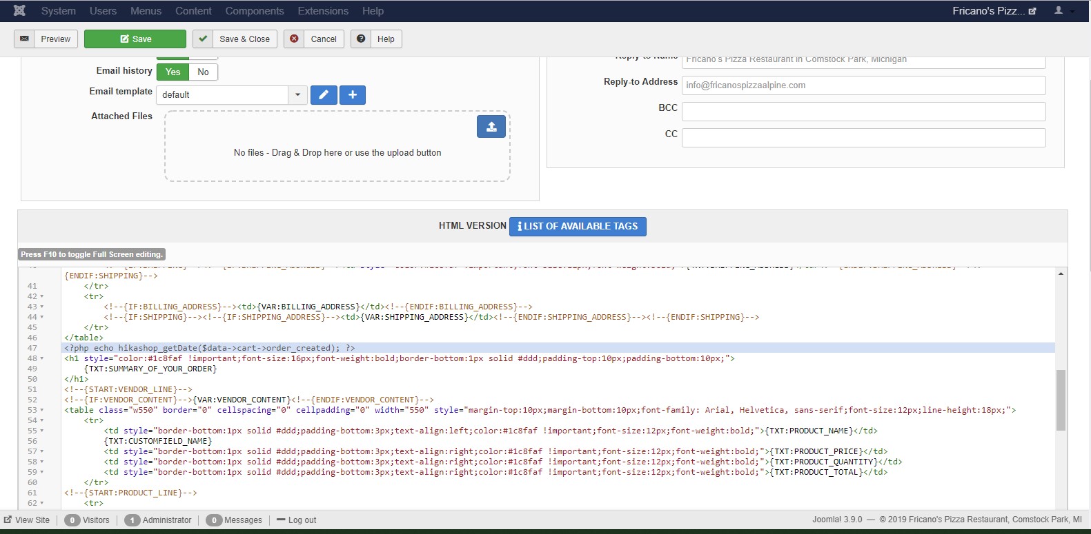

My customer would like to see the date and time of the order within the body of the e-mail.
I tried adding
<?php echo hikashop_getDate($data->cart->order_created); ?>
to both html and txt and previewed but do not see the date.

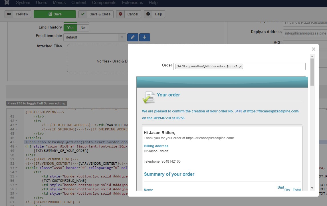

This should indeed display the date of the order in the email. Did you try to check the result with the "preview" button of the email edition interface ?
Could you provide some screenshots of the pages with your modifications and of the result ?
  • Posts: 50
6 years 11 months ago #308471
Yes I did try the preview. See attached screenshots
  • Posts: 85834
  • Thank you received: 14092
6 years 11 months ago #308476
I'm not able to reproduce the problem. Can you confirm that you click on the "save" button of the email before clicking on the "preview" button ?
  • Posts: 50
6 years 11 months ago #308501
Nicolas,
My fault, I thought the preview button worked without having to save it. The code is working fine now. Thanks.
