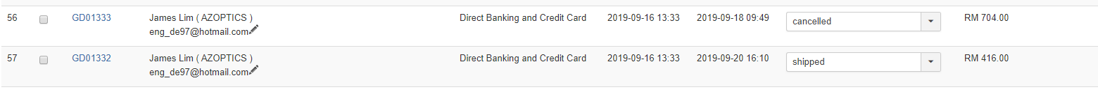

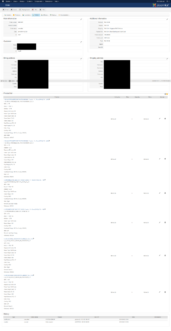

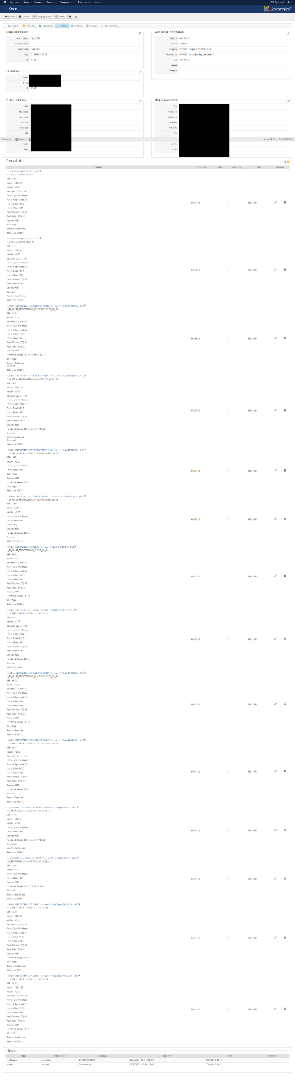

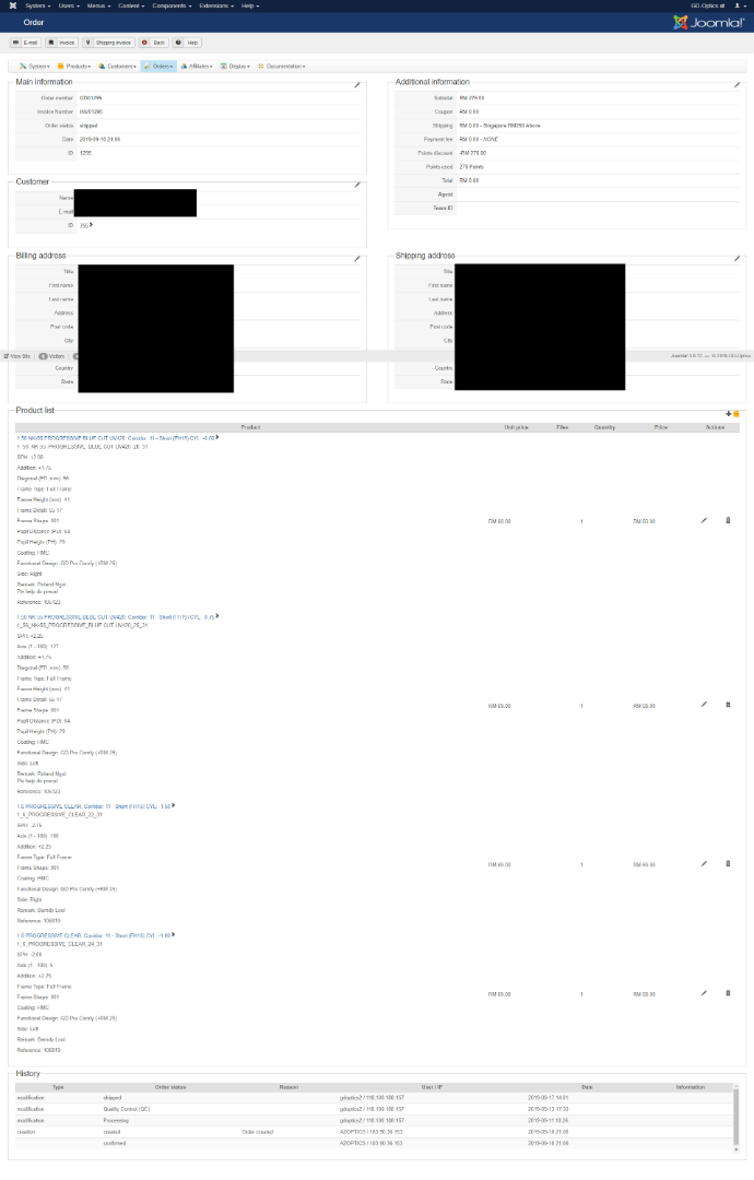

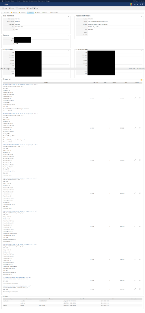

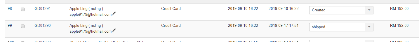

Recently our project started to have duplicate orders. The orders are submitted to hikashop at the same moment. It just starts happened in this September. In the beginning, we thought it was caused by the partial points payment, and we switch it into full payment, the problems still happened. Do you have any idea? some screenshot attached for your reference.

7 years 4 weeks ago #311213 by nicolas
It could be that the customer clicked on "finish" at the end of the checkout, went to the payment gateway, and there clicked on "cancel", went back to the checkout, and clicked on "finish" again before doing the payment.
In that case, you would get a "created" order and a "confirmed" order just after. It could well be in the same minute.
We have of lot of these on our website. For example, we got one today:
monosnap.com/file/r7iCXXP6qDCIDEIELNCnESveLutUae
You can see the customer did a lot of back and forth before changing the payment method and finishing the payment with the last order.
So it's highly possible that it's nothing you can do on your end. Just the customer having trouble with your payment gateway (because of the 3Dsecure, or the PayPal account), or he just wants to confirm or change something.

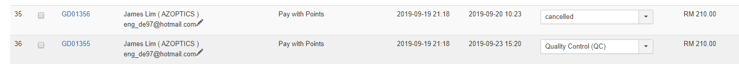

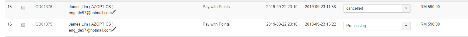

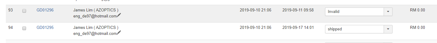

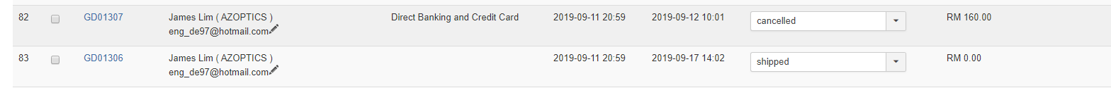

It seems a bit weird since the website already ran for a few months, only this month started to have this issue. And what if the point payment? Since point payment should confirm immediate right? How come point payment also come out duplicate orders? The point was deducted twice... And we check the database, the duplicated order was created right after the first order created. Do you have any idea?
More
7 years 4 weeks ago #311238 by nicolas
Indeed, based on what you've shown in your new screenshots, the difference is only of 1 second. Not enough for a human being to do that and it should indeed no happen with the points payment method since the payment is done immediately.

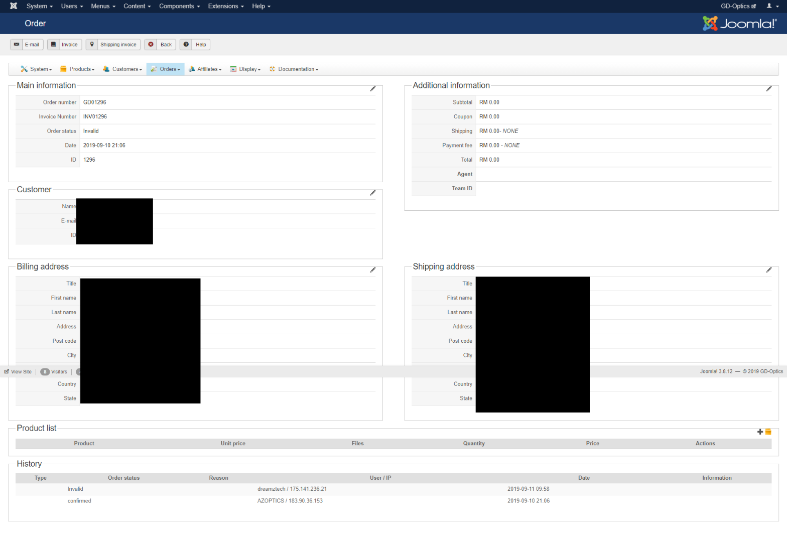

Could you provide a screenshot of the "history" of both "duplicate" orders so that we could have a better understanding of the situation ?
In fact, if you could provide a screenshot of the whole order information (you can hide/remove the address information) that would be great.

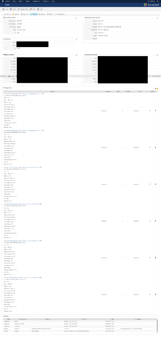

7 years 4 weeks ago #311264 by ler@singmuiheng.com
1. this project does not have HikaMarket installed, it should not be the reason.
2. we do not have any mass action yet in this project.
3. currently only have payment gateway integration in this project.

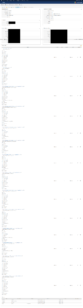

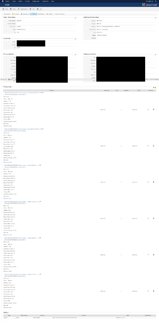

4. we have a custom plugin, installed since last year, to handle the product price in cart and order. Not sure is it related, I have attached the plugins
5. order details are attached for your reference.
More

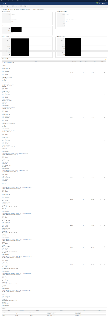

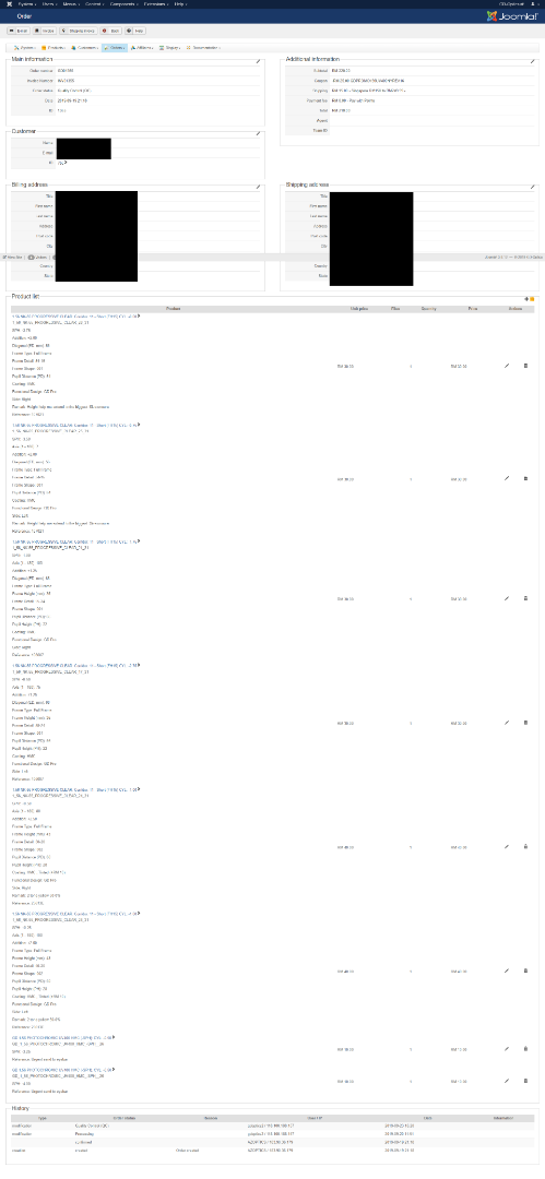

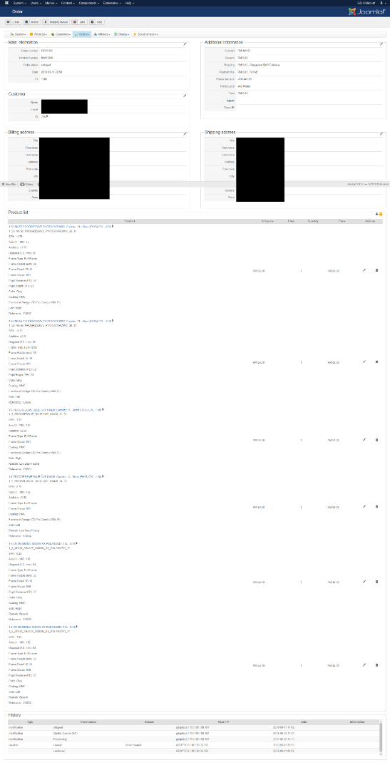

7 years 4 weeks ago #311265 by ler@singmuiheng.com
Some more attachments.

7 years 3 weeks ago #311276 by nicolas
I'm sorry but I can't see anything on your screenshots. It seems that you've reduced their size and it's too blurry to read anything.
Could you please provide them so as we can read what's written in them ?
Otherwise, please provide a backend access so that we can directly check on the situation on your backend. That might be even better. That way we can check other things on your website.
