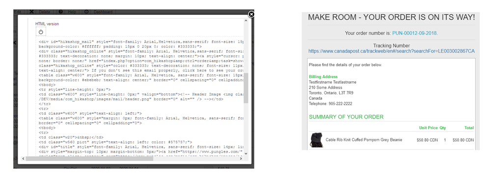

When I change the status of an order I usually see the preview of the email so I can read it now I'm only seeing the HTML code and I'm not sure how to change it back. They are showing correctly in the Systems > Emails but not when I change the status order and preview it there.
Please see attached, I'm seeing the one on the left. Thanks!

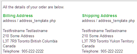

2) Also, in the email under the Billing and Shipping Address it's showing.
address/address_template.php
Please see attached.

1. I would guess that it's because you changed the "Editor" setting under the "Advanced" tab in the HikaShop configuration to not use a HTML editor. So you see directly the HTML of the email.
2. That's because you've activated the "Display view files" setting under the "Advanced" tab in the HikaShop configuration.
