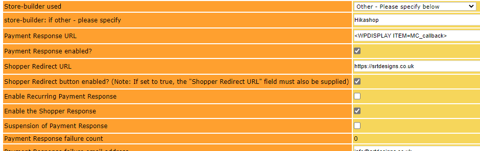

I have two payment plugins, PayPal and WorldPay. The PayPal works fine however, when a payment is made via WorldPay hikashop does not seem to recognise a payment has been made. I would be grateful for any assistance.
6 years 1 month ago #322970
Can you please give us more information about what you mean by :

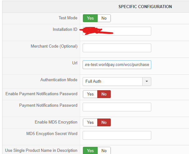

And also show us how you configured your worldpay payment method through some screenshots ? Thank you.

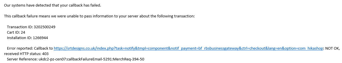

I have attached some information from WorldPay. Can you please advise me if the plugin is sending this information?
Also, what does the Notification Hostname do?

Thank you for your response. I apologise for not replying sooner as I had not seen your reply. I have attached some screenshots to see if that helps you to advise me how to resolve this issue which is stopping me putting my site live. Many thanks.

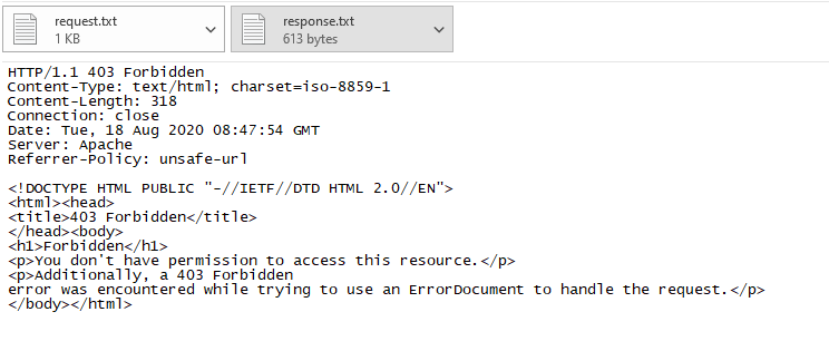

Another had the same issue with that payment method and found a solution, you can check it through that thread :
www.hikashop.com/support/forum/payment-m...-page-403-error.html
I removed the .htaccess file and it worked. I'll look at the reason in more detail!
If you are still having that issue, can you take a look at your server log in order to understand what and why you have a 403 ? Thank you.

The htaccess serves two main purposes on a Joomla website:
- to have SEF URLs without the index.php in the URLs. If you remove / rename the htaccess file while you still have the SEF URL rewrite setting activated in your Joomla configuration, all or most of the SEF URLs on your website won't work anymore.
- to add extra rules to block bots / spammers / hackers. Such rules are not by default in the htaccess provided by Joomla. If you added such security rules, they might be linked with the 403 error
Another potential issue I can see is that your website has some menu items with a restricted access level, and since that plugin doesn't provide the Itemid parameter in the callback URL, your Joomla might select such restricted menu item for the processing of the payment notification, leading to a 403 error as the payment gateway server is not logged in with the correct access level.
To avoid that, try changing the line:
$vars['MC_callback'] = HIKASHOP_LIVE.'index.php?option=com_hikashop&ctrl=checkout&task=notify&notif_payment=' . $method->payment_type . '&tmpl=component&lang='.$this->locale;
to:
$vars['MC_callback'] = HIKASHOP_LIVE.'index.php?option=com_hikashop&ctrl=checkout&task=notify&notif_payment=' . $method->payment_type . '&tmpl=component&lang='.$this->locale . $this->url_itemid;
in the file plugins/hikashoppayment/bf_rbsbusinessgateway/bf_rbsbusinessgateway.php
That will add the Itemid to the callback URL and it might help.
