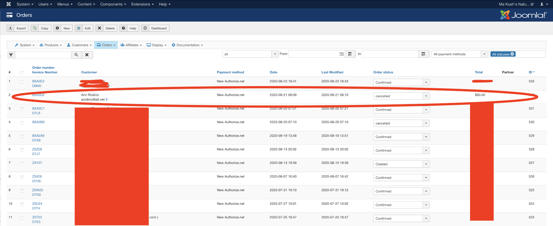

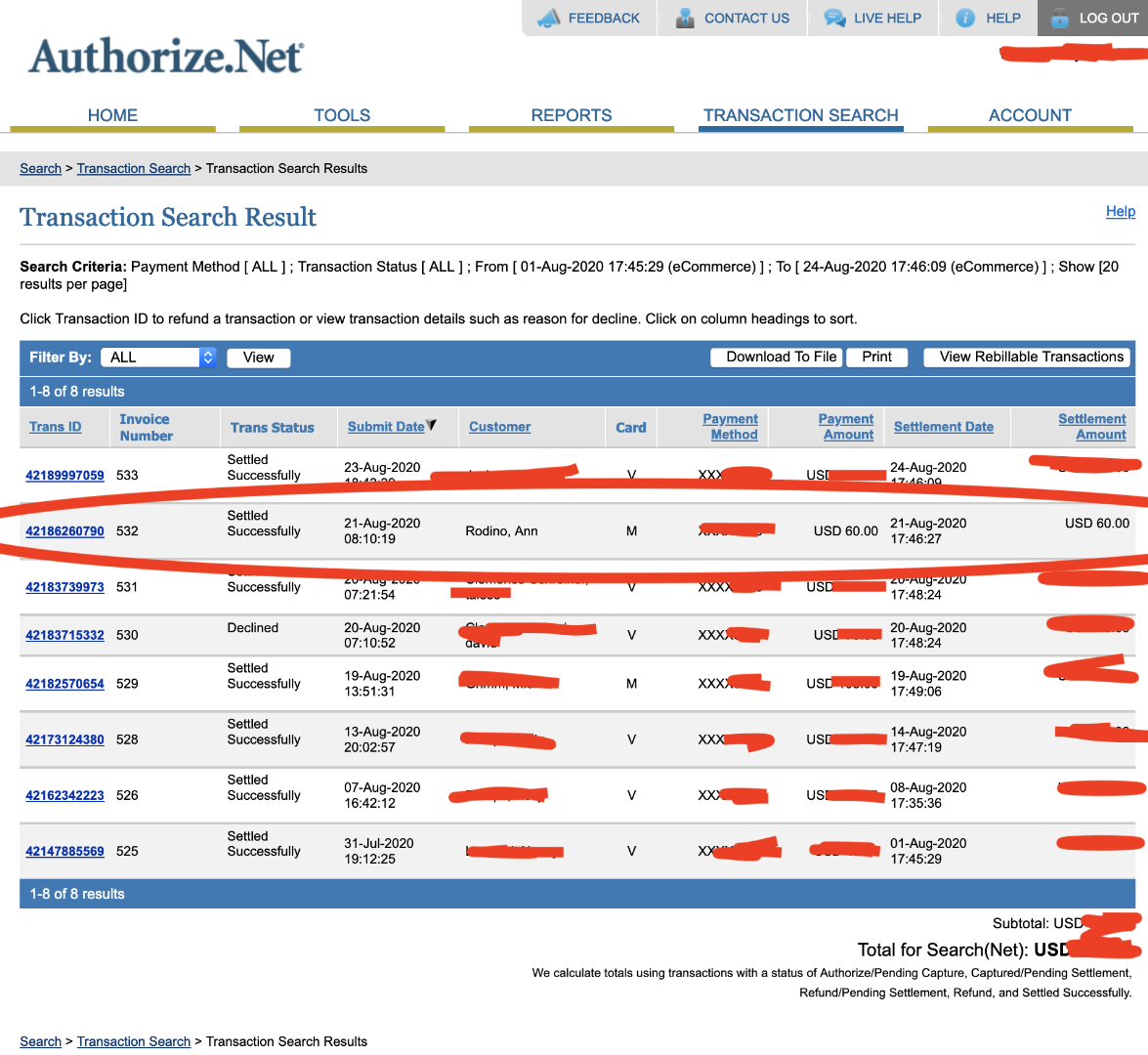

We received a payment notification from our website (HikaShop) that an order was canceled. When we checked our Authorize.net account, the order was NOT canceled and was process successfully. We contacted the customer and her credit card was charged correctly.
Why does HikaShop have the order listed as "canceled"?

You said that when you had the debug activated, you got " the confirmation of payment from HikaShop,". What is that ? The "payment notification" email sent by Hikashop after the order is confirmed ? Or the "order admin notification" email sent by HikaShop when the order is created ?
Was the order status changed to confirmed ?
Are all the other orders getting confirmed properly ? It was only one order that was cancelled ?
In that case, no need for debug, you won't learn anything regarding that issue from the debug with working payments.
Also, you said you got a payment notification email saying that the order was cancelled. What was the email's content ? Could you provide a screenshot ?
Also, do you notice anything different between that order and others that could differentiate it from all the others (supposing that the other orders were properly confirmed) ?
