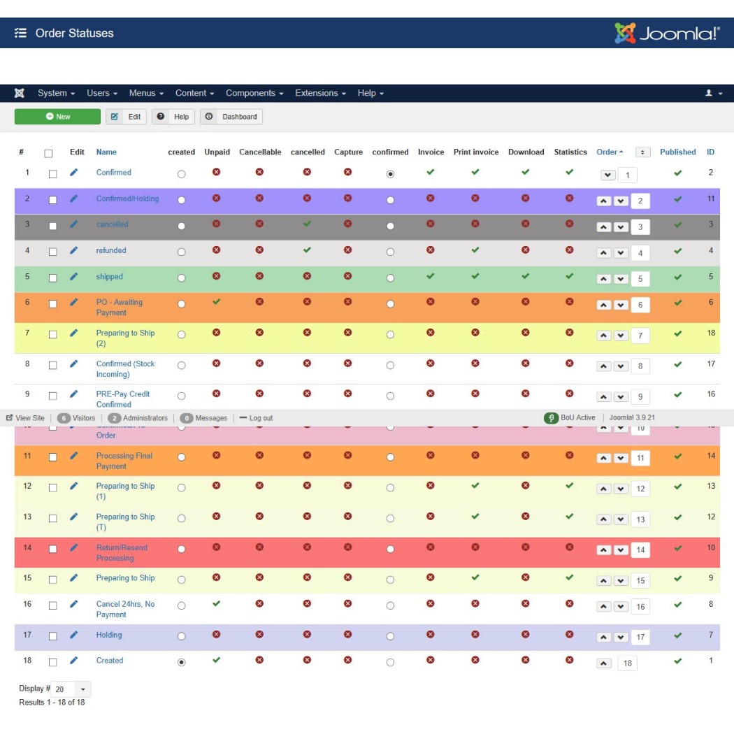

I have a clients site where a customer has made a purchase and used points to make part of the payment. However when checking, the points have not been deducted.
Order status is set to confirmed. After the order was confirmed the client applied a a status of Confirmed/Ready.
If the order status is changed would this add the points back onto the order?

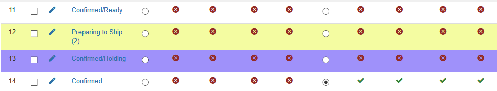

On the order status the confirmed has the radio button confirmed checked. On the confirmed/ready this is not the case, please see the screenshots.

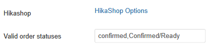

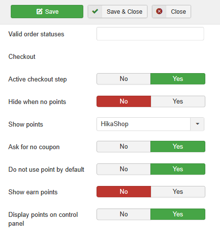

You need to edit the settings of the user points plugin via the Joomla plugins manager:
monosnap.com/file/POBd2HXPSvE4bMFhI1hseh3VudJXw9
There, you'll see a "valid order statuses" setting.
There, you can enter the list of order statuses to take into account to give the points to the customer.
I suppose that this Confirmed/Ready order status is not listed there.

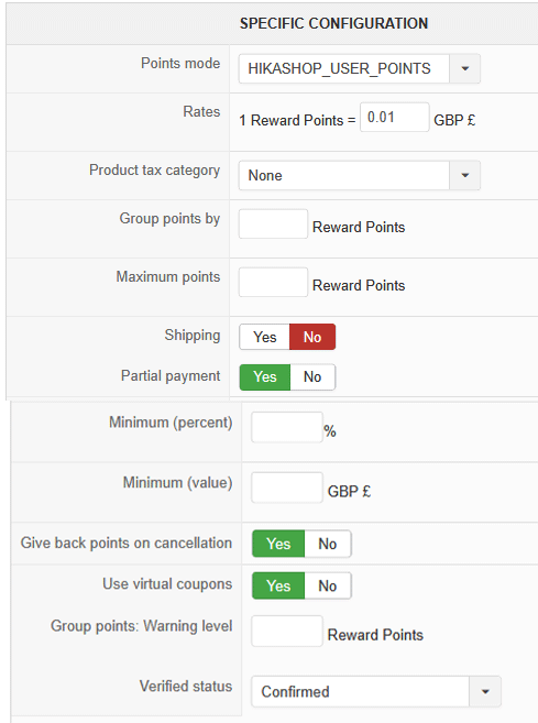

In that case, could I get a screenshot of all the settings of your user points payment method so that I can better a better understanding of the situation ?

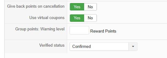

Hi Nicolas
screenshots attached.

I don't see anything out of place on the screenshots.

5 years 11 months ago #323785
We received your backend access and were able to check your settings.
I think that the issue might be related to the "Valid order statuses" setting of the user points plugin (via the joomla plugins manager), which is empty instead of containing "confirmed,shipped".
I've changed it for you and it should hopefully work better.
Please check if that helps.
If not, then we'll need a FTP access and precise instructions to reproduce the problem on your website (with a 100% coupon code and a user account with points for example).

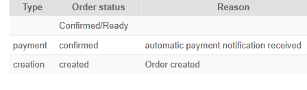

this hasn't worked and there is a very odd behaviour too.
I created an order and then used the points as part of the payment. The points were deducted but on order created (Using the Check payment plugin). I then updated the order to confirmed/ready via the admin and the points were added back on. Finally I updated the order this time to just confirmed and it added 20 points back on not the full 50.
I will now send over FTP & site login details so you can take a look please. This is quite urgent as the site is live.

5 years 11 months ago #324173
We were unable to get the root issue and so we processed a deeper analysis, especially in your back-end configuration and maybe there are think that can leads to your current issue, but can be sure of it, follow me step by step :
1. We don't find this order Status ("Confirmed/Ready") in your order statuses listing.
2. Note that in your Hikashop UserPoints Plugin, and in the "Valid order statuses" field you have to enter the Namekey, not the Name.
3. Can you provide a detailed step by step process on how do you test that your points is added AND deducted, and so we can
reproduce ourselves on your website, and we insiste on the fact that your step by step have to be detailled, to check that the way you want to use
it fit your backend configuration please.
Awaiting news from you to better to get the root issue.
regards

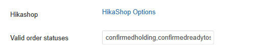

5 years 10 months ago #324215
The "valid order statuses" setting of the plugin must be configured only if you do have special order statuses as "confirmed" orders.
But, if in your HikaShop "order status" configuration, you do have the "invoice" state for all status which are valid for the points ; best is to let the plugin setting empty.
The other point is that you need to enter the order status "namekey" in the plugin settings.
I don't think that your "Confirmed/Ready" status do have that namekey set-up in HikaShop ; maybe something like "confirmed_ready" instead.
When dealing with order statuses, we prefer to use a namebox selector (like in the HikaShop configuration panel), but that setting in the points plugin should be let empty most of the time and is really there to handle very specific cases.

as you can see from the attached screenshot there a number of order statuses. You can only set one confirmed.
So are you saying all of the other order statuses should be in the plugin or none at all? So does invoice need to be ticked for the relevant statuses so that the points are not credited back?
Basically what has happened is after the order is paid and confirmed via Stripe or PayPal the points are deducted. However when the status was changed to Confirmed/Holding (Namekey confirmedholding) for instance the points were added back to the account.
David
