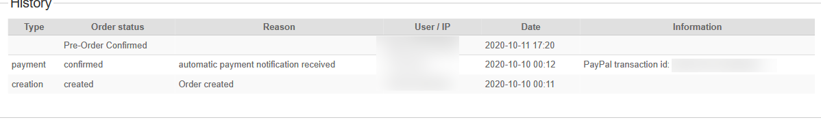

My client has contacted me advising that he received an email about an order with the following message
A Paypal notification was received with the status . The order status was not changed.
The order had already been confirmed and the status was updated manually to Pre-Order Confirmed
In the order status list this is ticked as invoice.
Just wondered if this has been encountered before and of you may have some advice?

The order was confirmed via the usual process and then the site owner updated to one of the order statuses he uses. The email he recieved contained the following:
I have also attached a screenshot of the history
David

I would recommend to check the IPN history in the PayPal merchant account.
It should list all the payment notifications made to the website, when they were made etc.
If the notification is not listed there for that order for the time when you received the email, it's possible that someone tried to send a fake notification for that order (not likely though). In that case, there are protection mechanisms in place to have modifying the order if it doesn't come from PayPal. Still the system would still send that email notification to the shop owner so that he can check things out.
