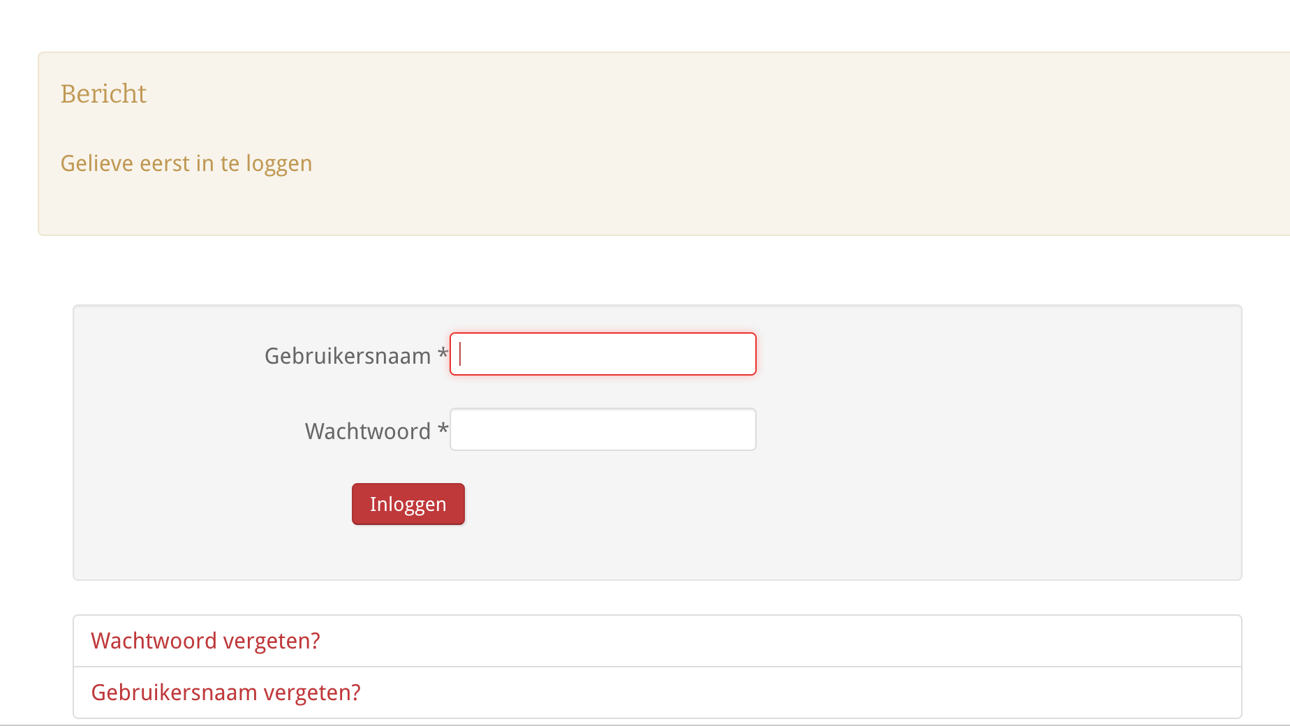

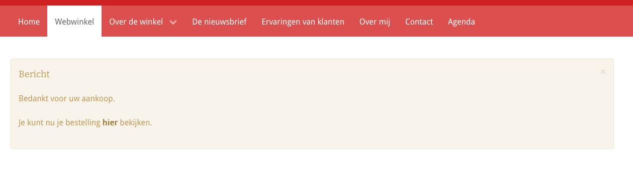

Just following up on this issue, because I have the same issue. No confirmation was sent. Also after a test payment with iDeal, I was re-directed to a page with a link to check the order I placed. After clicking this link the (guest) customer has to log-in, which can't be done, because there is only the possibility to check-out as a guest.

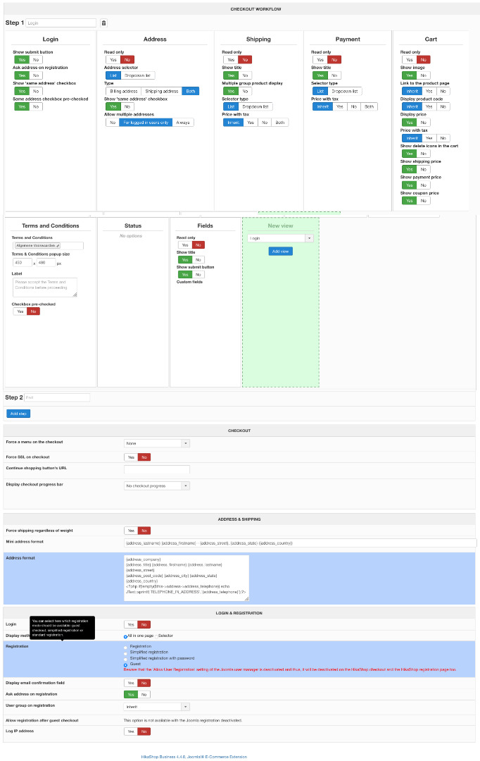

Could you also provide a screenshot of all the settings under the "checkout" tab of the HikaShop configuration so that we know how your checkout is setup ?

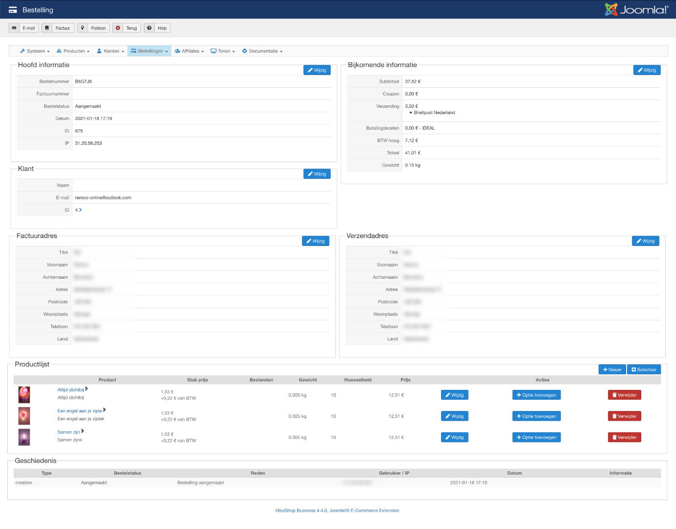

Could you provide a screenshot of an order details with the issue ? (you can blur the sensitive information on the screenshot)

It seems that in your last message, you're saying that it worked with a guest purchase, and didn't work with a logged in purchase, which is the opposite of what you were saying until now.
Do you confirm ?
In that case, it means that it's not linked to whether the user is logged in or not for the purchase.
Also, on your screenshot of the order information, I can see that the order was not confirmed and stayed "created".
And in the history, no automatic payment notification was received.
So it doesn't look like it's an email issue, but rather a payment notification issue.
Looking at the order information, I can see that you're using Ideal so I suppose you're using a third party payment plugin.
You'll probably have to check with the support of the payment plugin you're using for help here.

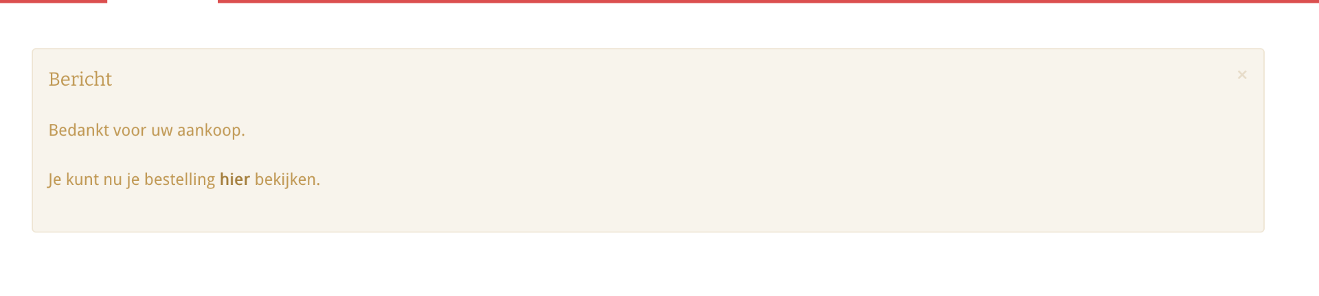

Still remains for the second placed order is my question: "After a test payment with iDeal, I was re-directed to a page with a link to check the order I placed. After clicking this link the (guest) customer has to log-in, which can't be done, because there is only the possibility to check-out as a guest." Instead of a thank you page. Is that a configuration issue?

There are 2 options to pay in the shop: 'Payment in advance' and 'iDEAL' via Sisow plug-in. When using 'payment in advance' the customer will return to the following url with info how to pay in advance: /webwinkel/checkout/confirm. This is correct!
But when using the iDEAL payment the visitor will return, after paying, to a thank you page with a link to a log-in page: /index.php?option=com_hikashop&ctrl=checkout&task=after_end&order_id=681&itemid=920. This is something we don't want, becuase the customer can't log-in and should be send to a thank you page without the possibility to log-in.

5 years 3 months ago #332204
Just a short reply for everybody who also wants no log-in button after placing an order as guest.
Just delete:
if(!empty($this->url))
	$app->enqueueMessage(JText::sprintf('YOU_CAN_NOW_ACCESS_YOUR_ORDER_HERE',$this->url));
$app->triggerEvent('onHikashopOrderTrackingDisplay', array($this->order));
in 'checkout / after_end.php'.
