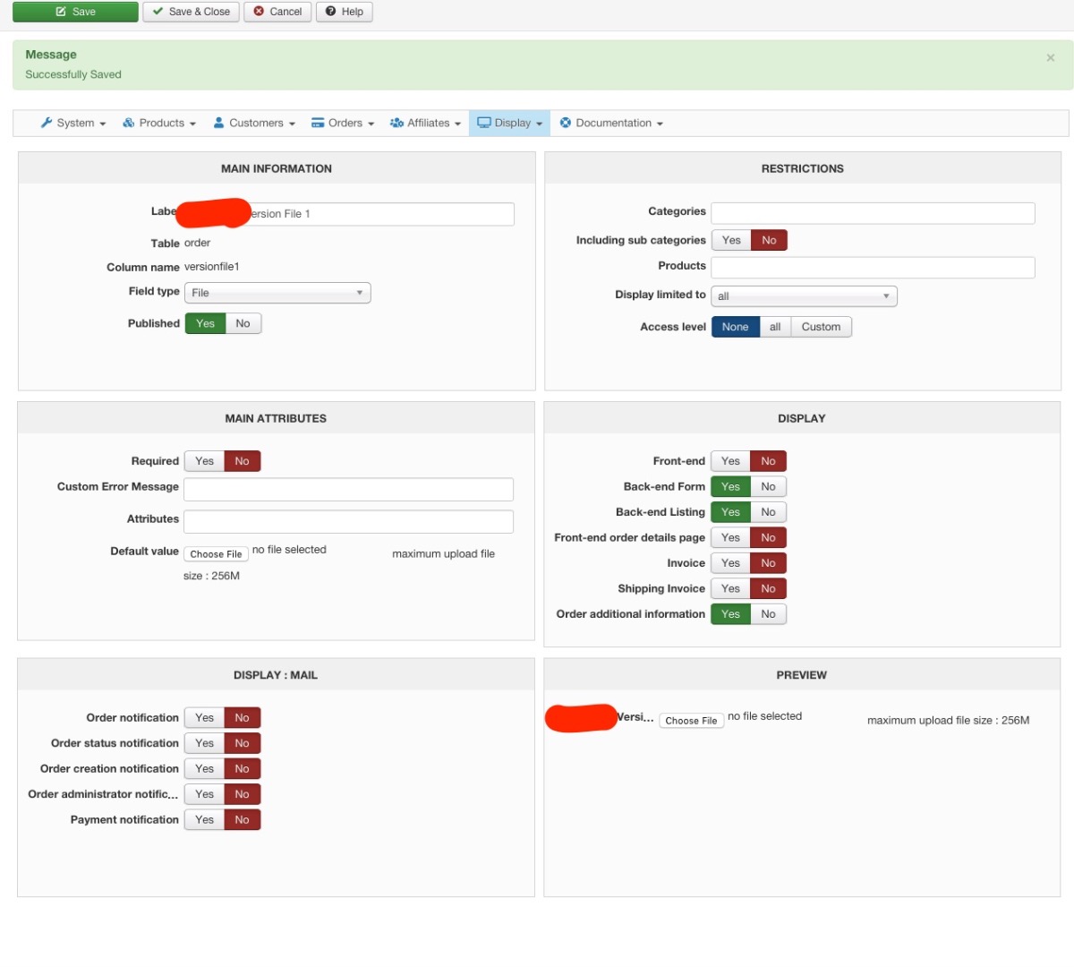

I have added a couple of order table custom fields of the type "File". I had expected that I would be able to add a file URI to this field and that I would be able to notify the customer that the file had been uploaded to the server ready for them to download.
However, this field does not show up in the order management in the back end.
I have also tried using the Ajax File type field, this doesn't show up either.
How can I add this kind of field?

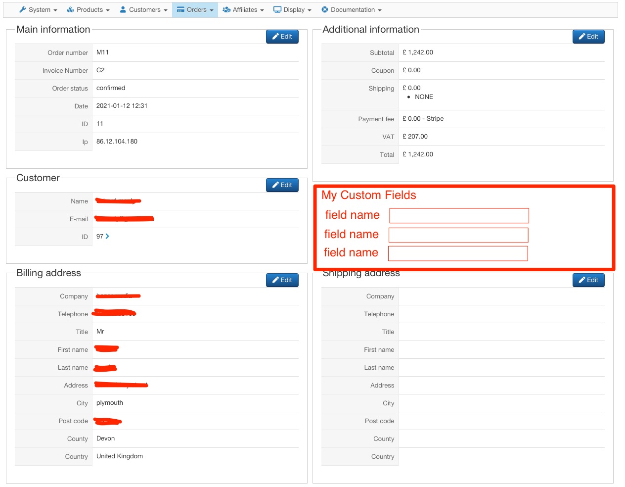

Also, in the order management screen is there any way to make these additional custom fields show up in a new display section as per the the attached screnshot?

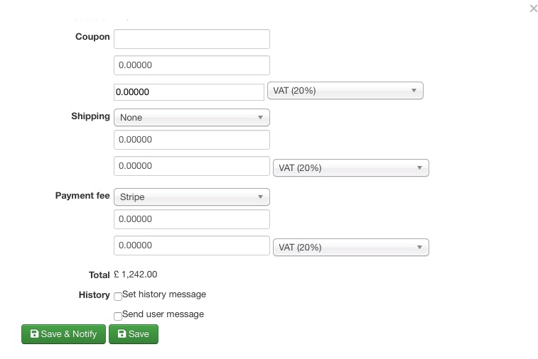

On your screenshot, the order custom fields will only appear once they are filled in.
If you want to fill them in in the backend, you need to click on the edit icon of the "additional information" section and they will be at the bottom of the edition popup.

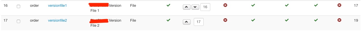

Thanks, I have checked that the custom field definition is set to display in the back end for field type "File" or "Ajax File", and it does not appear in the Additional Information edit modal window.

It indeed looks like the custom field is properly setup.
I would recommend you to use the "ajax file" type instead of "file". It will work better.
But I don't think it will change anything to the issue at hand.
I think we'll need a backend access and a FTP access to directly check on the situation.
Could you provide that via our contact form along with a link to this thread ?
