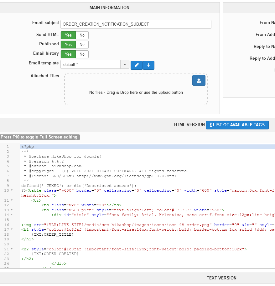

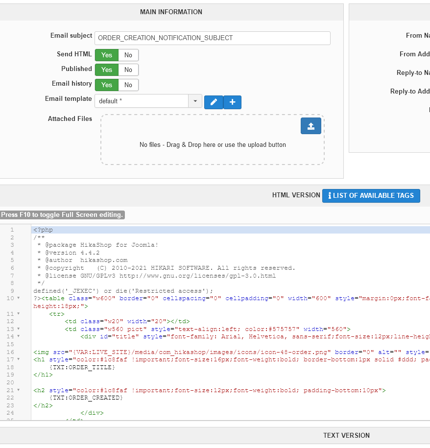

This is odd, I don't have any CSS in my template. As a matter of fact I don't see any CSS in any of the templates, none in the ones that I customized and none in the ones that are not customized.
I even removed the "HTML customization" and "Preload Customization", from one of the one that I customized just to see if that would make it appear but there is still no CSS.
Please see my screen shot.
Thanks!
Thanks!
5 years 2 months ago #334224
by nicolas
Replied by nicolas on topic Make Pay Now Button More Visible
Your screenshot is for the HTML version.
My screenshot is for the template popup.
You'll get what I'm talking about if you click on the edit icon of the "Email template" setting in the "Main information" section on your screenshot.
5 years 2 months ago #334272
by MyWorld
Replied by MyWorld on topic Make Pay Now Button More Visible
Oh I see what you mean now. Thanks
