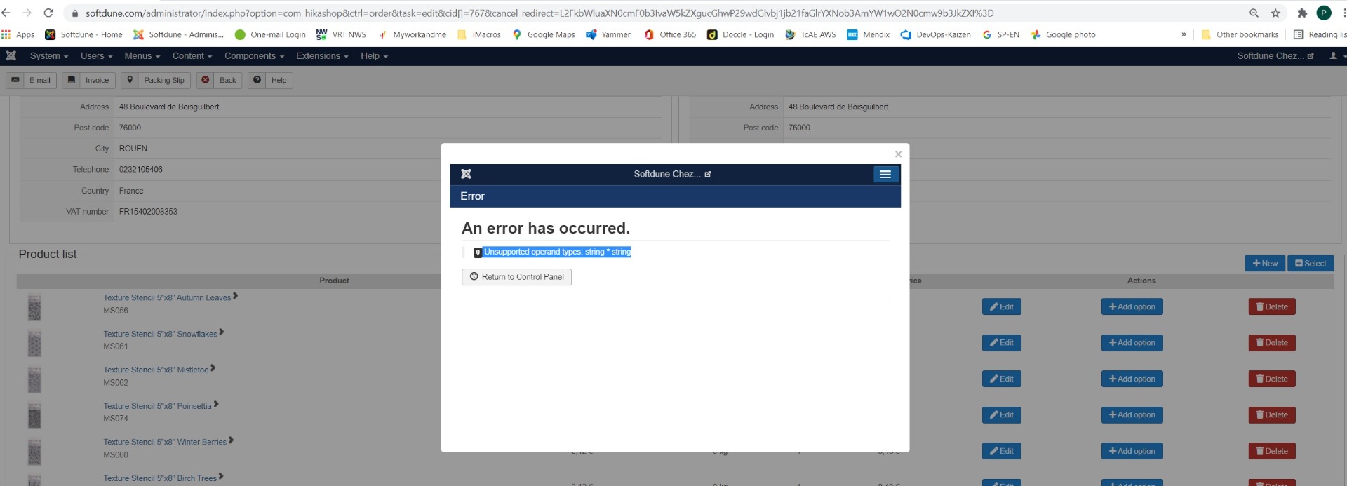

-- Error-message(debug-mod must be tuned on) -- : Unsupported operand types: string * string
When we add manually a product to a product list we get an error after clicking on Save.
This happens with the two options (NEW or SELECT)
This error started after upgrading my PHP over the weekend.
