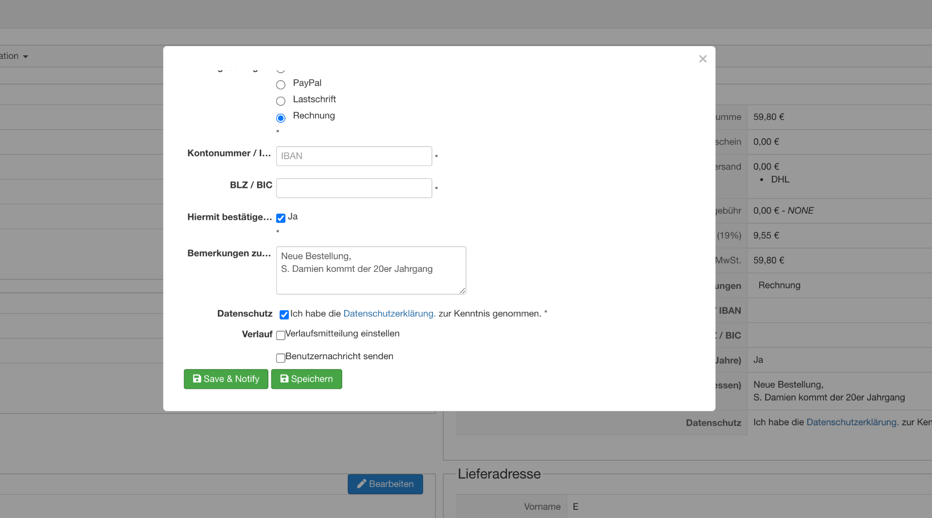

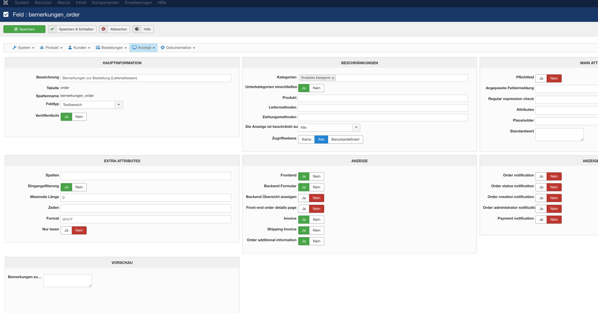

-- url of the page with the problem -- : weinpalais.de/
Since the last update, we cant edit one of our customs fields anymore.
After saving nothing happen. Even delete of the content is possible.
Any idea?
