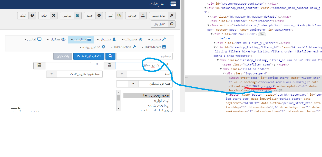

4 years 8 months ago #338804

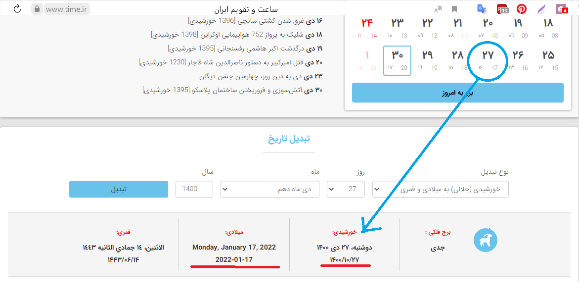

4 years 8 months ago #338815
by lorus
Replied by lorus on topic Orders Calendar filter
Scanning the order filtering pages, I found an interesting point
By selecting the local day, month and solar year: 10/27/1400
data-alt-value is calculated as half-year and half-solar, which causes the problem
As you can see in the attached image. Blue is the menu selection Red is the system selection
In choosing the system instead of January 2022, it is stated that April 2022 17 means half solar solar half year.
2022-01-17 is equal to 1400/10/27, not April 17, which is the first solar month.
I hope I was able to convey the problem clearly
