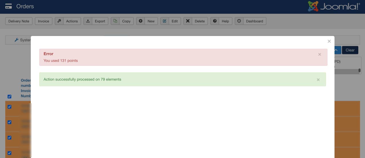

my client recently updated a number of orders via actions on the administrator/index.php?option=com_hikashop&ctrl=order&order_type=sale&filter_partner=0 While everything seems to have worked as expected the screen displayed the error as per the attachment. I would appreciate your thoughts/suggestions on why this may have happened.

This indicates that the user points of one of the users (who were linked to the orders being modified) went below 0 with the action that was made by your client.
For example, if he refunded the orders, the points gained by the users when making the purchase would be substracted from their user points. But if they used the points they earned in the meantime, then this situation could happen.
In that case, the system displays that error message and set the user points of the user to 0.
We'll improve the message to "The user %s got % points deducted. However, he only had %s points left. His user points has been set to 0 but you might want to do something manually." for the backend so that it's easier to understand whose user account the message is for and why it's happening.

Well, you can check the points of the users of each order and see which ones have an amount of points at 0.
If you have several of them, you need to check their order(s) that were processed by the action and check if it could generate a change of -131 points.
With my patch, next version of HikaShop will display the user email address and how many points it had before the change, so it will be easier to know what happened for your client.

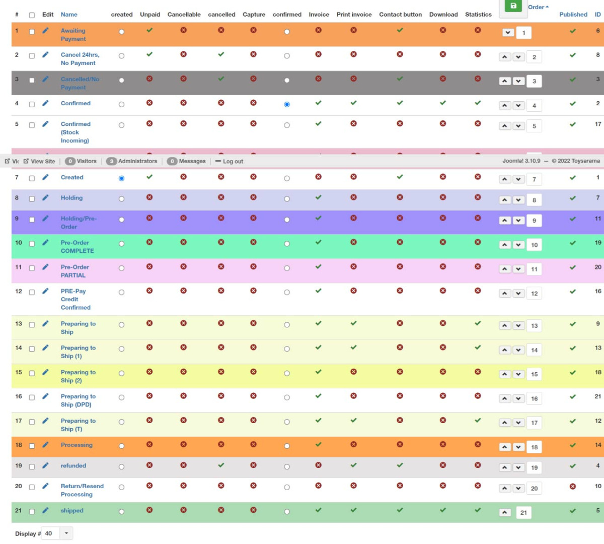

Looking at the statuses the only ones checked as unpaid are Created, Cancel & Awaiting Payment. Should invoice only be ticked where payment has been received?

4 years 3 months ago #341887
Under the "unpaid" column, you should have only the status before the payment (so that the customer has access to the payment of an order already created).
And under the "invoice" column, you should only have the status after the payment and not ones where the payment is invalidated (refunded for example). So under that column you should normally have "confirmed" and "shipped" by default.
I checked your website configuration.
Now, I can see you have a lot of statuses, and I don't know what each status is for, so I can't say anything for sure.
There are several things I feel are strange:
- in the column "invoice", you have the "return / resend processing" and the "Cancel 24hrs, No Payment" statuses enabled. I think you might want to disable them.
- in the column "cancelled", you have the "Cancel 24hrs, No Payment" and the "refunded" statuses not enabled and I think they should be.

thanks very much for the info. I have updated the statuses and would just like to confirm that the setting now look correct?

4 years 3 months ago #341997
That look much better. Now please understand that I don't know what each status is used for and what is the workflow of the merchant on that website, so there might still be some things to change but it looks fine to me with the information I have right now.
