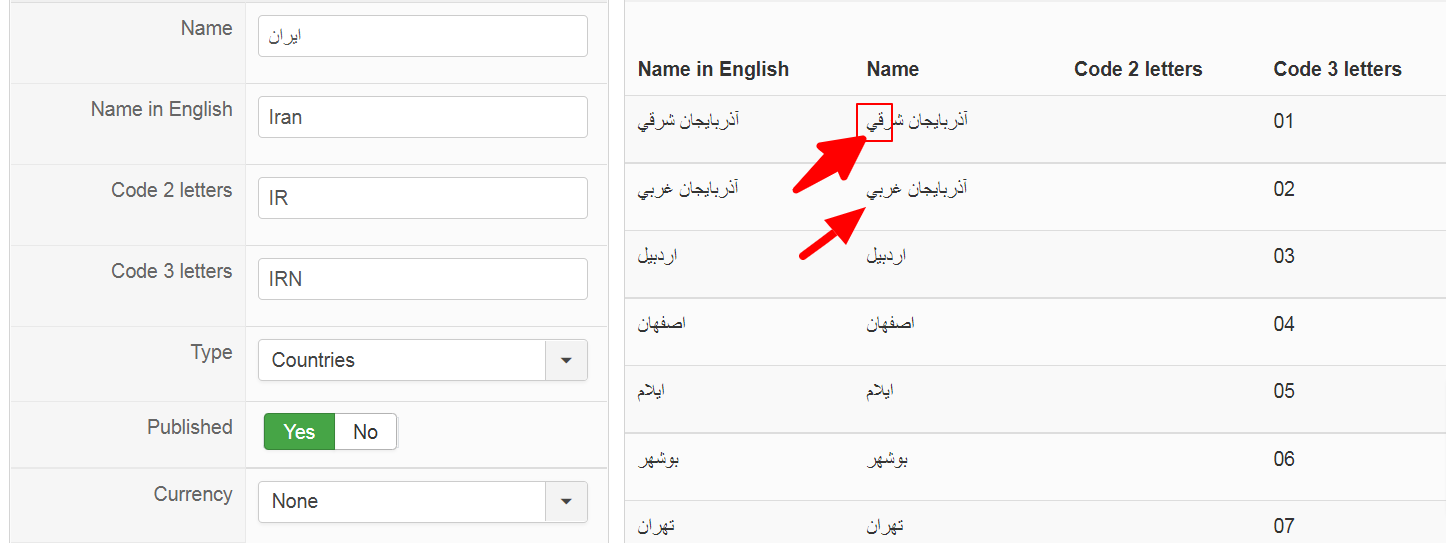

hi
how to get you correct list of sub zone list in persian language?
i understand that i can change subzone from
******.com/administrator/index.php?option=com_hikashop&ctrl=zone&task=edit&cid[]=101
but i want get you correct spelling and translate of subzons.

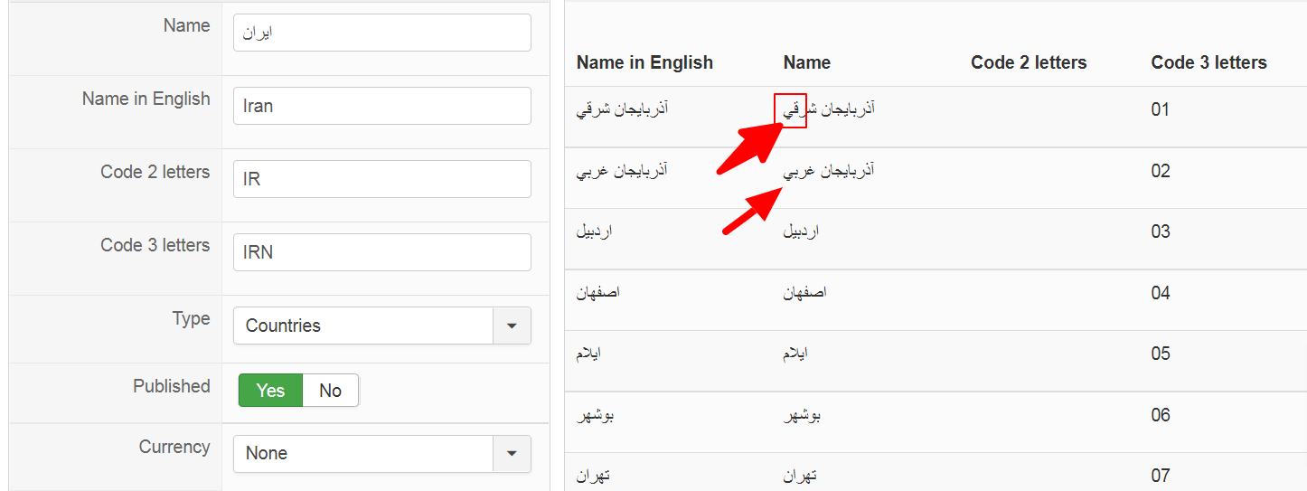

nicolas wrote: Hi,
Thank you.
I checked but we already have the full list in HikaShop.
Hi again
but your list have some little problem in persian lanuage where you can see in the attached file:
in this list hikashop use " ي " but in correct type must use " ی "
in the excel file i attached here this is correct and also you can see in this link:
fa.wikipedia.org/wiki/%D9%81%D9%87%D8%B1...8C%D8%B1%D8%A7%D9%86
nicolas wrote: Hi,
Could you provide the list with the order someone from Iran would be familiar with so that I can order the provinces in that same order ?
the attached file has new order from previous file and this new file has more familar order for iranian people and also you can see this order in above wikipedia link in current post.

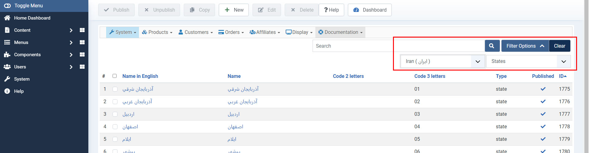

  • Posts: 145
  • Thank you received: 6
4 years 2 months ago #341827
Hi nicolas. let me answer this.
اول وارد قسمت مناطق شو.
اون جا تنظیمات filter option رو طبق شکل زیر انجام بده.
مناطق مربوط به ایران رو میاره.
روشون کلیک کن و ویرایش شون کن.
Life is the unique stage of our art. Everyone sings their own song and leaves the stage. The stage is always permanent. Blessed is that song that people remember.
Last edit: 4 years 2 months ago by levelup.
  • Posts: 221
  • Thank you received: 8
4 years 2 months ago #341829
levelup wrote: Hi nicolas. let me answer this.
داداش ورود نکن. نیکولاس داره هسته هیکاشاپ رو تغییر میده. من متوجه هستم که از کجا باید ویرایش کنم. توضیحاتی که من دارم میدم برای تغییر در هسته هست که در ریلیز های بعدی هیکاشاپ این مشکلات رو نداشته باشه. این تاپیک رو ادامه نده بذار کار به نتیجه برسه. ممنون

  • Posts: 86051
  • Thank you received: 14179
4 years 2 months ago #341820
Thanks. Yes, I've updated all the names in Iranian with what was in your excel file so they should all be correct.
I've also reordered them so it should be all good now.
Thanks for sharing !
