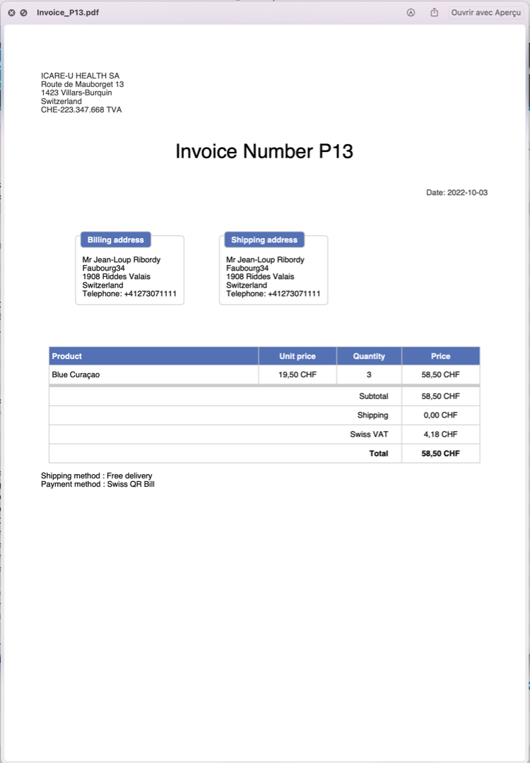

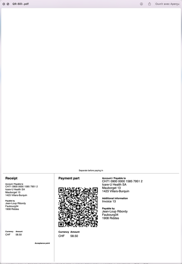

Dear Support,
Any change to join as second page the Swiss QR bill to the invoice sent by mail. And to have 2 pages in the invoice sent?
I can imagine that it would be easier than to integrate directly the QR Bill info at the bottom of the invoice, on the same page...
Thanks for your help
Jean-Loup

Either way is not that simple.
I think the best would be to develop a third plugin which would implement the onBeforeMailPrepare event so that it could check the attachments with $mailer->getAttachments(), merge the PDF attachments with github.com/clegginabox/pdf-merger , remove them with $mailer->removeAttachment($index) and add the merged PDF with $mailer->addAttachment($path, $name)
So not impossible but there are several hours of development.
