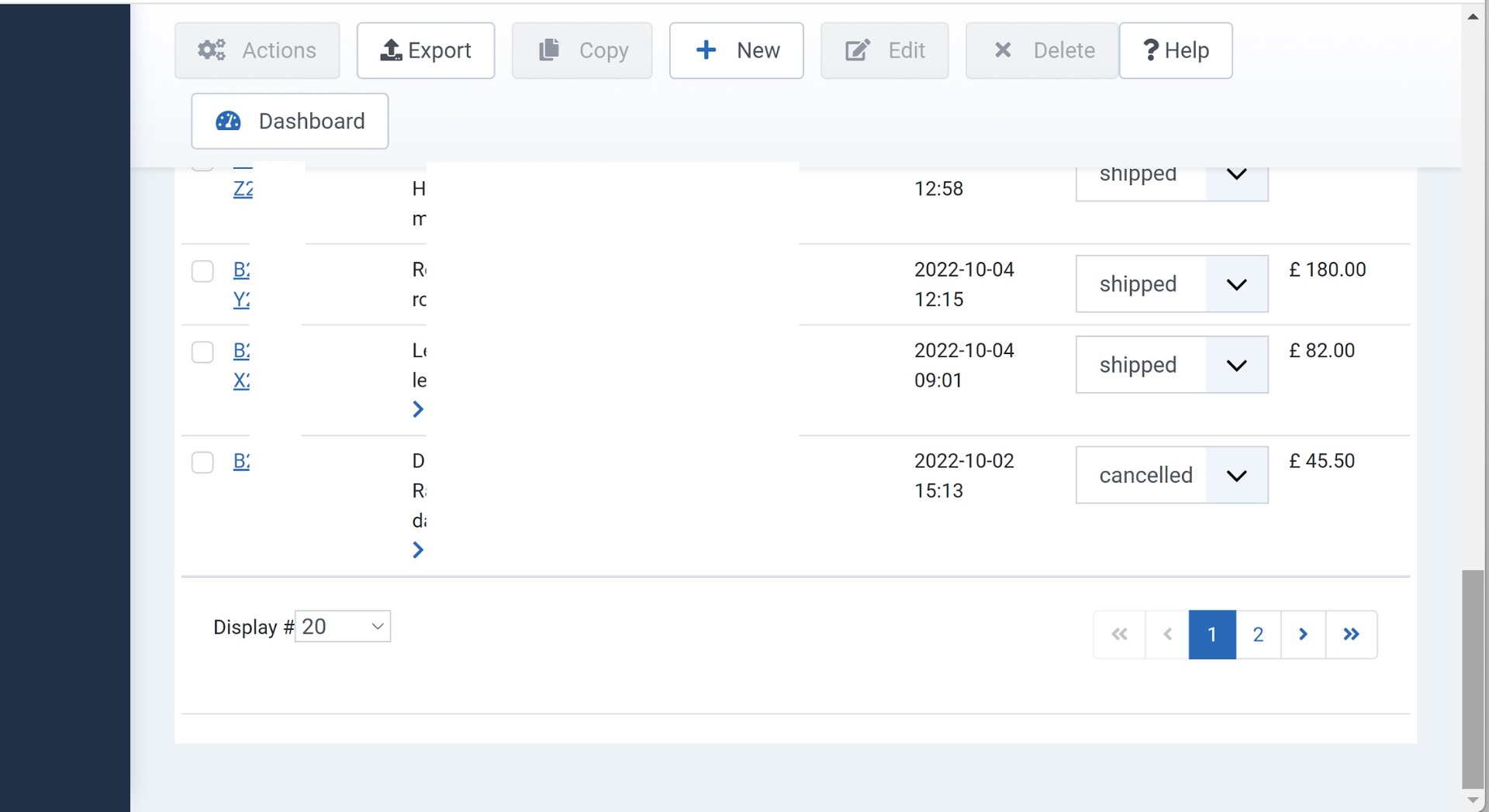

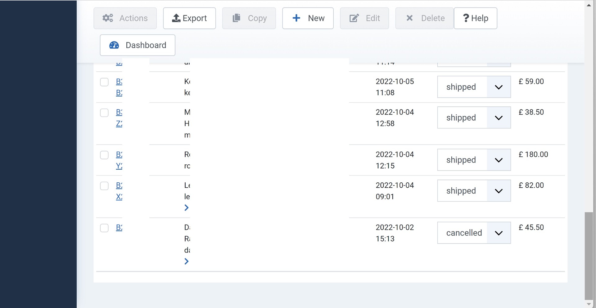

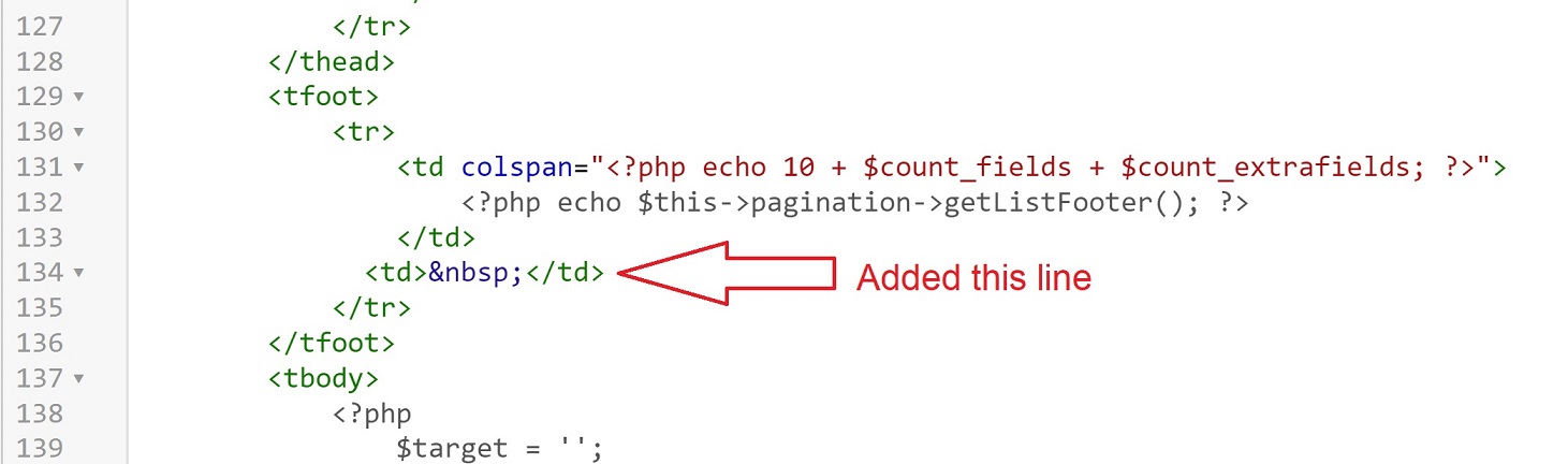

Thanks for getting back to me. I've been trying to debug this issue and found the pagination is visible in source code but the tfoot section is of zero height. Though I can't see what in the CSS is making that happen. However, I know this isn't a correct solution, but I found that if I add an empty space in a TD block in the same table row, it magically appears.
Here is the page with no pagination
Here is the order listing view section where I added the TD block
Here is the result of adding that to the code
Can you suggest a better way to fix this?

The better way would be to look at the HTML/CSS of the area with the browser's inspector while the fix you've added is removed so that you can check what is setting the height of the area to 0px. Once you know where it comes from, some proper fix can be implemented.
But with just the screenshots I can't say.
