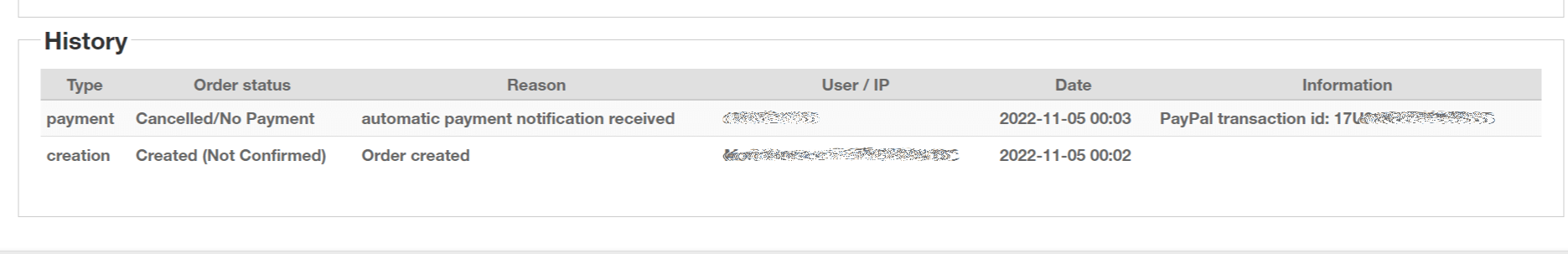

I have a situation where an order is placed and paid for using PayPal Standard. The order is then showing as cancelled but has a PayPal Transaction ID. The one or two that I have checked also match the Payment logs which I have just downloaded. It is also worth noting that some orders were not paid and therefore met that criteria.

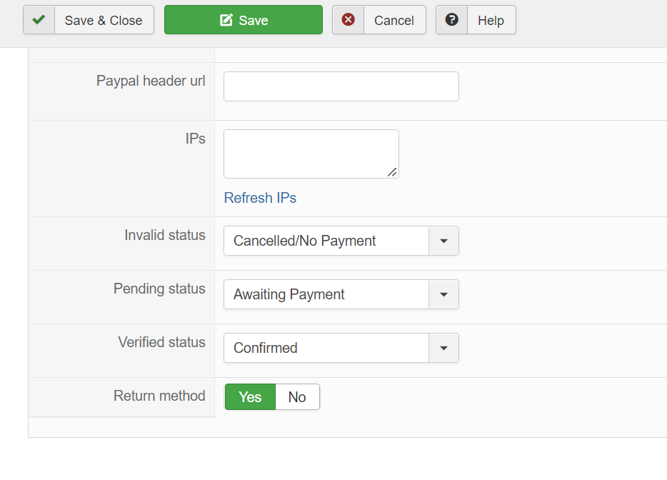

4 years 2 weeks ago #346416 by nicolas
It could also be that the "verified status" setting of the payment method has been changed to "cancelled" instead of "confirmed", so that's another thing to check.

3 years 11 months ago #347136 by nicolas
This indicates that everything went fine for the PayPal plugin during the payment notification.
So either:

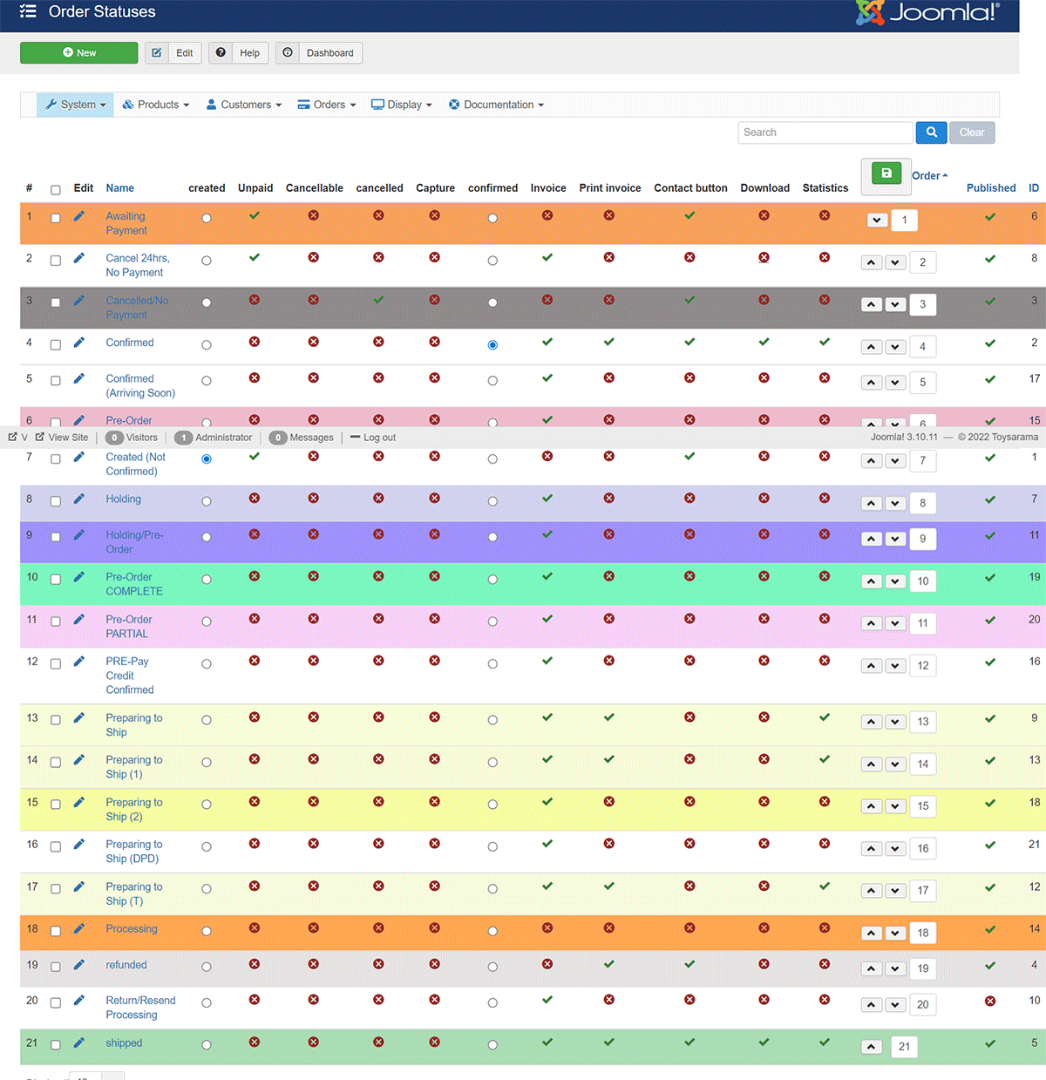

- you have selected "cancelled" instead of "confirmed" in the "verified status" setting of the payment method. So check it via The System>Payment methods menu
- you have a mass action or a plugin which changes the status from confirmed to cancelled on the fly during the confirmation of the order. So, do you have mass actions ? Do you have custom plugins ? Does it work fine if you manually changes the status of the order in the backend ?
These would be the things to check.

3 years 11 months ago #347241 by nicolas
Thanks for the access.
Whiel the "send order details" setting is turned off, I still think it has something to do with the amount paid.
If you look at the debug data for the order 1022845 you can see the amount paid is 13.94. But if you check the total amount displayed by HikaShop when you edit the order, it is 13.95.
It's that 1 cent difference which caused the order to be cancelled instead of being confirmed.
I think you want to activate the "Round prices during calculations" setting. It should help with that for futur orders.
