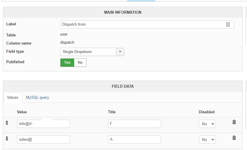

This is close but a bit too far. We don't actually need the customer to pick the warehouse because the staff will set that in the backend. I've made a custom field: user_dispatch
I have put the emails in the 'Value' column.
Also, we don't really need to use CC/BCC, I rather that the email was sent directly to the right place rather than just copied to it with BCC.
Thanks again for your help.

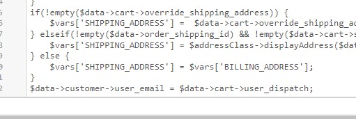

Then, in the order admin notiifcation, you should be able to do it by add this at the end of the preload section :
Code:
$data->customer->user_email = $data->cart->user_dispatch;
3 years 10 months ago #348290
by Adnohr
Replied by Adnohr on topic Send order created email to custom field email address
Doesn't seem to be send the email, did I do something wrong?
3 years 10 months ago #348294
by nicolas
Replied by nicolas on topic Send order created email to custom field email address
Your custom field column name is not user_dispatch but dispatch, and it is in the "user" table, not the "order" table so you need to change the code to:
Code:
$data->customer->user_email = $data->customer->dispatch;
