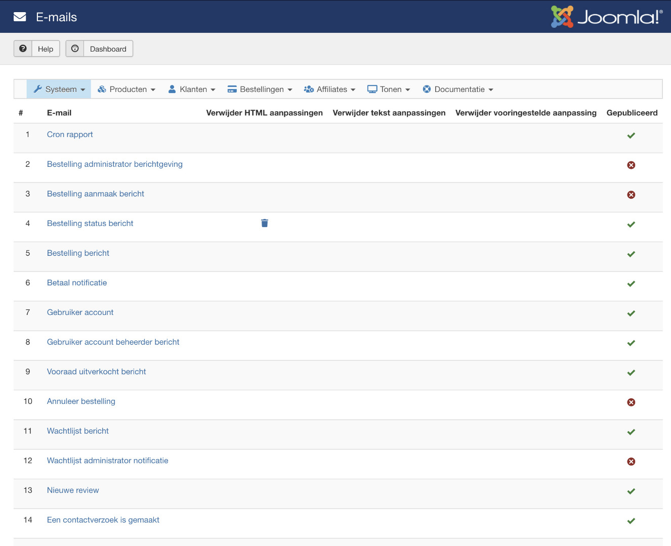

3 years 7 months ago #349315
Then you can "switch off" the relative email, see my screenshot :
Hope this will fit your needs

  • Posts: 10
3 years 7 months ago #349325
Thank you for your response.
This option was and is disabled (See image - number 10), but the emails are still being sent.
What to do?

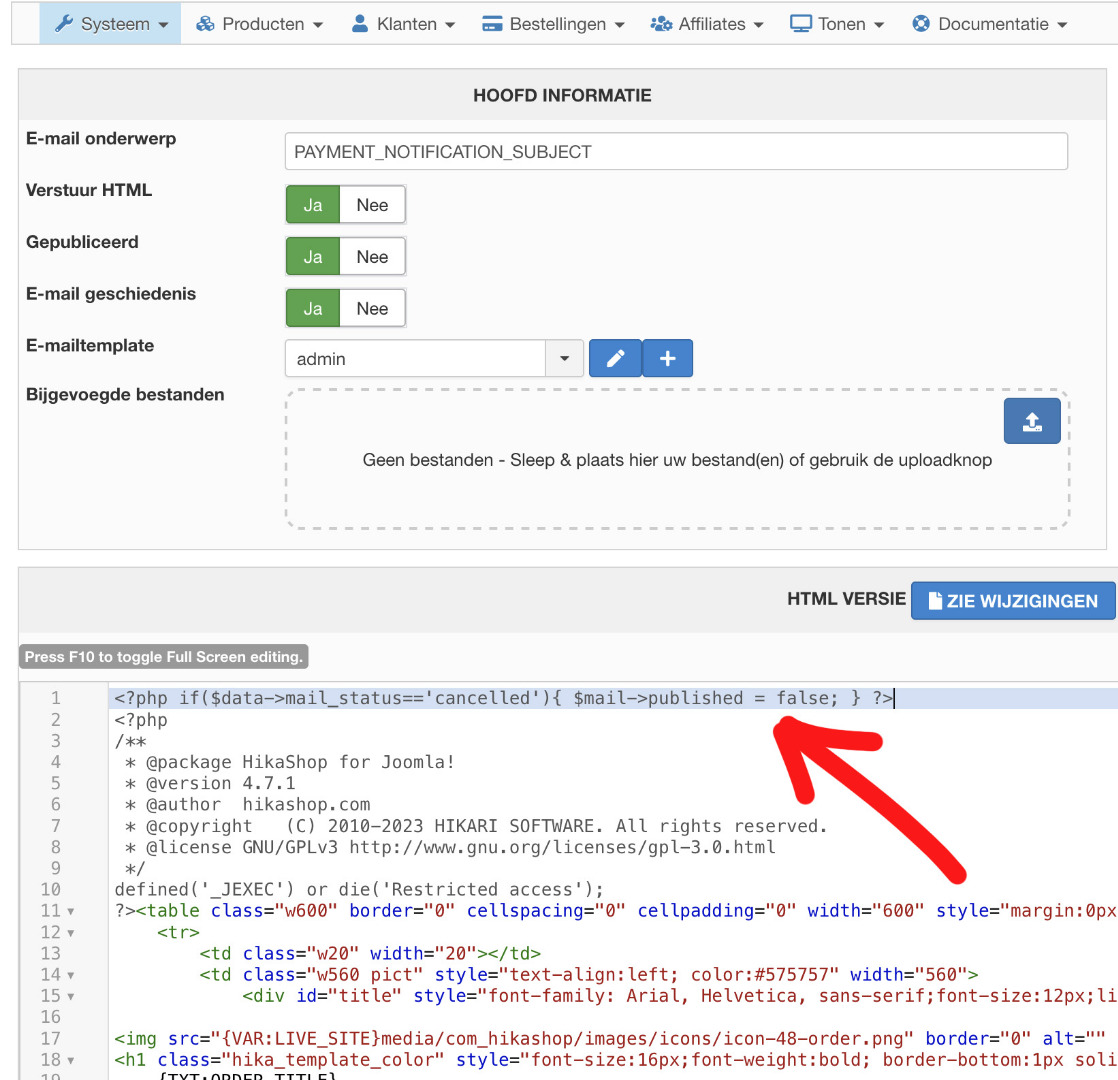

  • Posts: 10
3 years 7 months ago #349402
Thanks Nicolas for your reply and code!
I've placed your line of code at the beginning of the HTML area. But not yet the desired result. Canceled payments will continue to be sent.
Have I placed the code correctly?
  • Posts: 86220
  • Thank you received: 14223
3 years 7 months ago #349403
Ah right, $data->mail_status is the translated status text.
Try changing this to $data->order_status so that it uses the status namekey and it should work better.
