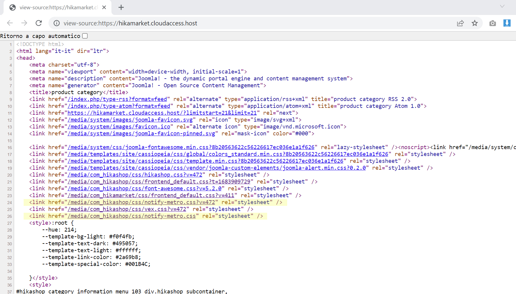

When in HikaShop Cart notification Plugin, i set Popup in Display location option I see two new css files.
notify-metro.css is the same as notify-metro.css?v=472
I think it is useless to upload two identical files

Indeed, that's a nice catch.
The line:
$doc->addStyleSheet($base.'/media/com_hikashop/css/notify-metro.css');
in the file plugins/hikashop/cartnotify/cartnotify.php should be removed. It serves no purpose there. It's just a wrong copy/paste.
Remove it and it should still all work the same while not having the file loaded twice.
We'll make that change on our end for the next version of HikaShop.
Thanks !
