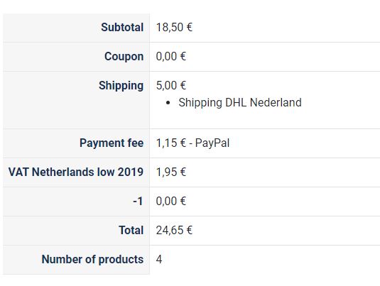

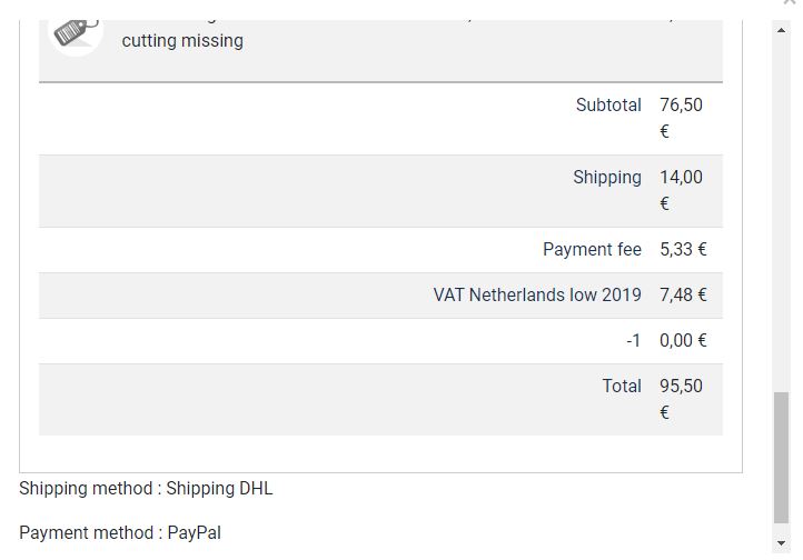

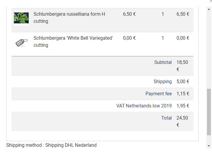

I noticed that the total on some of the invoices is wrong. I have enclosed 3 examples. This one also shows a line with -1 which I do not underatnd. This is a pretty severe problem!

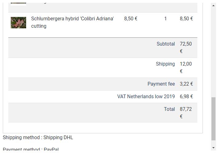

For the first one: The -1 comes from a plugin adding an additional fee or a tax rate. The screenshot looks strange, but without knowing the details of how you configured your tax rules, your shipping fees, your payment fees, and tax settings in the HikaShop configuration I can't say much more.
For the second one, supposing that the prices are displayed with taxes, then 72.50 + 12 +3.22 = 87.72 so the total is correct.
For the third one: It's the same as the first one. However, Checking both, I can see a pattern:
76.50 + 14 + 5 = 95.50
18.50 + 5 + 1 = 24.50
So assuming the display of the payment fee is wrong and display the fee with the taxes includes the taxes twice, I suppose the payment fees are respectively 5 and 1.
So I suppose the total calculated is probably correct and it's more of a display issue. But again, it's hard to say exactly what should be done without the details of how everything is configured.

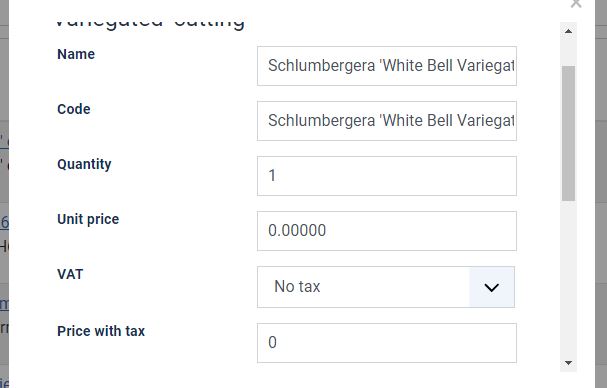

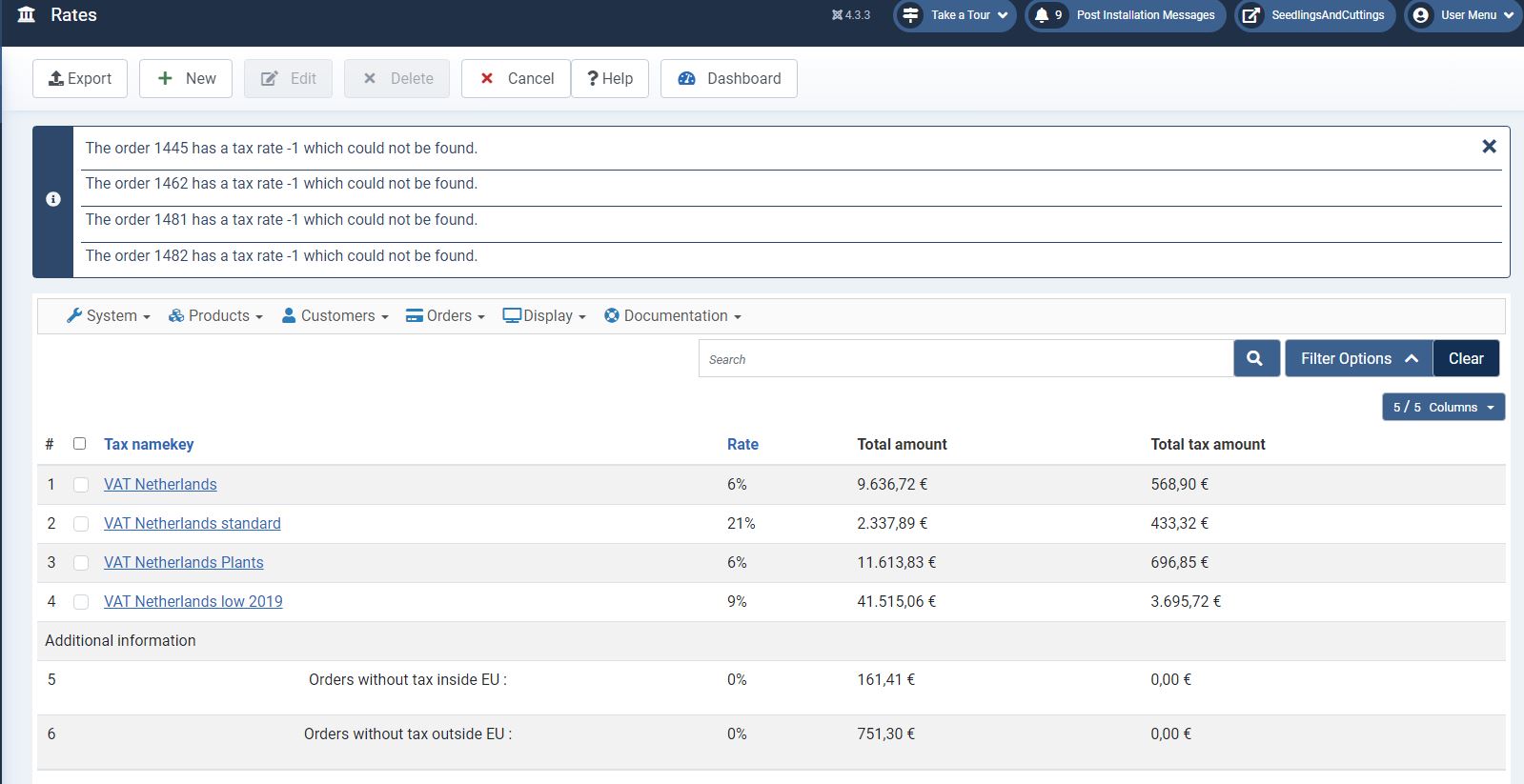

3 years 2 months ago #353411

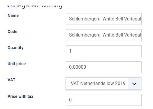

I dived into order 1497.
I found why this total is wrong. It is caused by an entry that was added manually as a free gift.It also explains the -1 on the other order.
When I change the tax of the free item to 'no tax', the total is right but the strange -1 pops up. See the two screenshots.
Now I changed the tax of the free item back to what it was and the total is right.
Maybe this give you a clue where to look. It is caused by adding free items to the invoice..

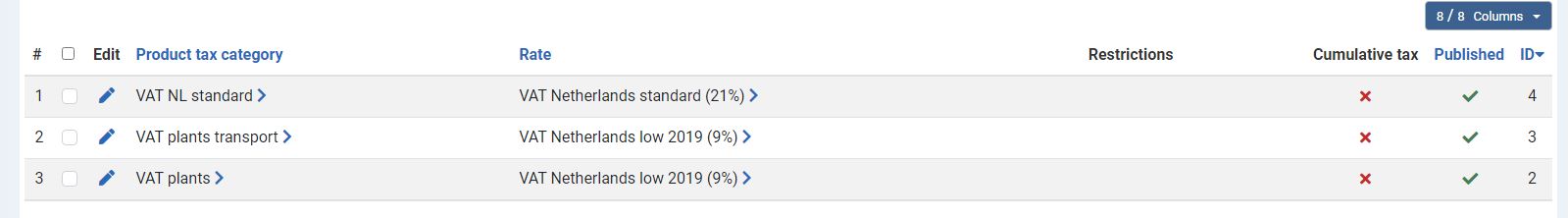

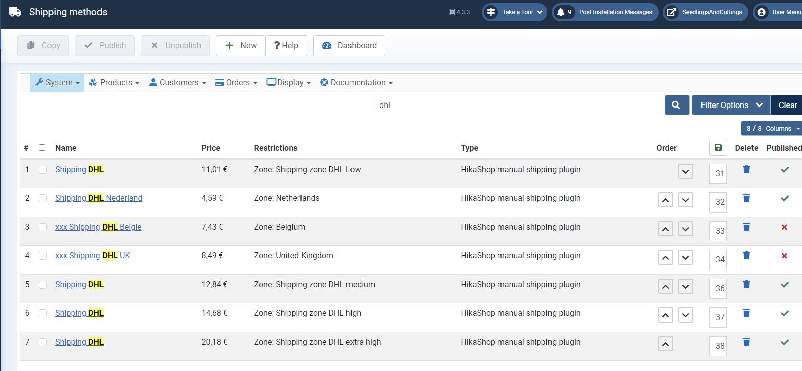

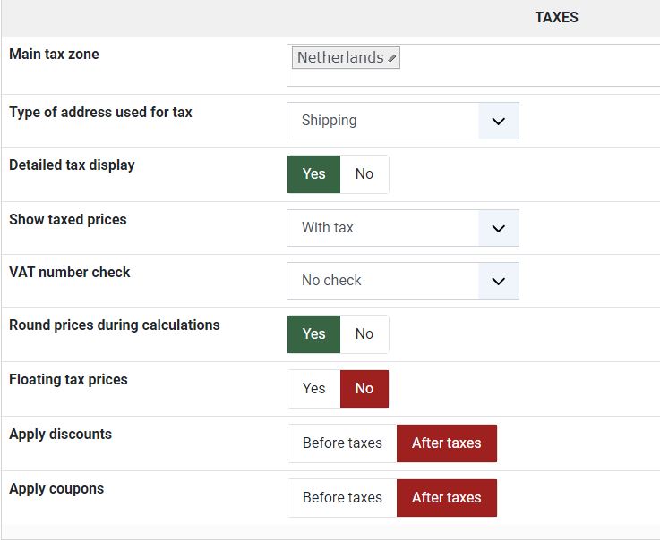

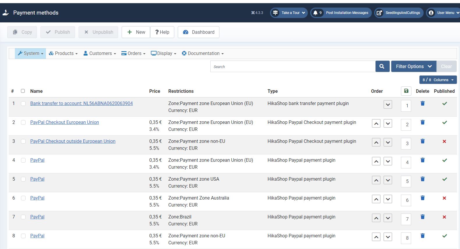

  • Posts: 27
3 years 1 month ago #354346
I have made copies of the settings you required. But I am pretty sure the problem is also related to adding free items in the back-end to an order
