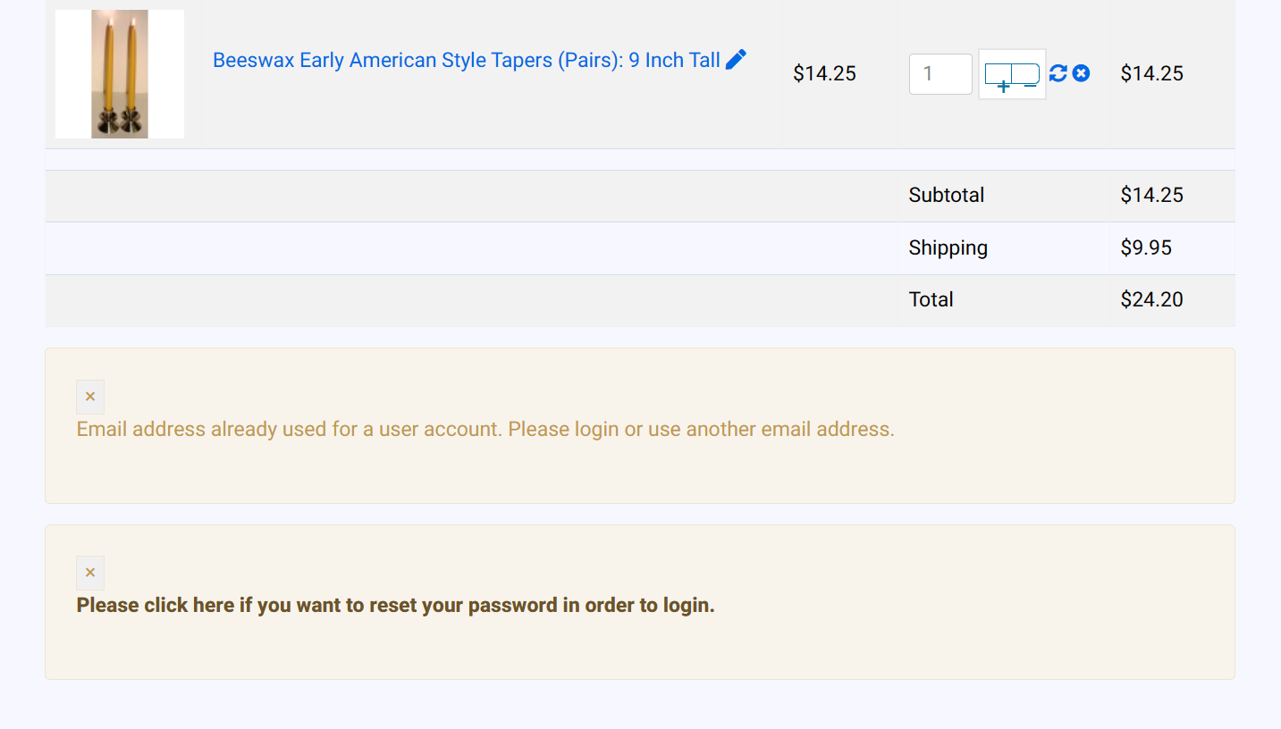

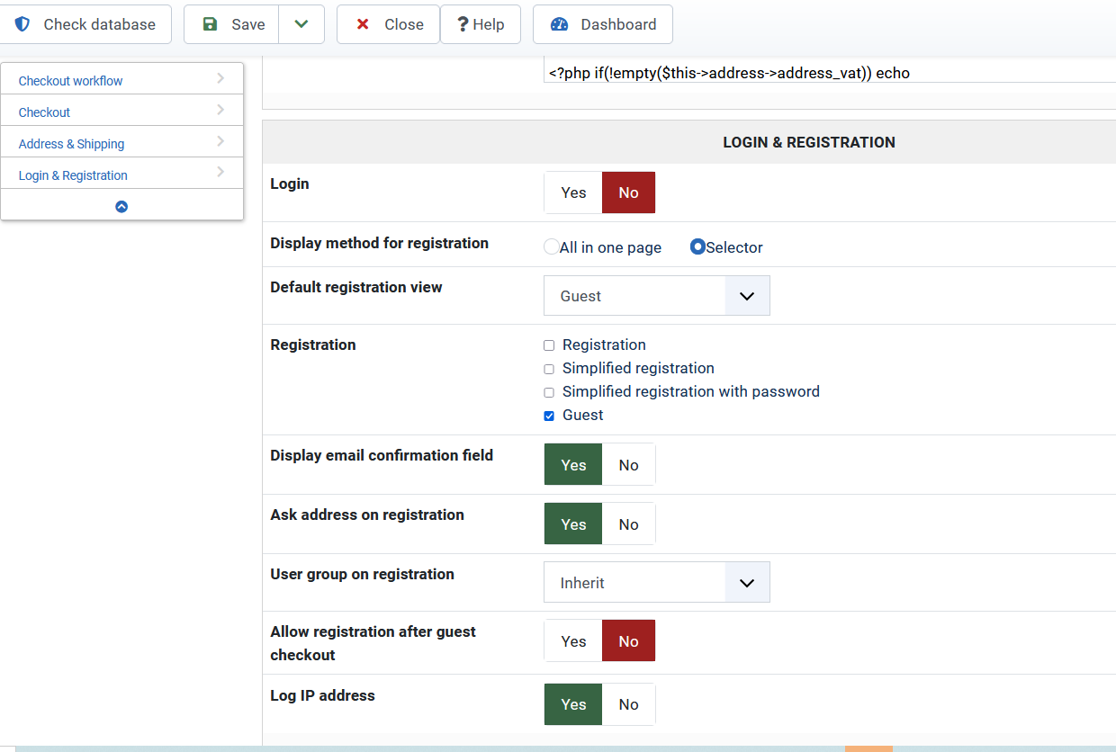

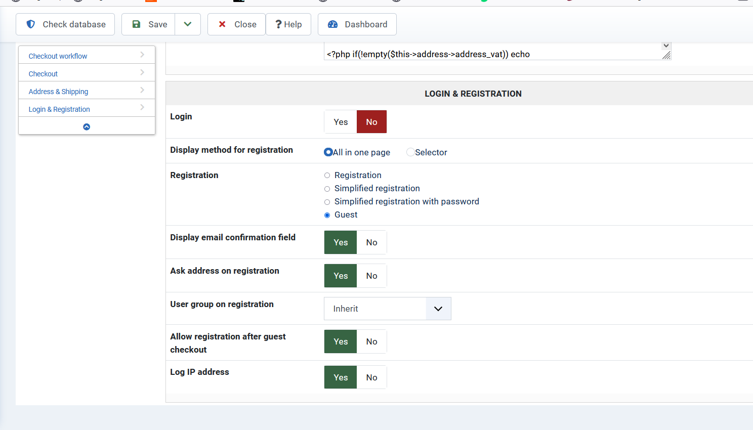

This is what I think may be happening - a few days ago I was trying out using login on our site. It did not workout and you recommended not using it - good solution. "hika- problematic" is an image of the set up
A few days later I noticed a problem with the check out. Something was doing something to my browsers - I tried firefox, chrome and edge. Clearing cache on site, server and browser made it work again.
"hika-working" image is the setup I have now -seems ok except:
When I try a new order using email This email address is being protected from spambots. You need JavaScript enabled to view it. (my email and superuser email) I get the "hika-login-2" error
I use another email address, everything works. I have login set to "no" but it acts like it is still there. Is this the issue?

  • Posts: 86077
  • Thank you received: 14186
2 years 10 months ago #356094
You simply must have created a Joomla user account for that email address.
Delete the user account via the Joomla user manager and you'll be able to checkout as a guest with this email address.
