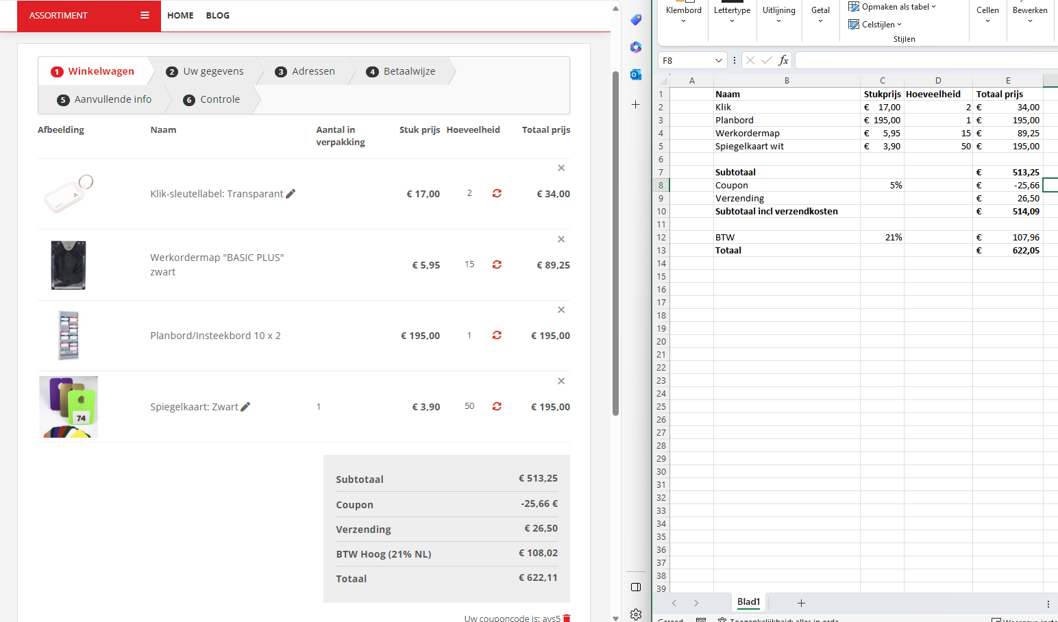

Totday a customer made an order and pointed me out that the total tax was wrong. If I calculate it manualy, I also have a different total, even the subtatal is the same. See attachment:
It has todo with the tax calcualtion, and normaly on or 2 cents can explain, but 6 cents I don't know how Hikashop is commin the that ammout.

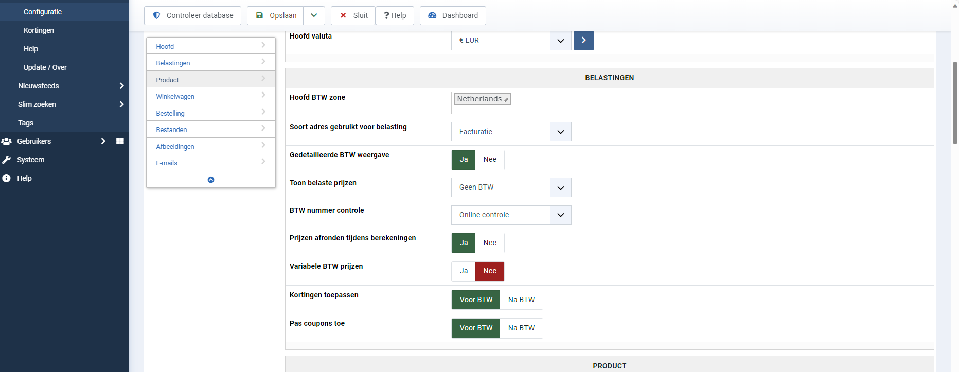

Can you provide your Taxe part settings via a screenshot :
=> In your HikaShop Configuration => Main tab, and Taxes part
Last edit: 2 years 9 months ago by Philip.
The following user(s) said Thank You: Ginius
  • Posts: 52
  • Thank you received: 4
2 years 9 months ago #356720
You mean this one?
  • Posts: 52
2 years 9 months ago #356726
I found it. Needed to tuen of 'Round prices durring Calculation'.
