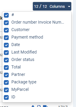

1. This column already exists by default. You just need to enable it in the column selector on the top right corner of the orders listing.

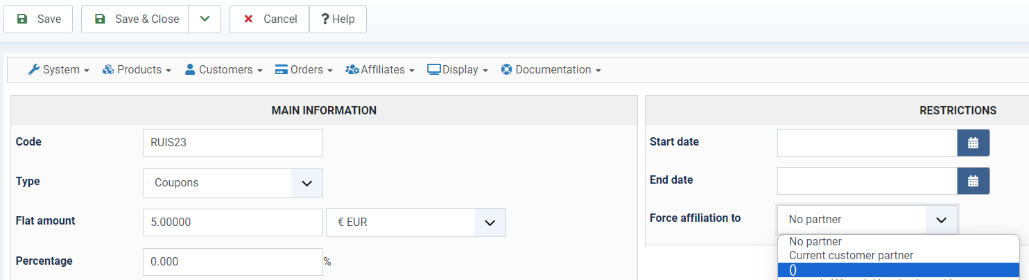

Alternatively the best solution would be to have the system add the partner+fee when their coupon is used. This would need the coupon to have an option to link to affiliate id number i guess.
You're totally right. If you edit a coupon in the backend, you actually have a setting "Force affiliation to" which allows you to select a partner. If you do so, then, when someone uses that coupon for an order, the order will be automatically associated with that partner without having to do anything.

And 1 more question about linking the coupon to partner:

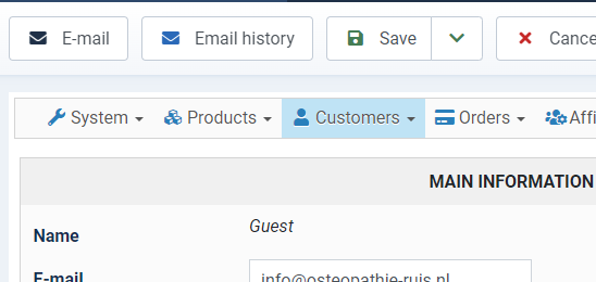

I have 1 partner that had a hikashop customer account so it would not link in coupons. I added a Joomla user account for him but made a mistake in emailaddess. So changing the emailaddress it made a seperate user/customer in hikashop and when i do Action->update the values-> and pick an option to make the user and customer id match, i get a warning message that the emailaddress already exists.
Inside the Force affiliation in coupons i see () as the emailaddress is now without name and user

the column i hope to gain is a coupon column in orders listing, not the indeed already existing partner column.
HikaShop has both columns by default. However, only the "partner" one is displayed by default. The coupon one needs to be activated in the columns dropdown on the top right of the listing, as I was saying.
2. Guest users are not supposed to be partners.
Now, I don't understand what you mean by "when i do Action->update the values-> and pick an option to make the user and customer id match, i get a warning message that the emailaddress already exists.". How come HikaShop would display a warning about email addresses, when you're just changing ids ? It seems to me that I'm missing some information here. Without knowing more, I can only think that the problem is with the mass action you're trying to run.

I will add a screenshot for 1. I do not have or see column option Coupon
for 2. Let me ask a question instead of rephrasing the issue:
How do i connect/fuse a Hikashop customer to a seperate Joomla user and have them both have the same emailadres?

1. Then it means that you're using an old version of HikaShop. As you didn't specify your version number, I assumed you had the latest one. Update and you'll have it.
2. So I understand that you have this:
- email address 1 has an entry as a guest user in HikaShop
- email address 2 has a Joomla user account, and a user entry linked to it in HikaShop
Now, you want to user email address 1 for the Joomla user account, is that correct ?
In that case, you want to first delete the guest user in HikaShop. Then, you can change the email address of the user account.
