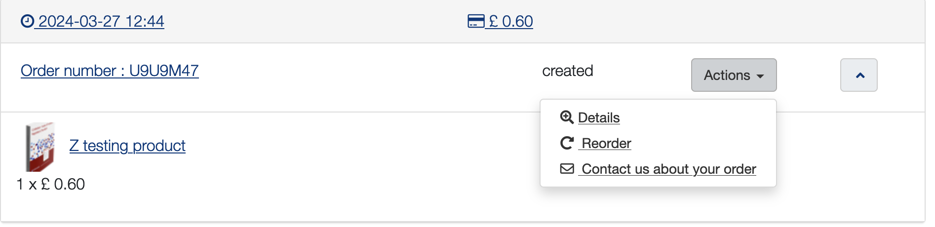

I believe there should be away to allow customers to pay for an order through the "My orders" panel.

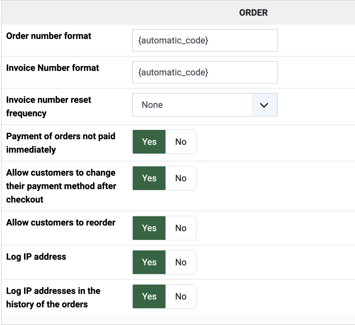

I think this is done via the "Payment of orders not paid immediately" option set to "Yes" in the Configuration/Orders section.
Problem is I've got "Payment of orders not paid immediately" switched to "Yes", but when I go to "My Orders" I'm not seeing an option to Pay - should this appear under the "Actions" dropdown?
I have added screenshots to illustrate.
Any help much appreciated - as always.
Kind Regards
D

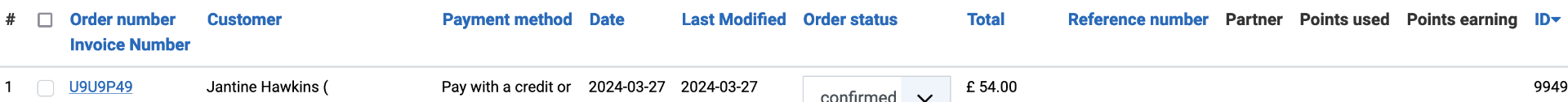

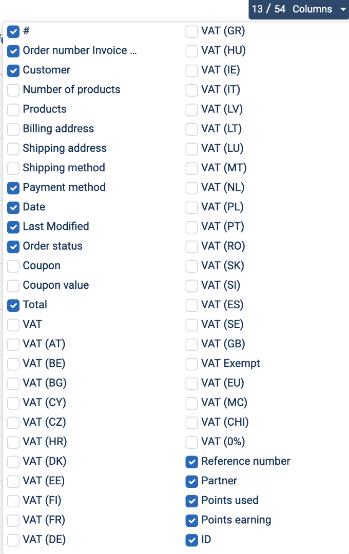

I don't see the "unpaid" column in my backend, and I don't see it as an option to add as a column - see screenshots.
Do I need an additional plugin to get this functionality?
