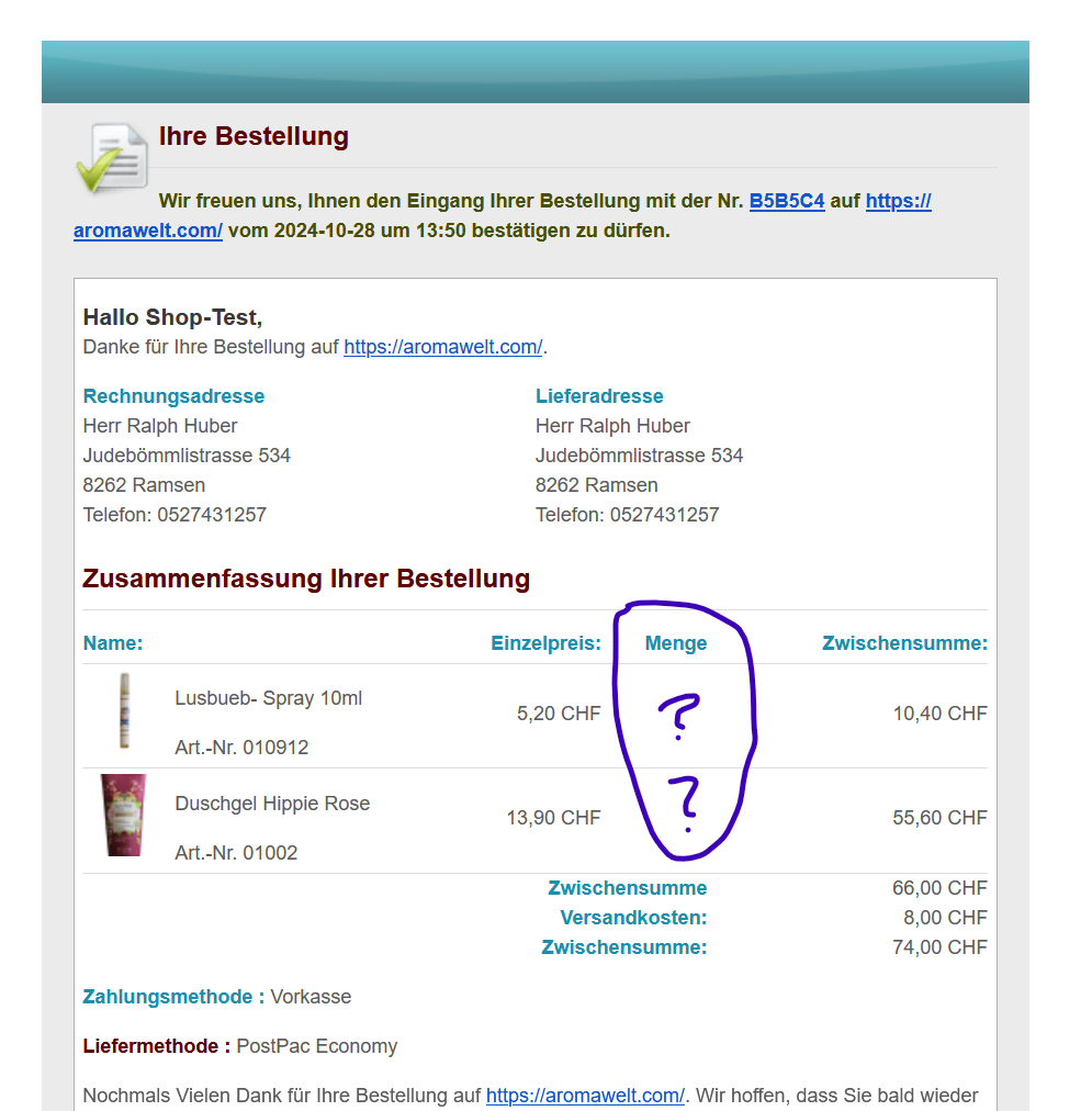

Hallo
Die Produktmenge wird im Bestell Mail nicht angezeigt.
Woran kann das liegen oder wo kann ich das einstellen?

Hello
The product quantity is not displayed in the order email.
What could be the reason for this or where can I set it?

I've never seen that.
Looking at your screenshot, it seems that you've customized the email.
Go in the menu System>Emails and edit the email. Normally, the quantity is displayed by the tag {LINEVAR:PRODUCT_QUANTITY} in the HTML version.
Do you still have it ?
Did you change the line where that tag is ?
The default is:
<td style="border-bottom:1px solid #ddd;padding-bottom:3px;text-align:right">{LINEVAR:PRODUCT_QUANTITY}</td>
Also, this tag is filled with the line:
'PRODUCT_QUANTITY' => $item->order_product_quantity,
in the preload of the email. Do you still have that code in the preload section ?
These are the things I would recommend checking first.

I checked all the tags in the emails and everything seems to be correct.
I also overwrote the templates from another Hikashop installation as a test.
Unfortunately, the problem still exists.
I probably missed something somewhere. I'll keep looking and get back to you if necessary.

I have solved the problem.
When searching the forum I found the following post.
www.hikashop.com/forum/orders-management...quantity-number.html
It was just a typo :-)
("{LINEVAR:PRODUCT_QUANTIY}" by "{LINEVAR:PRODUCT_QUANTITY}" )
