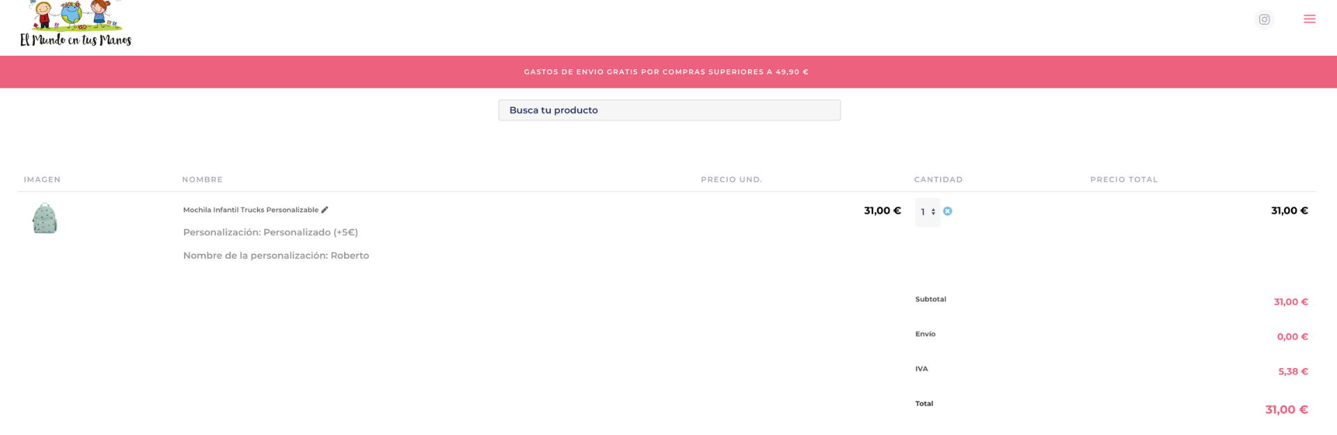

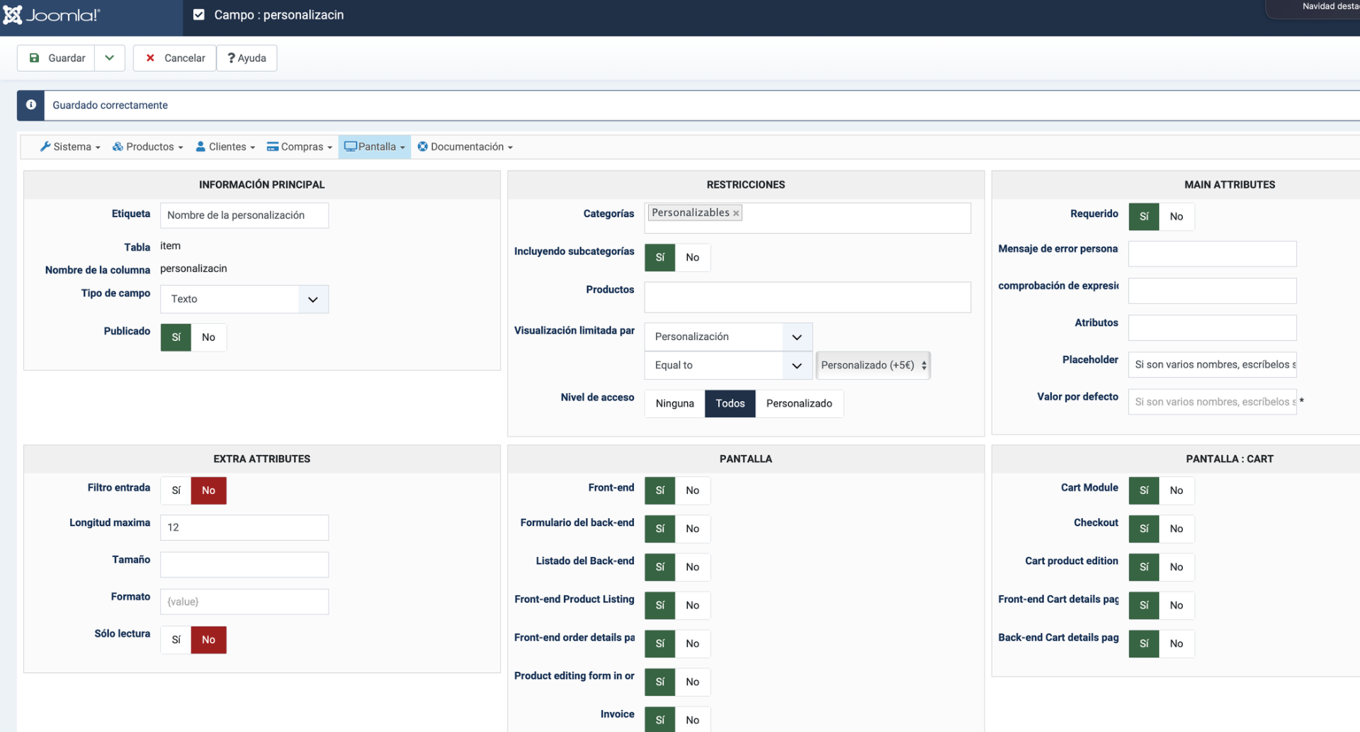

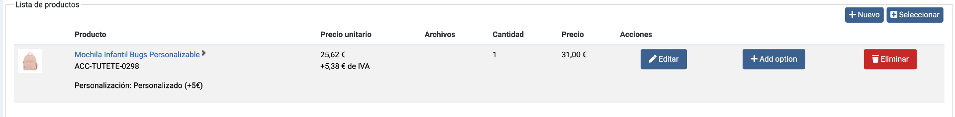

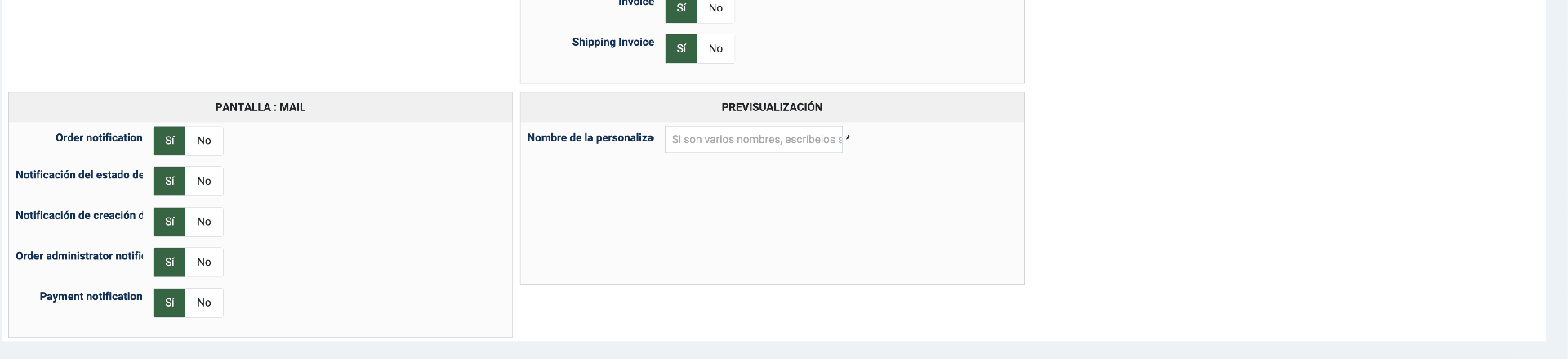

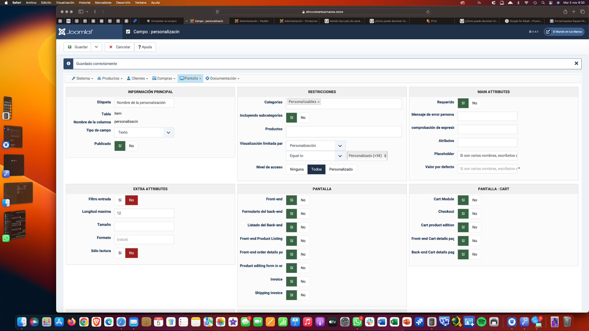

I have created a custom text field in the item column. It appears in the checkout cart, but it does not appear in the orders list or in the emails on the administration side. Attached are screenshots."

That seems like a bug.
What if you don't restrict that field to a category ? Since it's limited to the other field, it shouldn't change anything for the display but it might help with the saving when the order is created.

From what I can see the problem is this:
You had already created a custom field of the table "product" with the column name "personalizacin". You then deleted that field, and didn't click on the link to delete the "personalizacin" column from the product table in the database when deleting it.
Then, you created a new custom field of the table "item" with the exact same "personalizacin" column name.
Because of this, when converting the cart to an order, the mechanism takes the value from the product instead of the value from the cart, leading to the field value missing from the order.
To remedy that, either :
- recreate the custom item field with another column name and use the new one instead of the one you already have
- delete the column "personalizacin" column from the hikashop_product table via your PHPMyAdmin
On our end, we'll add a small patch to avoid the problem for future users.
