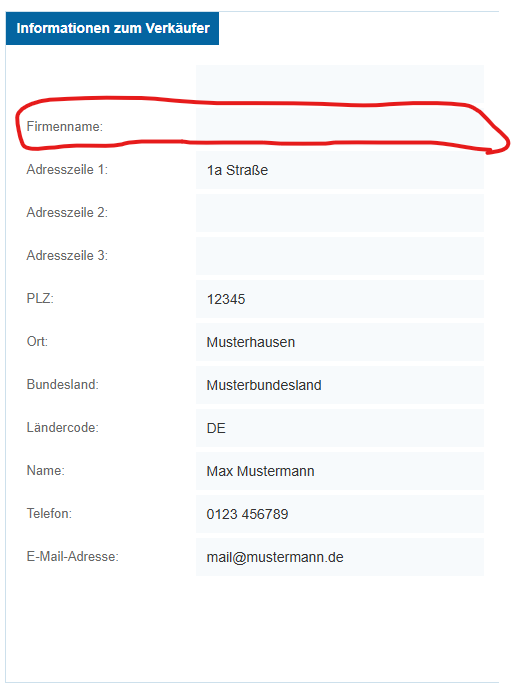

> In the upper area you'll find two sections - "information buyer (käufer)" and "information seller (verkäufer)".
In the form "information seller (verkäufer)" the value of the field "company name" is missing.

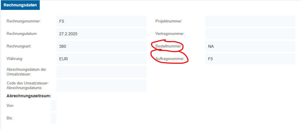

The following fields have been mixed up: [order number] (Bestellnummer) and [contract/commission(?) number] (Auftragsnummer) - I'm not sure about the naming in english. But there are two types of "order numbers" and they are mixed up. Can you fix this, please?

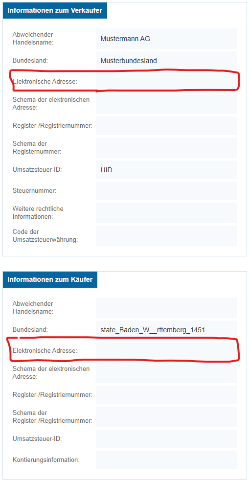

> Near the bottom of all the information on the site we find again "information of seller" and "information of buyer".
Here the following fields are empty:
- email
I hope you can understand my description and can fix it.

Regarding the company name and email missing for the supplier, please note that you have corresponding fields in the settings of the plugin that you need to fill in so that they can be present in the UBL file.
Please review the settings of the plugin. You can click on the "toggle inline help" button at the top to get to see the instructions for each field of the plugin. That might help you fill in the settings properly.

Please look at my first screenshot (hika1)! Here you find two marked numbers. This is NOT the invoice number. The invoice number (on this screenshot) is on the upper left side (first entry). In the screenshot both numbers are the same. But in many cases you want to have different number schemes. In the screenshot the - correct - sales number would be the field with the value "NA".

nicolas wrote: Regarding the company name and email missing for the supplier, please note that you have corresponding fields in the settings of the plugin that you need to fill in so that they can be present in the UBL file.
Please note, that the information are present in the ubl file. But only on one of two data fields. The problem is, that the information is partly in one data area und partly in the other. It seems ... divided. Look at screenshot 2 and 3. no 2 show the first data block - here the company name is missing - but all other data is present. screenshot no 3 shows the second data block - here is the email address missed (for seller (verkäufer) and (buyer (käufer).
