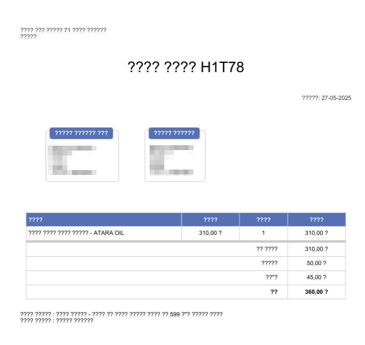

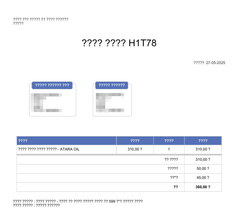

All is cool, I get invoices, but our site on hebrew language, and I get many???????????? in PDF.
I tried to change fonts - but it not help me.
Any solution please?
thank you.

The freemono / freesans / freeserif fonts seletable in the font setting of the plugin should support hebrew from what I can read here:
github.com/tecnickcom/TCPDF/blob/main/fo...font-20100919/README
Did you try any of these ?

Now it work perfect.

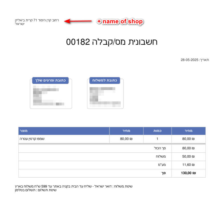

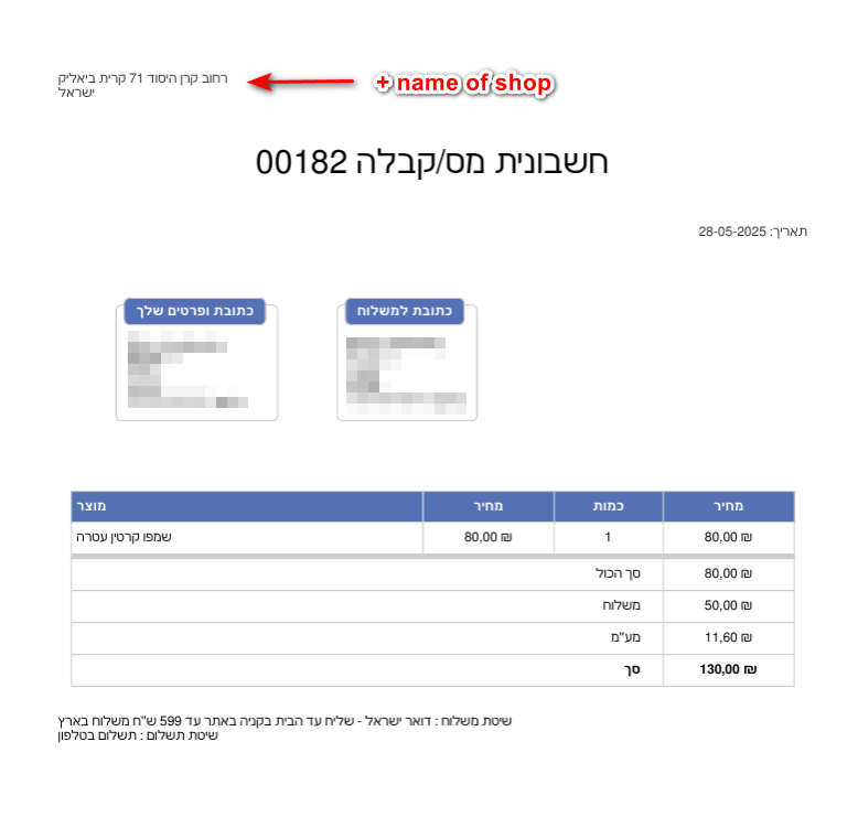

Hi, thank you.
Additional questions:
1. it must to be RTL (how to?)

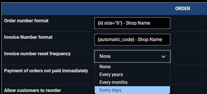

2. I need to reset number of invoice (for example now is 182 - must to reset to 001)
3. need to add name of shop
thank you for your patience

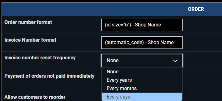

2. In Hikashop Configuration -> Main (tab) -> Order (section), you have this option: Invoice number reset frequency, set that for 1 day, create one order to reset it and after that change the setting back to None ;).

3. {id size="5"} - Shop Name , set it like this Hikashop Configuration -> Main (tab) -> Order (section)

1. I'm not sure. Based on github.com/spipu/html2pdf/issues/93 it seems that the HTML2PDF library used by the plugin to generate the PDF file added support for RTL in 2016.
Edit the file plugins/hikashop/attachinvoice/attachinvoice.php via FTP and before the line:
		$html2pdf->writeHTML($content);
add the code:
		$lang = JFactory::getLanguage();
		if($lang->isRTL())
			$html2pdf->pdf->setRTL(true);
This should tell the library to handle the RTL when the language of the website requires it.
Please let me know how it goes.

@oxido if you set the reset frequency to every day, the next day, the invoice number will indeed start at 1 again. However, if you then switch back to no reset frequency, the system will take into account the max number on all orders again and will restart where it had left at 182. So I don't think that what you recommend will work.
3. I would recommend filling the "Your logo URL" setting in the HikaShop configuration:
www.hikashop.com/support/documentation/5...onfig.html#main_main
That way, it will be added automatically to the PDF.

1. - no changes
2. - I need to ask from my client firstly.
3. Perfect
