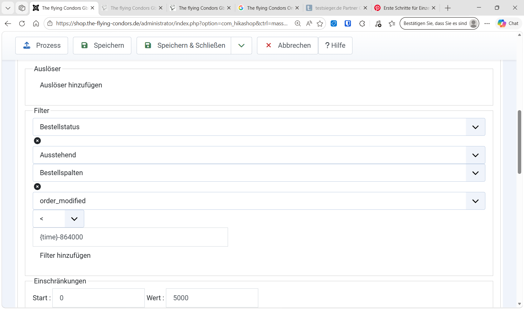

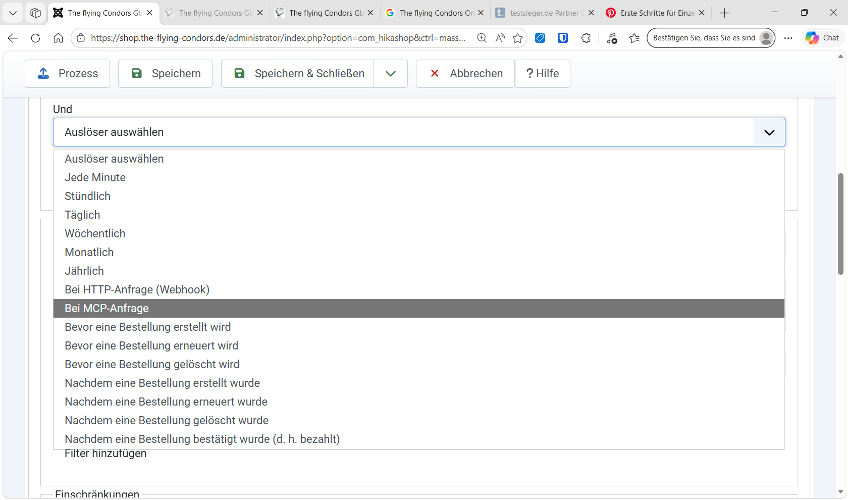

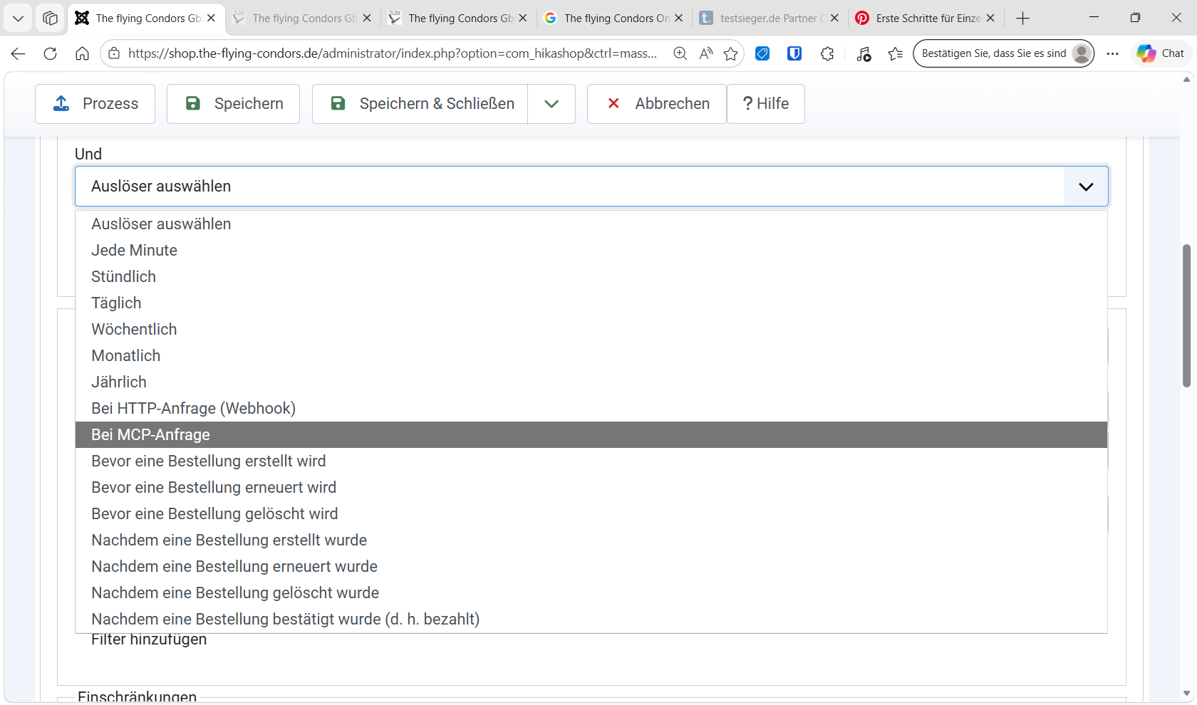

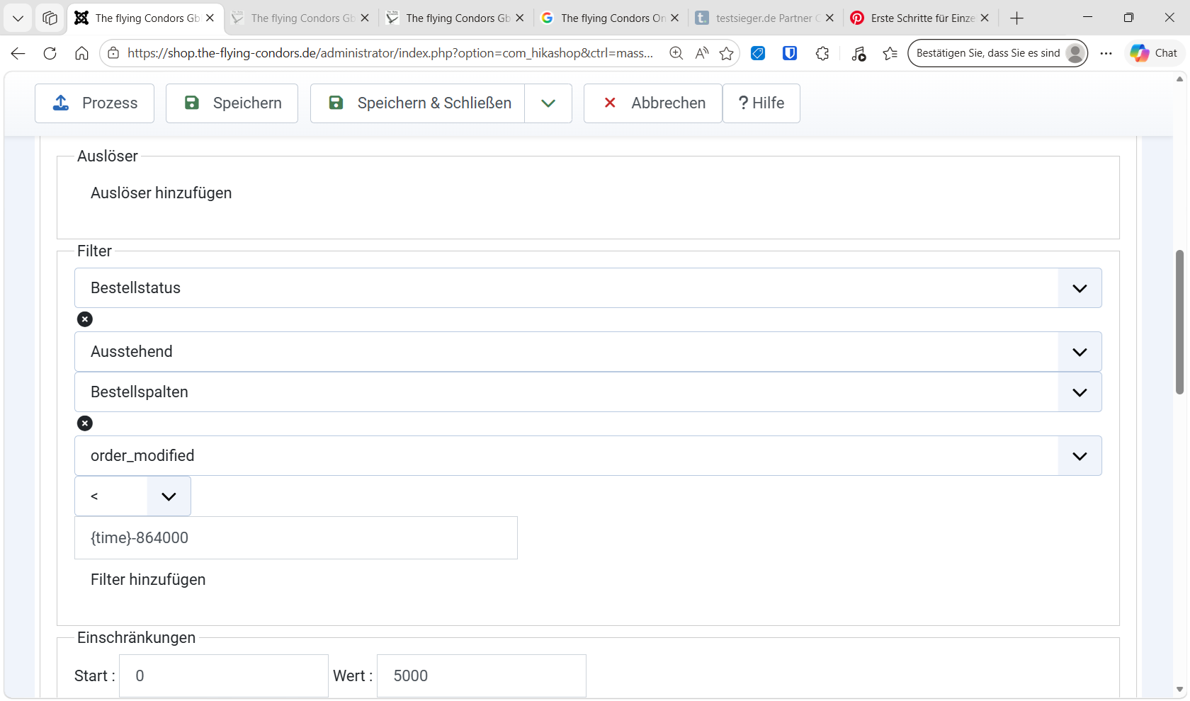

  • Posts: 28
4 months 3 weeks ago #371516
Hallo Nicolas,
ich habe noch Fragen zu der Massenaktion.
Ich finde keine passenden Trigger. Die einzigen die passen könnten sind "Bei HTTP-Anfrage (Webhook)" oder "Bei MCP-Anfrage".
Die Eingabe der Zeit macht noch Schwierigkeiten, {time}-864000 findet keine Bestellungen, '{time}-864000' führt beim Ausführen zur Fehlermeldung "Unsupported operand types: string - string". woran kann das liegen? Wie muss es richtig heißen?
Viele Grüße - Harald
Last edit: 4 months 3 weeks ago by haraldundandrea.

Hi Harald,
Regarding your questions:
1. Trigger
"On MCP request" and "On HTTP request (Webhook)" are not the right triggers for your case - they are called by external systems (AI/chatbot for MCP, manual HTTP calls for the webhook) and don't run automatically at regular intervals.
For a recurring task you need a time-based trigger like Hourly or Daily. These work via the HikaShop CRON URL: HikaShop provides a specific URL that needs to be called regularly so that time-based massactions and HikaShop plugins with a CRON trigger actually run. The URL and the details are in our documentation:
www.hikashop.com/support/documentation/5...n-configuration.html
Without such a regular call (via a server CRON on Linux, the Task Scheduler on Windows, or an external service like cron-job.org), the time-based triggers won't fire, even though they appear in the dropdown.
2. Filter finds no orders
The value {time}-864000 should work: {time} is replaced by the current Unix timestamp when the action runs, and the subtraction is then computed, so you get a timestamp from 10 days ago. If the massaction still doesn't find any orders, it's usually not the syntax but one of the following:
- There are simply no orders older than 10 days that also have the "Pending" status. First test with a shorter period like {time}-86400 (1 day), or without the time filter at all, to see if the status filter returns any hits on its own.
- "Pending" may not be the status your unpaid orders actually have. Depending on the payment method, unpaid orders are often created with the "Created" status rather than "Pending". Check the actual status of your old unpaid orders in the backend under "Orders" and adjust the filter accordingly.

  • Posts: 28
4 months 3 weeks ago #371533
Hello Nicolas,
it has been my fault. I had forgotten to add some fields which should be displayed.
Now I have copied my older massaction to display pending orders and added the new filter and the trigger daily. The range I have set from 0 to 1000.
I have processed the massaction manually and got a list up to 10th of march.
After that I copied this massaction and changed the aktion to "delete the elements" and got the desired result.
With the massaction for displaying pending orders I still see now some orders from 11th of march up to now but older than 10 days.
I think this massaction should delete the next orders by itself tomorrow.
Thank you very much for your support and explenations.
I will set up the new version of the plugin aswell.
Greetings - Harald
P.S.: Now all wors/is fine, only real orders are left...
