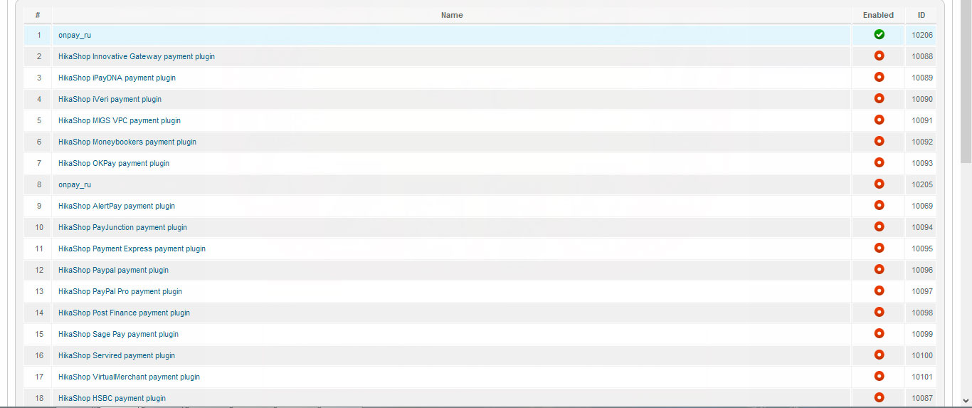

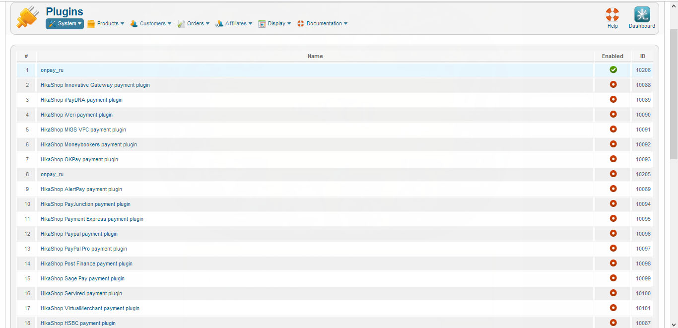

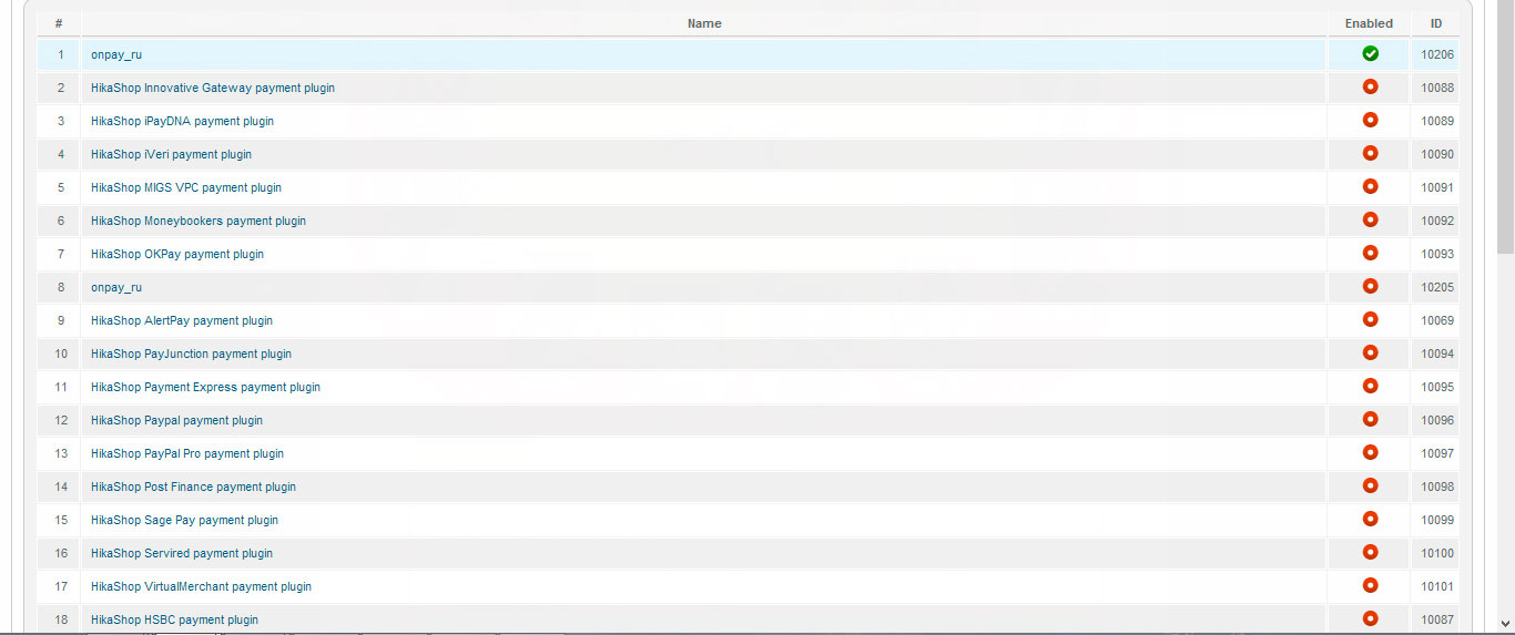

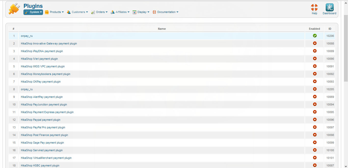

1) created a folder /plugins/ hikashoppayment /onpay_ru /
2) built there files index.html, onpay_ru.php, onpay_ru.xml, onpay_ru_configuration.php, onpay_ru_end.php.
3) installed the plugin through the Extension Manager: Distsover,
4) in the hikashop Payment methods eating this method and I published it
But the site did not show the same module.

I don't think that the issue comes from the xml of the plugin. At least it looks fine to me.

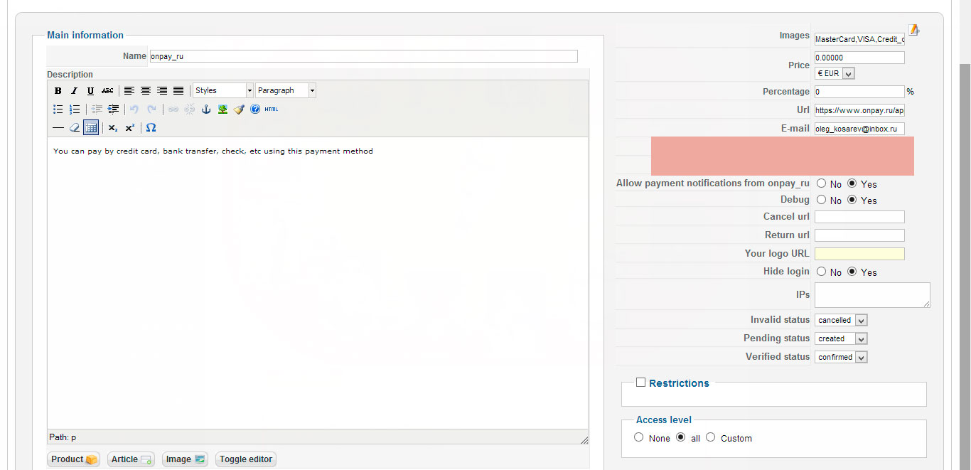

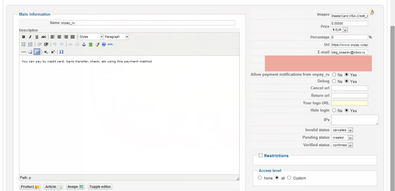

On www.hikashop.com/media/kunena/attachments/25919/hffd3975.jpg I see that the plugin is listed in the list of the payment plugins installed. Did you also create a new payment method instance of the plugin via the menu System>Payment methods ?
If so, could you do a screenshot of the options of the payment method (you can hide the sensitive data) ?
  • Posts: 8
12 years 11 months ago #116800
nicolas wrote: I don't think that the issue comes from the xml of the plugin. At least it looks fine to me.
When I open the page /administrator/index.php?option=com_hikashop&ctrl=plugins&plugin_type=paymen at me there no konpki a payment .... this page is the path that you specified.
Maybe that is where you add a new user of your payment into the system?
If you feel it necessary to judge me by my past, do not be surprised if I deem it necessary to leave you there.

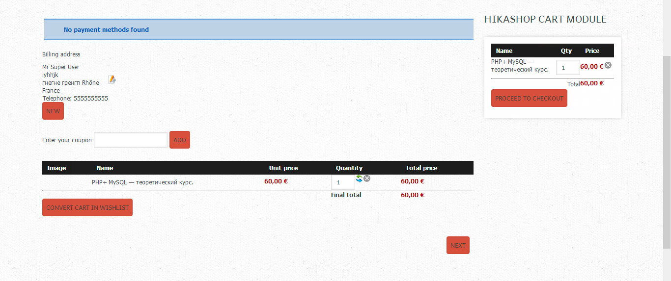

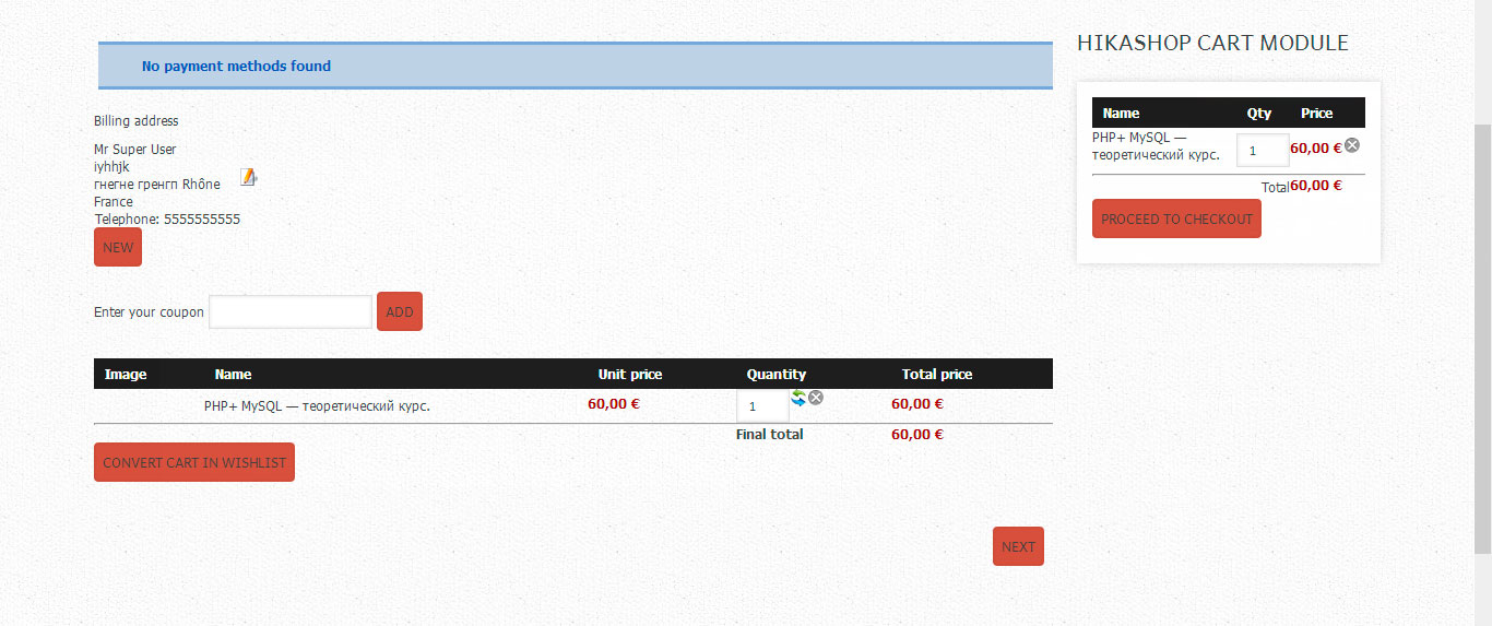

  • Posts: 8
12 years 11 months ago #117563
I Install new joomla clone and hikashop plugins installed successful enable this plugin a pay method but front end dont pay method and write "No payment methods found"! Thanks for help.
