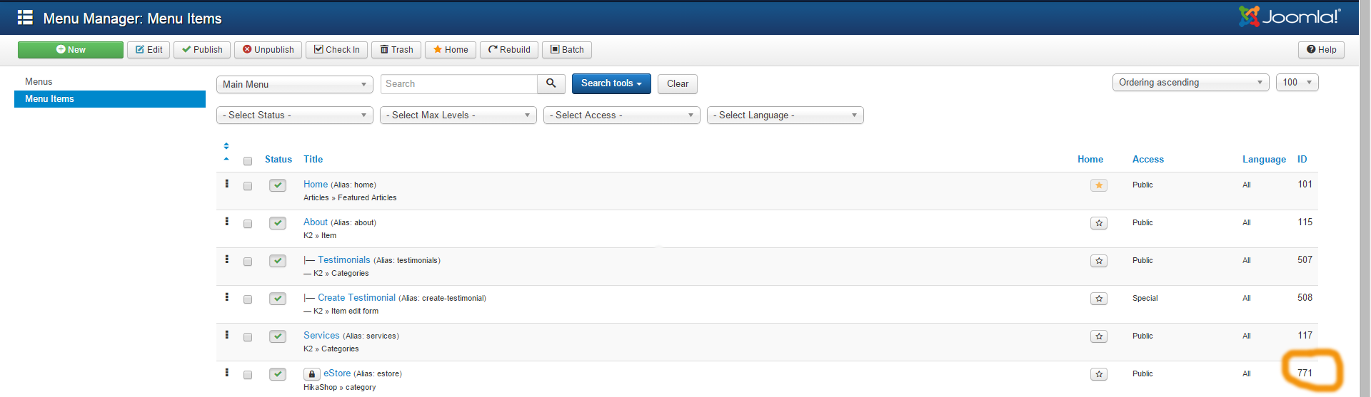

I also checked my menu entry id for hikashop and it is 771 but when i click on checkout it shows me
http://websitename.com/component/hikashop/checkout?Itemid=721

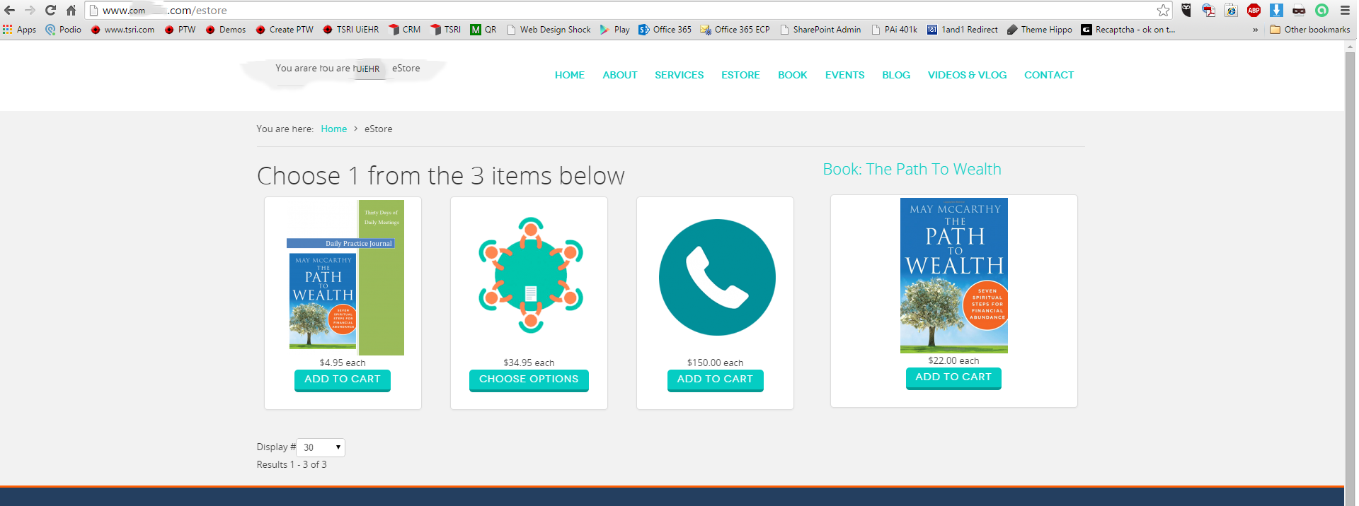

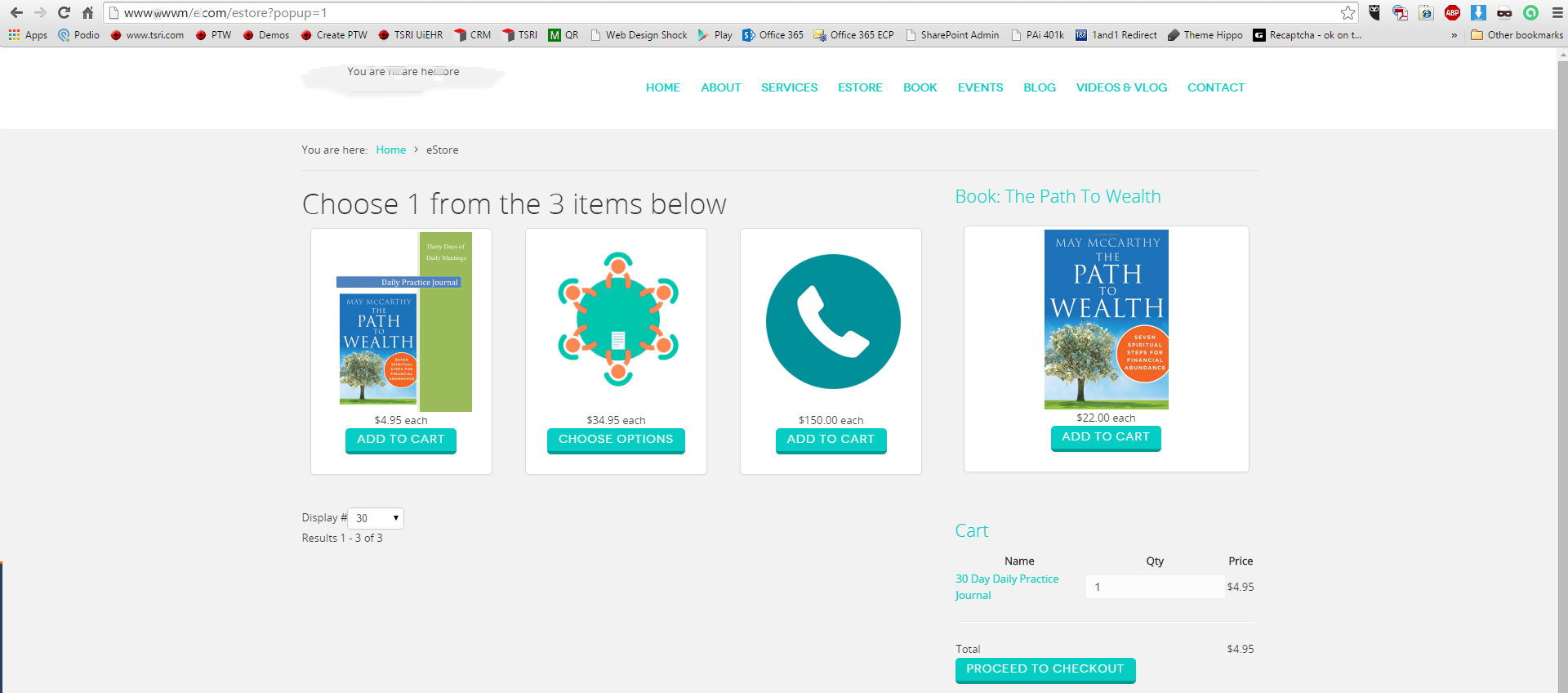

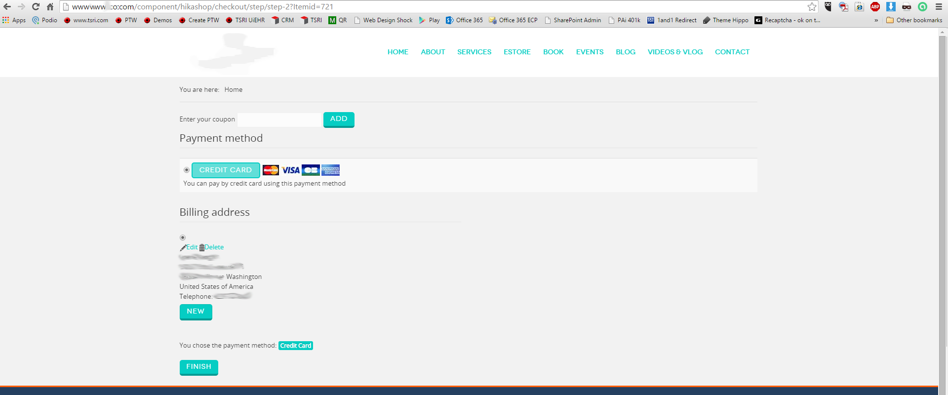

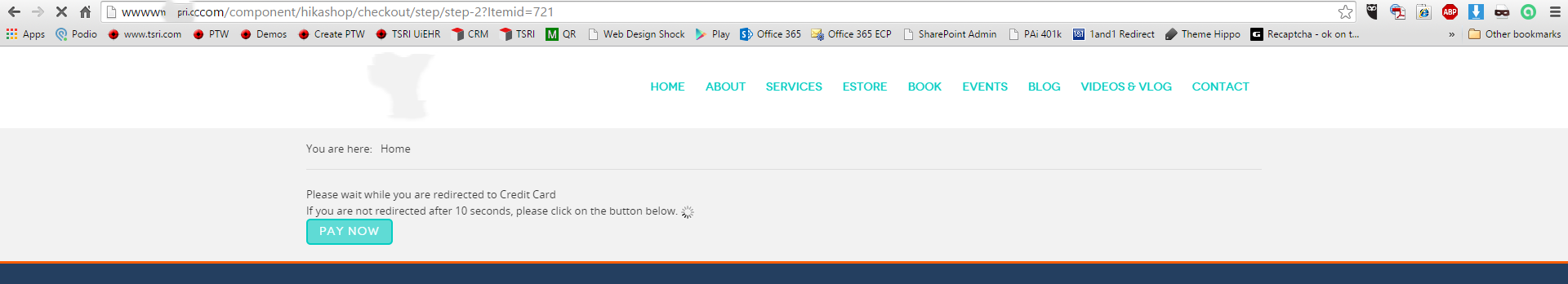

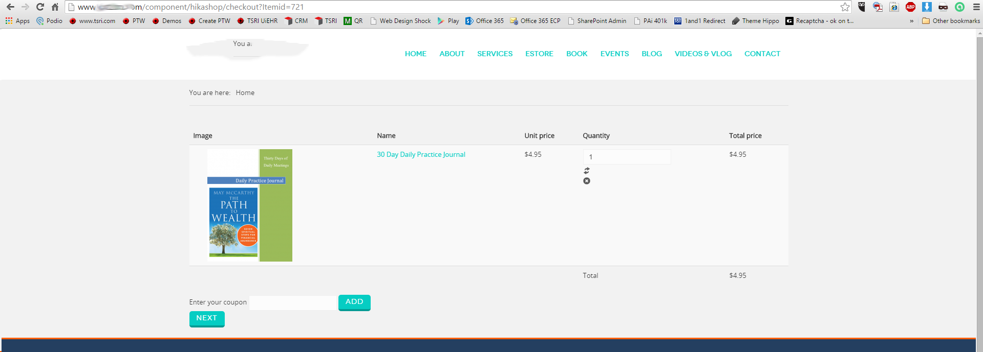

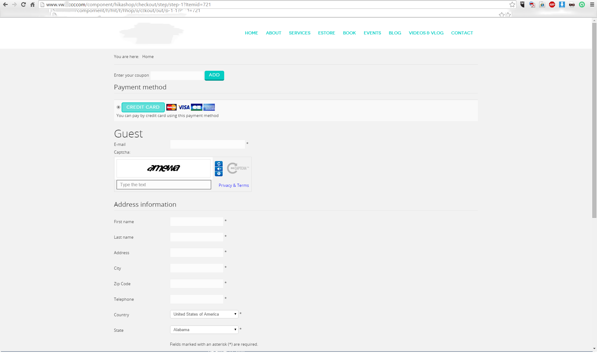

  • Posts: 31

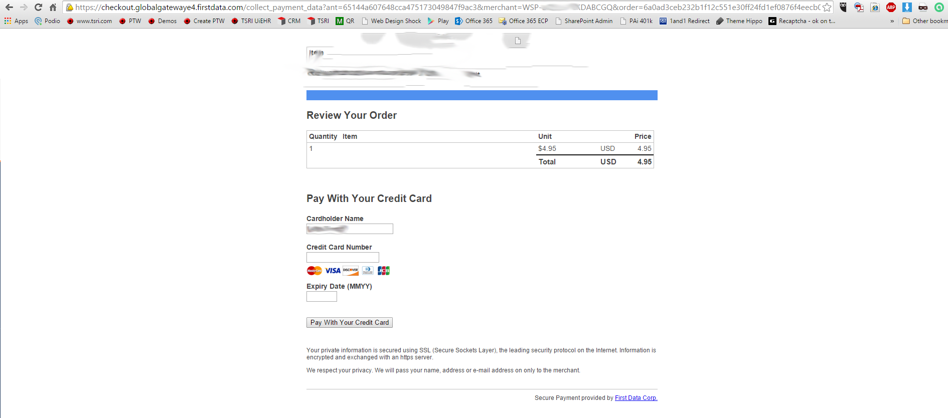

11 years 6 months ago #194372
Here is what it looks like when I buy something at my store:

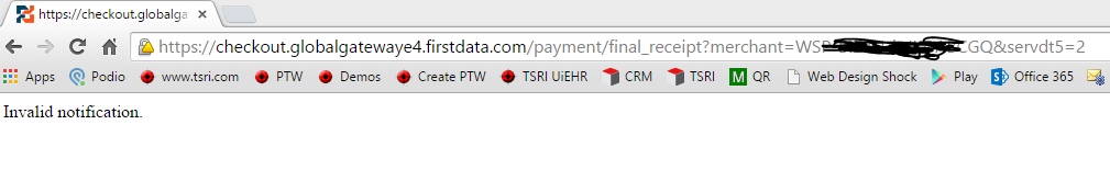

  • Posts: 31

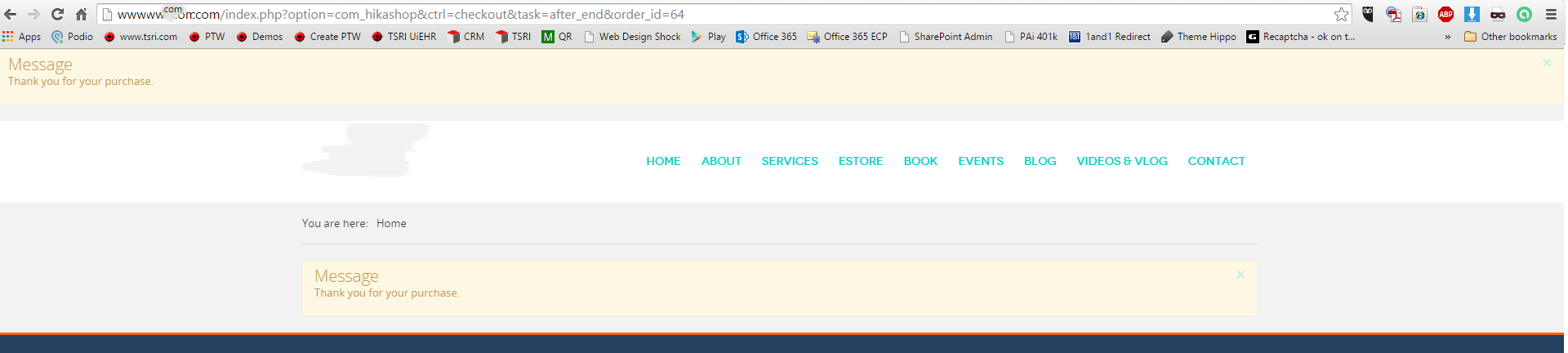

11 years 6 months ago #194374
After I click on the link, I get redirected back to the regular thank you page.

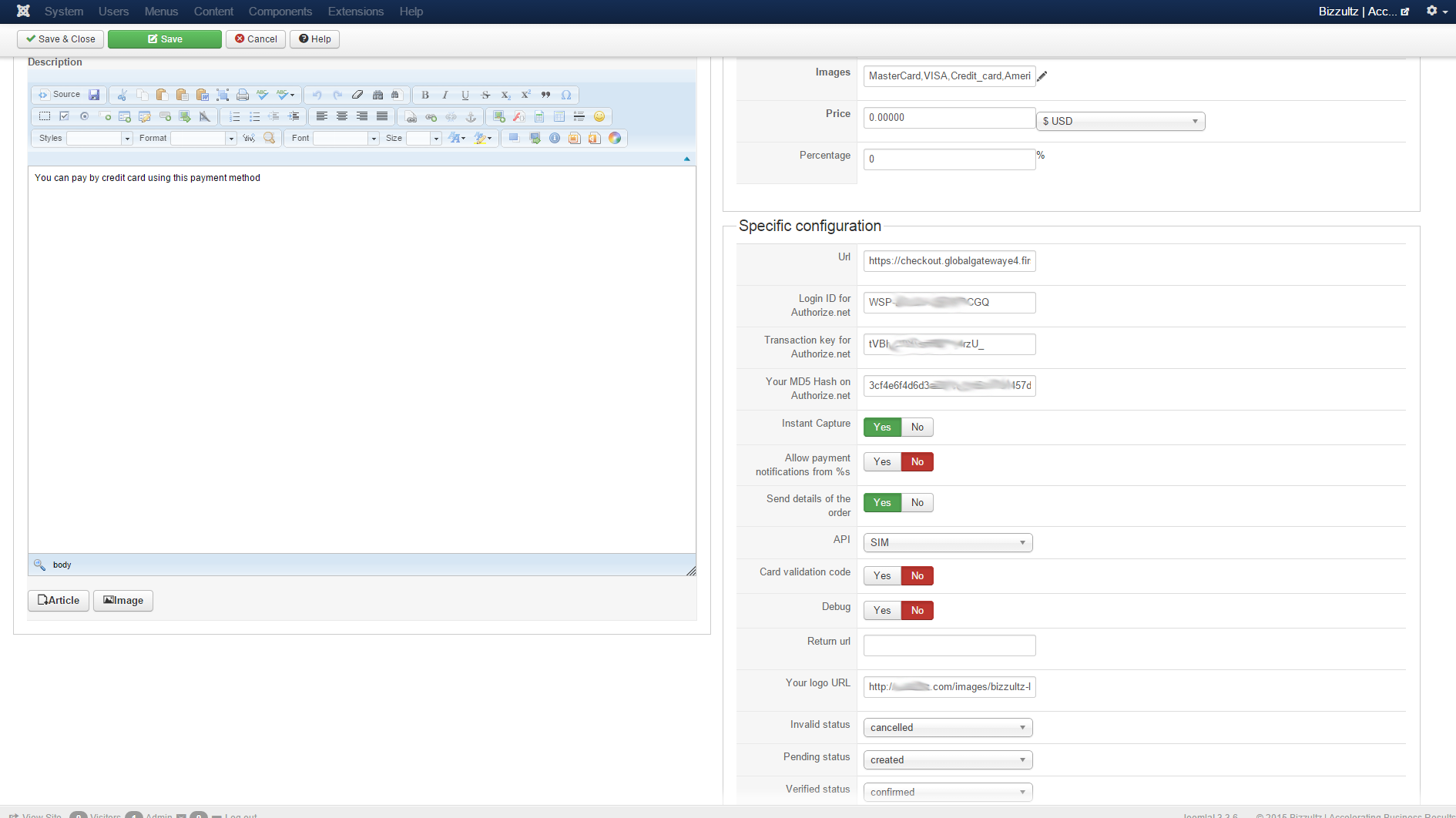

Here is a view of my plugin, with %s set to no.

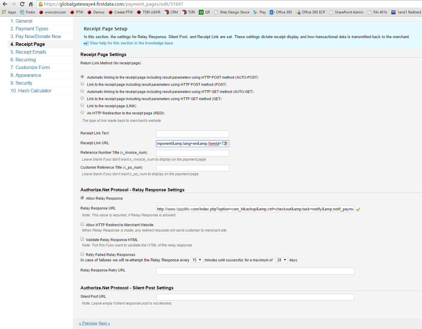

This is the payment settings pag ein FirstData

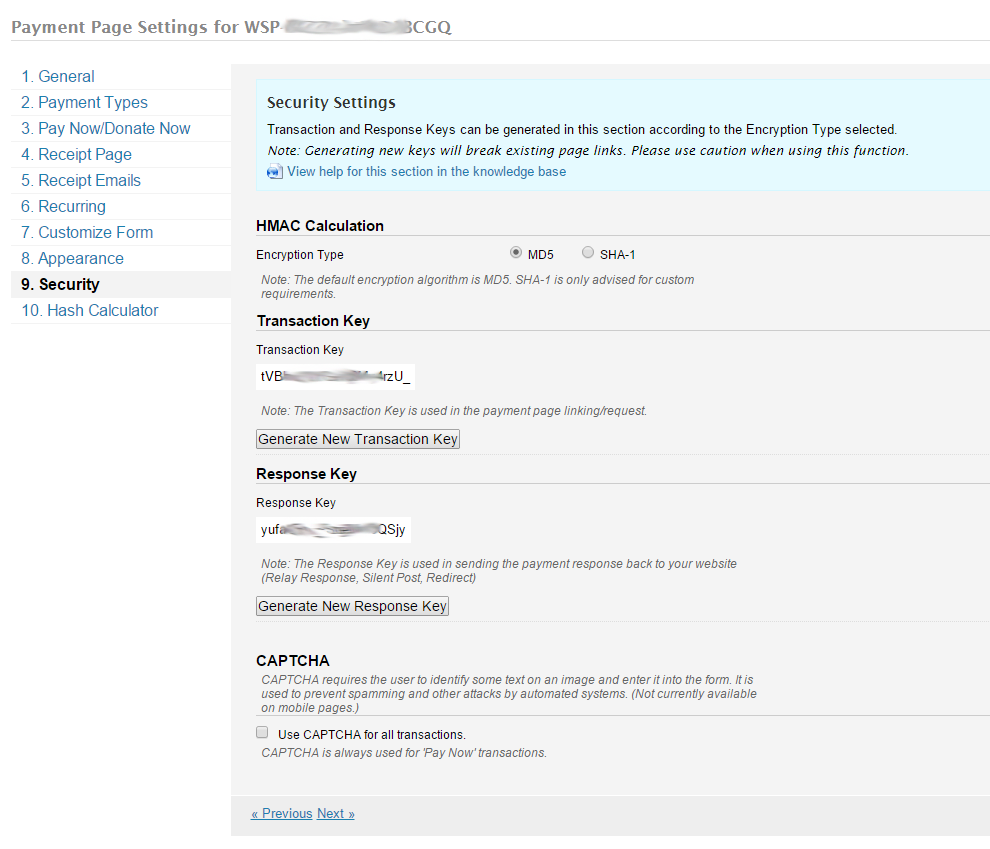

This is the security page in FirstData

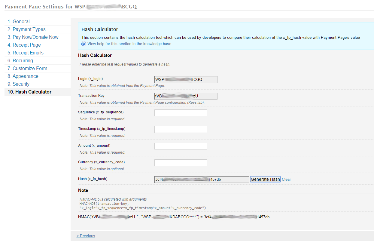

This is the Hash Page in FirstData
Please note the response and relay URL are the same with the item id 721
here is the joomla menu manager with eStore being the store item

  • Posts: 31
11 years 5 months ago #195070
I just received a hikashop error:
An Authorize.net notification was refused because the response from the Authorize.net server was invalid. The hash received was 2c29xxxxxxxxxxxxxxxxxxxx8fc2 while the calculated hash was 662FCxxxxxxxxxxxxxxxxxxxxxxx36A42. Please cehck that you're set the same md5 hash key in Authorize.net and the plugin
But the hash it shows in first data is this one: 3cf4e6f4dxxxxxxxxxxxxxxxxx1457db
Which is also the one I have in the payment plugin...

11 years 5 months ago #196796
wldworks: Yeah, I hat that problem with the hashes not matching too during my original testing/setup last year.
Actually I think I see what you might have done wrong. You used the Firstdata Hash Caculator to generate the "Your MD5 Hash on Authorize.net". That is NOT correct.
That is just a test calculation for debugging. You would manually enter the price, etc. and it would generate a value that you could then compare to what Hikashop generated. You don't need to do that at all.
The value you should enter into HikaShop Authorize.net plugin's "Your MD5 Hash on Authorize.net" is under FirstData's Payment Page's #9 Security -> Response Key. It is just below the Transaction Key.
That was one thing I had in my write notes as the key discovery. I made that same mistake last year when I was doing my original setup. The labeling is what is confusing (neither side matches the others) and I discovered it via trial and error and a hunch.
