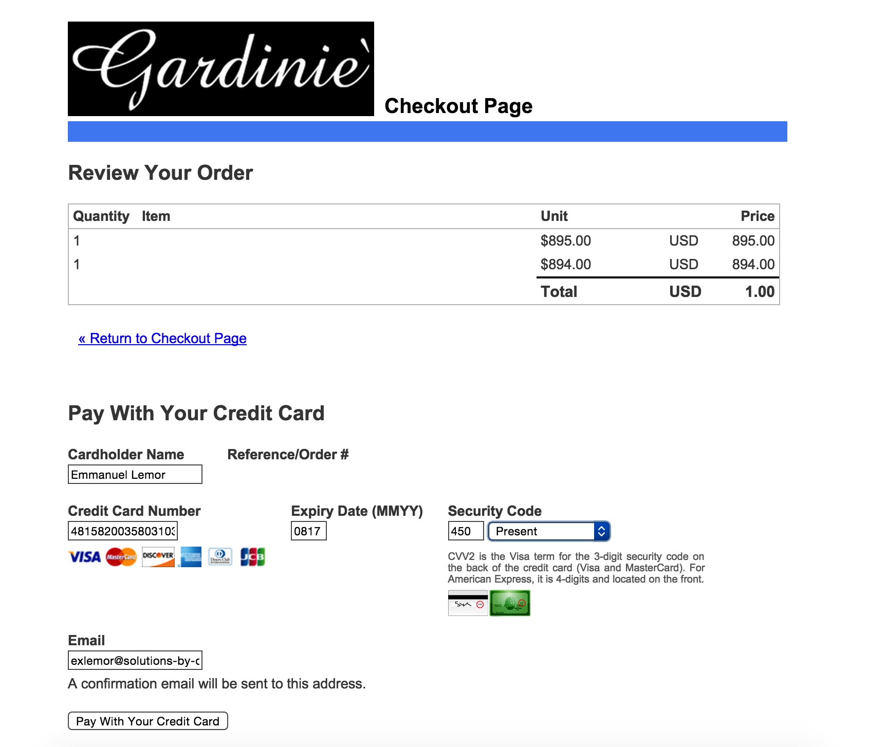

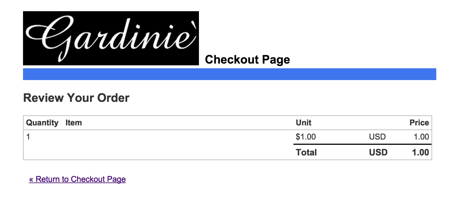

10 years 11 months ago #210725
HI Jazzmang,
You rock, I took YOUR file and it now confirms orders the ONLY thing left it seems/that still isn't working is:
the Item Description is not going across to Payeezy with Send Details of the Order ?
As you can see in the image attached...
Any clues/thoughts?
  • Posts: 291
  • Thank you received: 26
  • Hikamarket Multivendor Hikashop Business Hikashop Essential
10 years 11 months ago #210727
That is normal.
I'm not aware of any option for it to display cart items on their end. It is strictly quantity and $ totals.

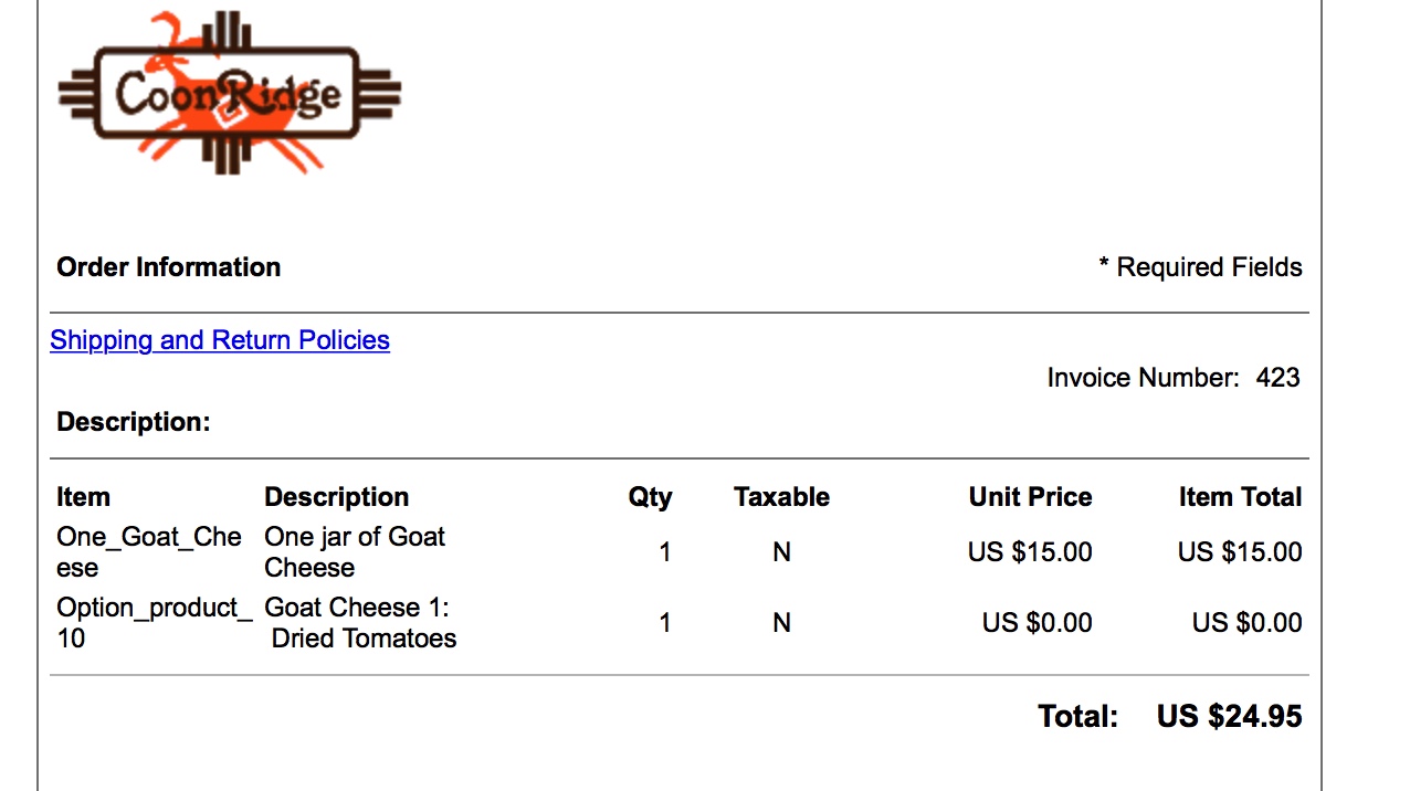

10 years 11 months ago #210728
Hi Jazzmang,
Thanks for the input but then why does using the 'normal - non-edited' Authorize.net plugin on a different website with Authorize.net ----> the item descriptions work fine..
See thumbnail attached.
Cheers,
Emmanuel.
