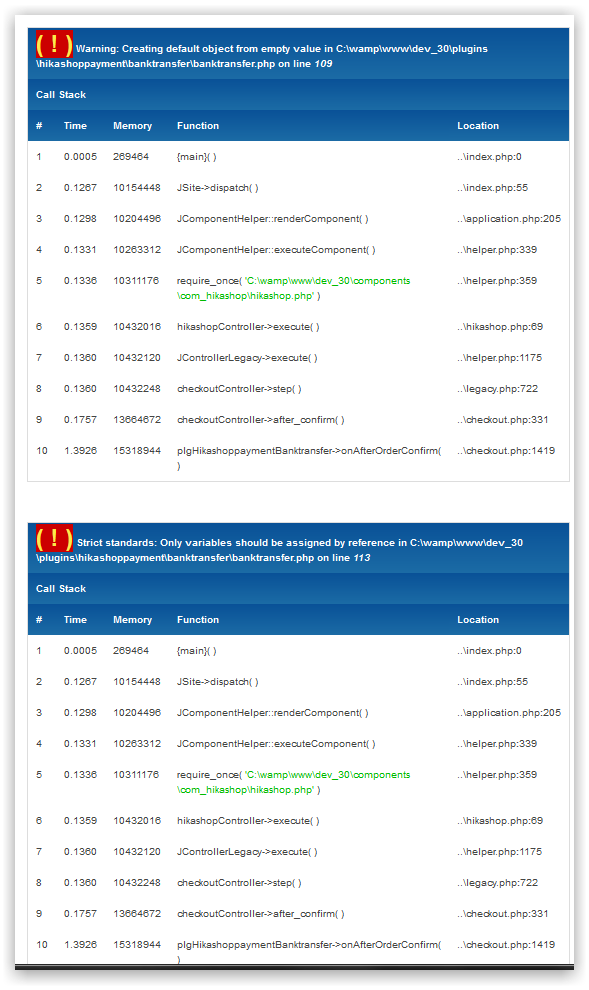

I'm using HikaShop 2.0.0 and I have the attached warnings when using the bank transfer payment method...

Hi Adrien,
Thanks for the report of the warning message on the "bank transfert" plugin for HikaShop 2.0.0
The fact is that we rewrite all payment and shipping plugins in HikaShop 2.2.0 and fix made a big pass on the PHP5.4 warnings.
If you update HikaShop with the latest build, you would no longer have this message.
But if you don't want to upgrade HikaShop, just send a message to your webmaster and he will modify the files directly in order to remove these warnings.
