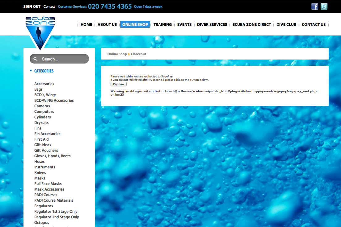

-- url of the page with the problem -- : www.scuba-zone.co.uk
-- HikaShop version -- :2.2.1
-- Joomla version -- : 2.5.14
-- PHP version -- : 5.3.16
-- Error-message(debug-mod must be tuned on) -- : doenst stay on page long enough to see
Morning

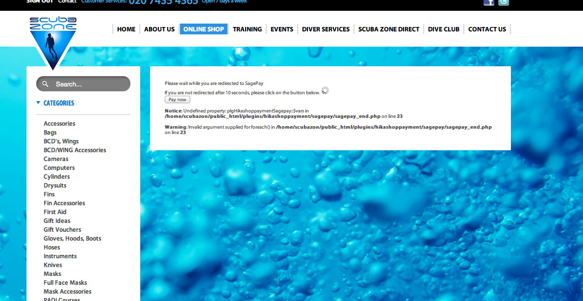

I have just recently started having an issue wit the Sagepay plugin, I think since updating to 2.2.1
Basically when you click 'next' from the cart with Sagepay selected as the payment type, the page refreshes to www.scuba-zone.co.uk/online-shop/checkou...out/task-step/step-1 , which flashes up some error (see attachment), and thens just dip lays "Thank you for your purchase.", but doesnt actually go to the Sage pay payment site.
First attachment is with joomla system debug off, and second is with joomla debug on.
Thanks in advance for your help.
Don
  • Posts: 26378
12 years 10 months ago #121903
Please edit the file "plugins/hikashoppayment/sagepay/sagepay.php" and replace
		$vars = array(
			'navigate' => '',
			'VPSProtocol' => '2.23',
			'TxType' => 'PAYMENT',
By:
		$this->vars = array(
			'navigate' => '',
It will solve the problem.
We will update the HikaShop package with this fix as soon as possible.
