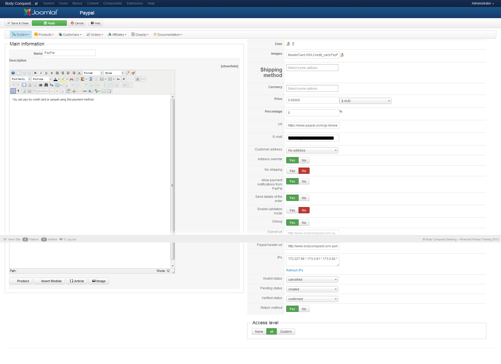

I have attached a screenshot of the plugins config. But I don't think I have missed anything.

12 years 11 months ago #126181
Like it's said in the documentation :
What to do next if you still can't get your payment notifications ?
That's where it gets difficult. You need to turn on the debug option of your payment plugin and process a new order. Then, look at your payment log file in the Files tab of the configuration. There will be written the traces of what happened when the payment plugin was triggered.
If the file is empty, it means that something blocked the notification before it reached HikaShop and we won't be able to help much as it's probably one of the points above.
If the file is not empty, it should give valuable information on what is happening. Like when it stops, what the data received for the notification, does it stop at the security check etc
