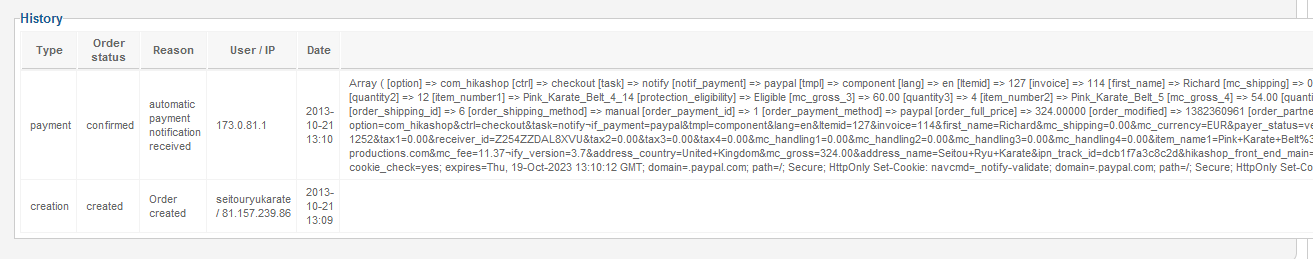

But no detail is displayed in the log of the "created" order, even with Debug mode turned on. I can see the response when I get one from Paypal and there is a lot of detail there. (screen print attached)
Never mind, the Paypal error is resolved, but I do think there should maybe be more detail in the log so that future issues can be analysed better and more information given to external parties about what Hikashop is sending them. I have no issue with the functionality of Hikashop, it works great for me, but when other parties have issues they always want to know more detail about what they are receiving to help them solve the problem.

12 years 11 months ago #128967
In case of communication between HikaShop and the API, the log can be found via Configuration > Main > Files > Payment log file > See the report, else as you have on your screenshot, in the order details.
