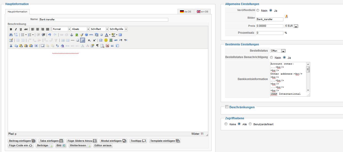

  • Posts: 29
12 years 10 months ago #129888
Dear Mohamed,
i have only the banktransfer method published. It is configured with the bank account data.
In the shop frontend, is these method not shown! What could have an influence of showing the payment methods?
  • Posts: 86178
  • Thank you received: 14214
12 years 10 months ago #129902
Xavier gave you a link to the FAQ which lists all the things which could have an influence on that.
So the answer lies in there.
Please provide a screenshot of the options of your payment method so that we can check it if you can't find the issue yourself.

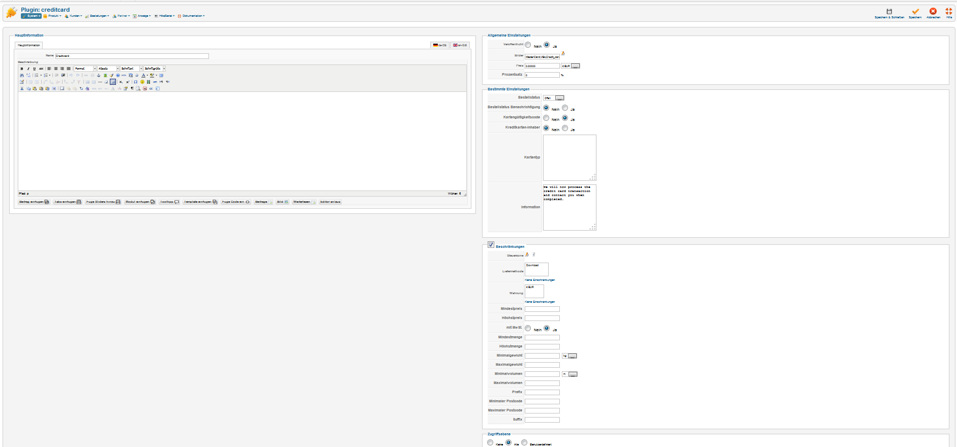

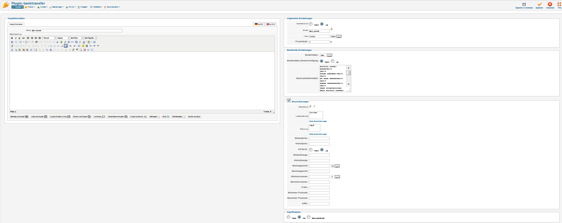

  • Posts: 29
12 years 10 months ago #129911
2 Screenshots attached
Last edit: 12 years 10 months ago by mkaker.

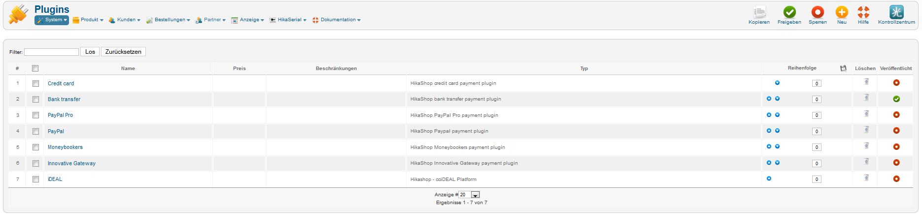

  • Posts: 26386
  • Thank you received: 4078
12 years 10 months ago #130012
I really don't think that your problem is the same than "meet_amith" who create this topic.
1/ You didn't provide useful information, like : your website url, your HikaShop version.
2/ I don't understand clearly you problem
but when i edit an payment method during test an order process, then the payment methods are shown, but no button to process the order.
I am sorry but it does not have any sense.
3/ Please provide a screenshot of your checkout workflow and a screenshot of your problem, if you can't formalized it with works, a picture will help us to help you.

  • Posts: 29
12 years 10 months ago #130444
Dear Jerome,
sorry for my bad englisch skills.... but the problem is the same. I have configured the Bank transfer as Payment Method, i have an Product in the shop and an registered user starts an order - for the order process see the screenshot.
In the Order process is only the delivery method available, and the the Payment Method is not shown. Then i had the idea to double check my payment options in an second browser window - i go to the hikashop in the joomla backend and edit the payment method. After saving the edited payment method i update the first browse window with my shop and the payment method is shown?!

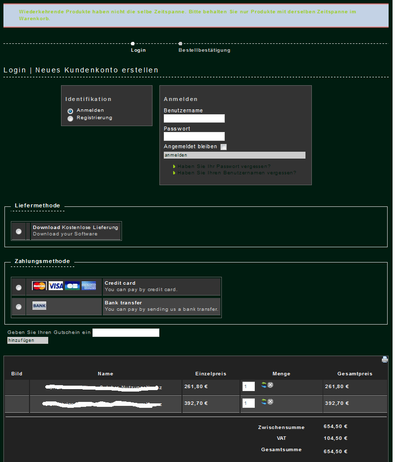

  • Posts: 29
12 years 10 months ago #132177
Dear Mohamed,
i have worked it out like you describe in your support site ( www.hikashop.com/support/faq.html#paym )
no good results, so i have remove all payment methods and set up three new methods and tree test products.
Now it is more confusing for me

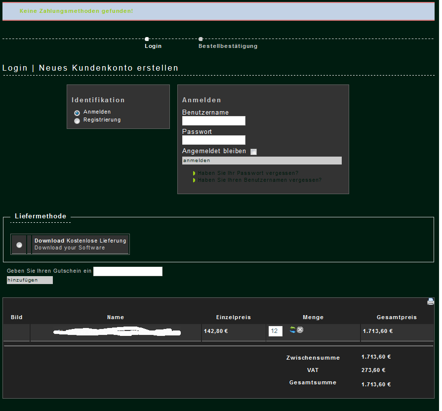

- when i add only one product (witch is an software subscription packet) to the cart, the No Payment Method messages occurres (Screen 1)
- when i add two different products (two different subscription packets) to the cart, the configured payment methods are shown like i expect it (screen 2)
both subscriptions are akeeba subscriptions ...
how can i fix it?

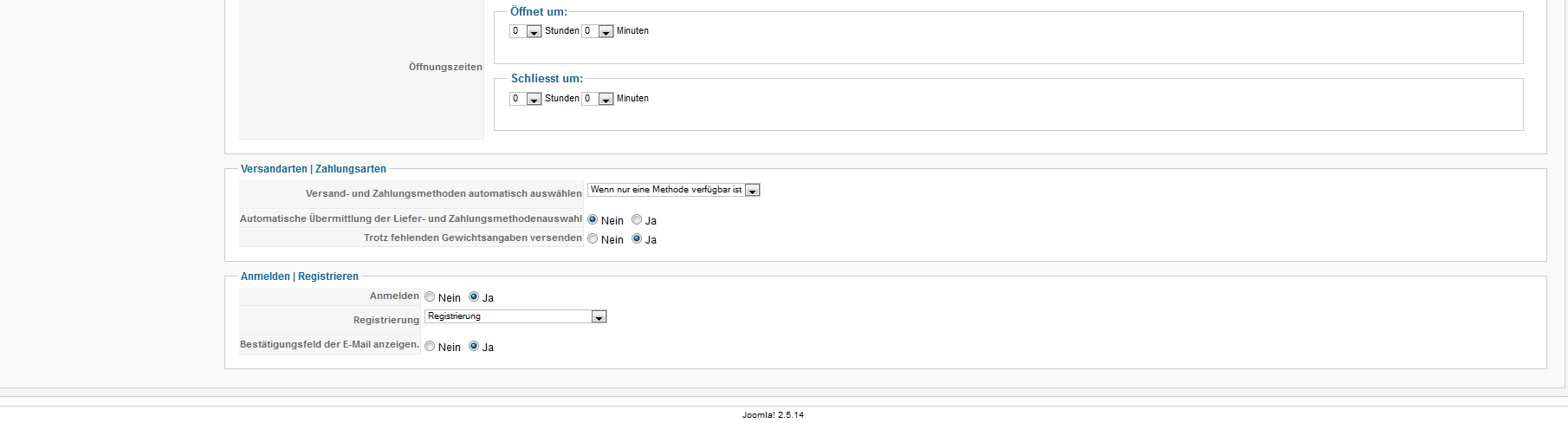

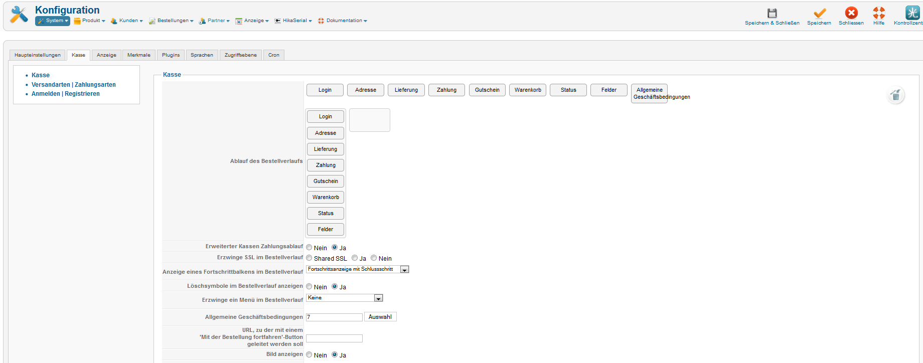

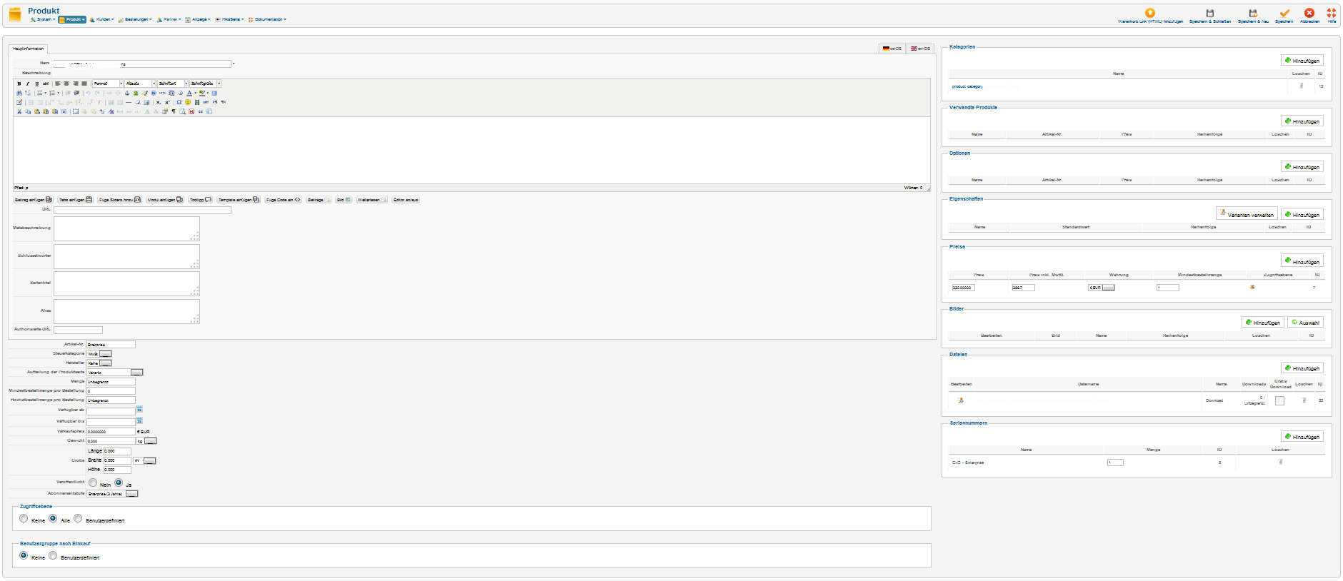

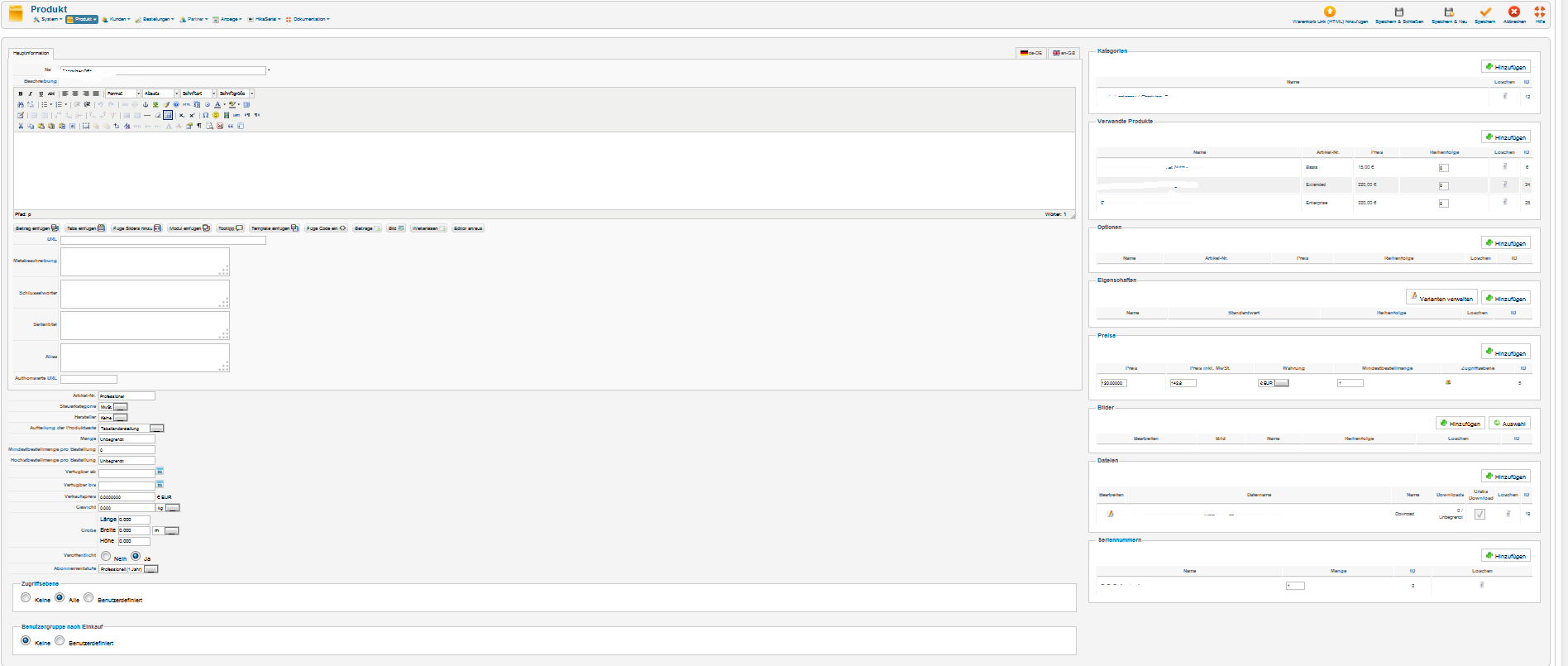

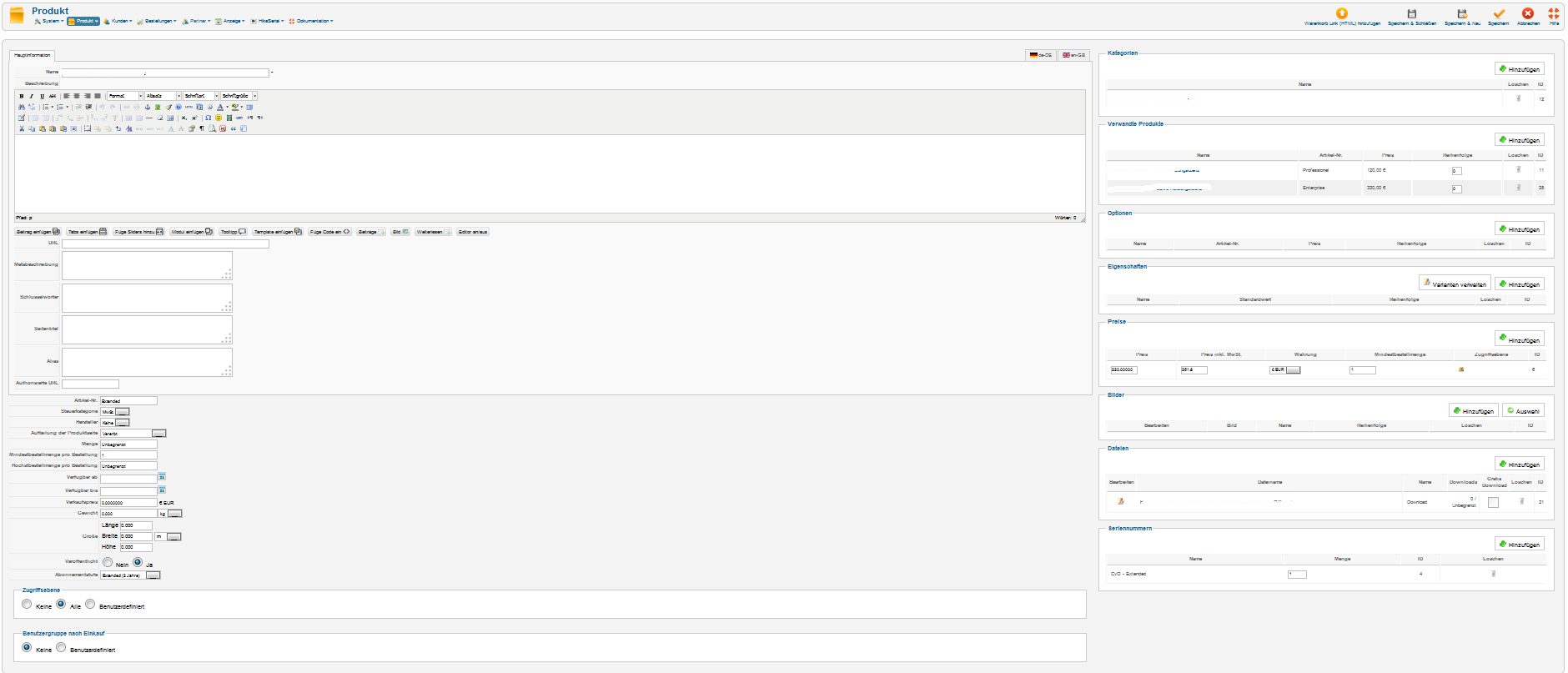

12 years 10 months ago #132191
So can you show me how did you configured :
- Your two payment methods restrictions
- Your 2 products
- Your checkout workflow ("Hikashop->System->Configuration->Checkout")
through some screenshots
  • Posts: 29
12 years 10 months ago #132237
Please see the screenshots
